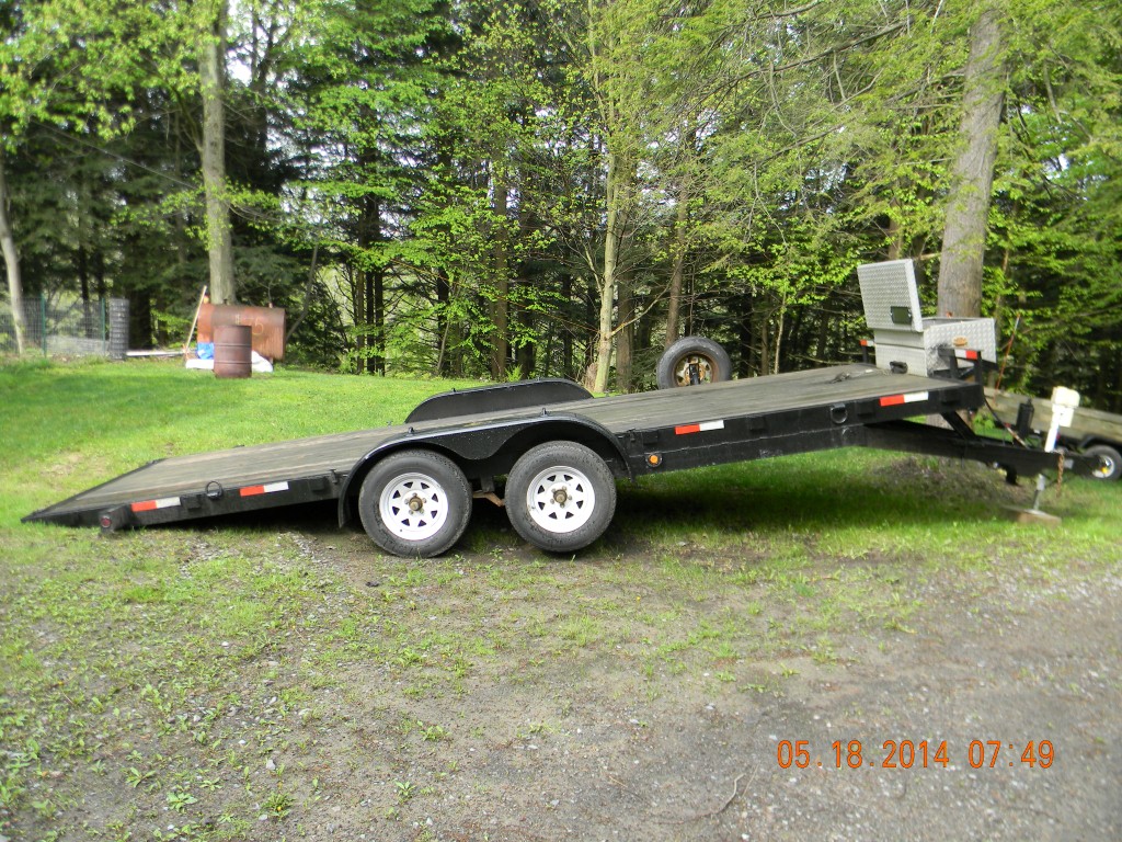

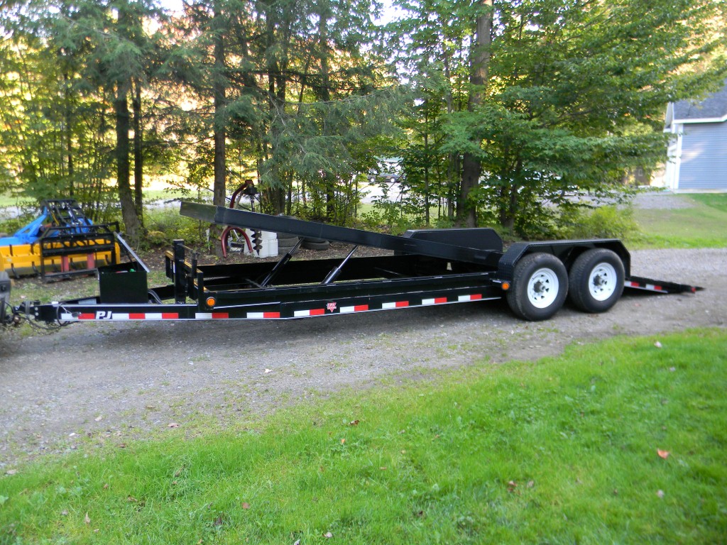

As long as only the bed tilts a WD hitch can be used. I currently have a PJ 14K tilt bed and can use a WD hitch since the pivot point is just behind the rear axle and only the bed tilts. On my previous tilt bed trailer the pivot point was in front of the axles and when tilted the back of the tongue would raise which puts way too much pressure on the hitch.
I've added a couple pics to better explain. With my PJ the frame stays level, the other trailer pic shows the back of the tongue raises when tilted. If the tongue frame stays level you can use a WD hitch.

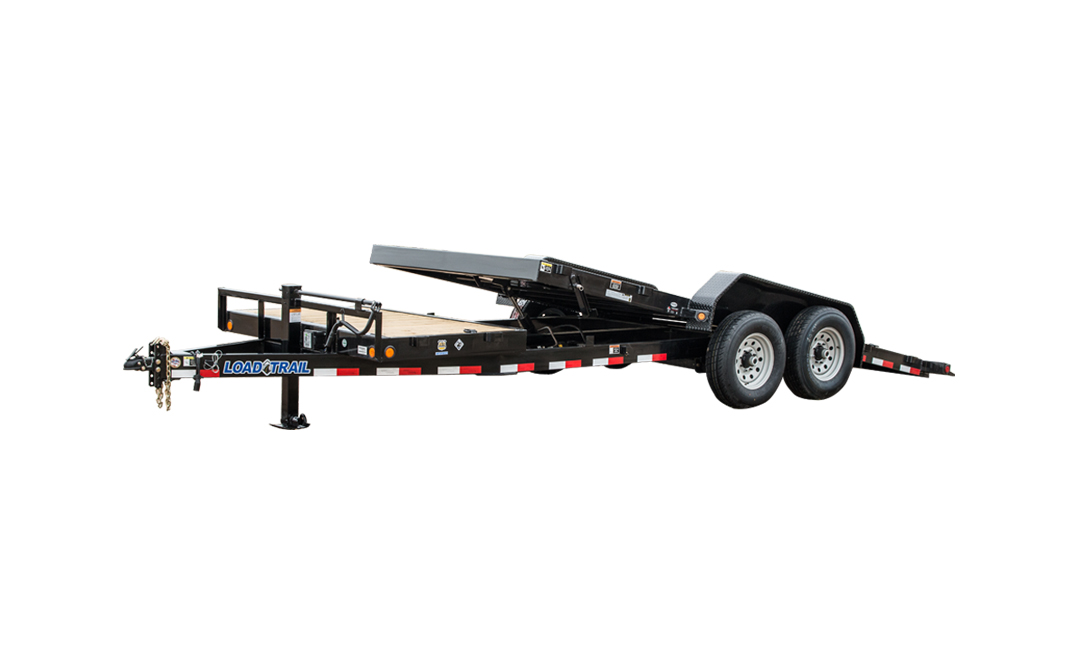

I believe it is deck over frame. Here is a picture of one. It would suck to order a WDH and find it doesn't fit.

For some reason my 10K bumper pull trailer pulls great without WDH but my 7000 lb travel trailer likes the WDH and feels funny without it. If I were pulling your load on the same road, I would just have at it. Would not have any concerns and I have a 1999 7.3 Ford 3/4 ton with much less tow capacity (according to the sticker) than your Chevy. Take it easy and crank the brake controller up. I'd rather replace brakes on the trailer than the front bumper on the truck - or worse.
On the borrowed trailer thing... Make sure the bearings are greased and that the tires are un-damaged and fully inflated. Check bearing and tire temperature at each stop - just like you probably do with your travel trailer. Any sign of problems - check it out more thoroughly. Good luck.
If your hitch frame tilts when the bed is tilted, couldn't you disconnect the WDH when load and unloading?
