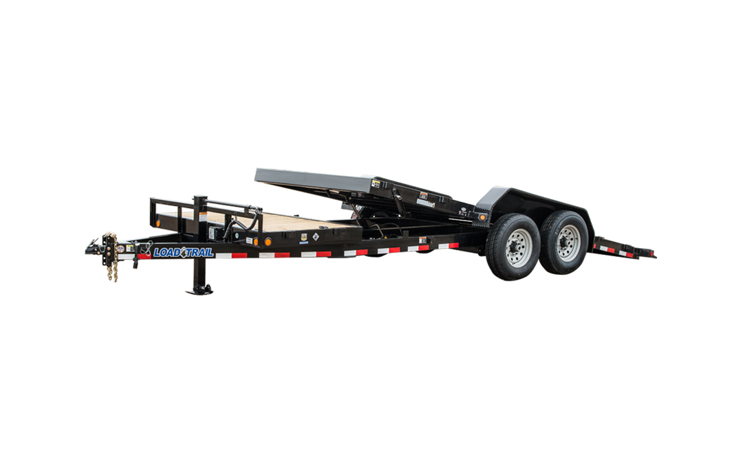

I believe it is deck over frame. Here is a picture of one. It would suck to order a WDH and find it doesn't fit.
YES - Carefully measure everything. I had a problem because most WDH's instructions specifying brackets being place where my battery box was welded on (factory install). The Equal-i-zer was one of the few that fit.

If your hitch frame tilts when the bed is tilted, couldn't you disconnect the WDH when load and unloading?
Bruce
Yes, That is what I had to do with that trailer. It was just a hassle to unhook the WD arms every time I wanted to load or unload.
I didn't mean to imply that a WD hitch couldn't be used with that type trailer and should have added the above statement. Thanks for pointing that out.

Make sure you load & balance the trailer so 10/15% of the weight is on the hitch.
Because of the tilting mechanism tilting deck trailers are notoriously light on the tongue. My 16' tilting deck pivots between the axles as they all do, which means half the deck is behind the axles. On a normal trailer only 30-40% of the deck is behind the axles. You'll need to pull the machine more forward than usual to compensate.
I can't tow my tilting deck with my Tacoma over 55 unless I add a couple hundred lbs to the front of the deck. Had to shovel snow onto it to make it home from the auction I got it at. F250 will pull it empty. Both pull it properly when I load my tractor on it with proper tongue weight, although the Taco is all tapped out (hence me getting the F250).
A tongue scale is worth its weight in gold figuring out proper balance & tongue weight.
