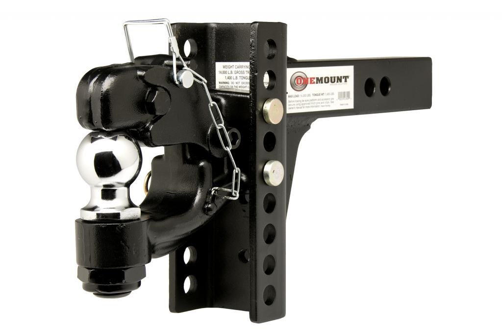

You don't need a WDH for that on a 3/4 ton. Just make sure you have a good stout receiver hitch and ball. Your truck has the 2.5" right? Might use one of those for safe measure vs the 2" with a reducer. I have pulled lots of bumper pull trailers in the 12-14k range with 3/4 tons and have never used a WDH. I would much prefer a gooseneck but it will work.
Yes I have the larger class V hitch. I'll use one of these with the stock reducer. It is rated for 14k trailer weight and 1,400lbs tongue weight.

Lots of good advice here and you seem to be on top of it. I will add one thing to check. Your truck's receiver/hitch will have a sticker on it with load ratings. See what it says for max tongue weight and max trailer. I have a 3/4 ton F250 and found that the OEM hitch is only rated to 5000 lbs unless you go to a WD setup, per the sticker. I could have got a new hitch rated for more, or a WD setup, but after asking the question here, I ended up with the WD. I really wish I had just got a higher rated hitch . WD's are a PITA, and just like you I now have to decide if I need to use it or not with my 10k trailer. My weight with tractor, implements and trailer was in the 8k range, FWIW. The truck has one rating. The hitch has another. And the two may not be in the same league, so check the hitch before you think about running this without WD.

Thanks. Chevy does a Class V hitch (at least with the diesel option). The sticker on the bottom of the hitch says 13k max trailer and 1,500lbs max tongue weight. I believe these weight limits are specific to my truck and not the hitch because Class V hitches have a 16,000 lb max towing and 2,400 lb tongue weight.
In any event I think my research is done and I'm comfortable pulling my load without a WDH. Thanks for all the advice.
