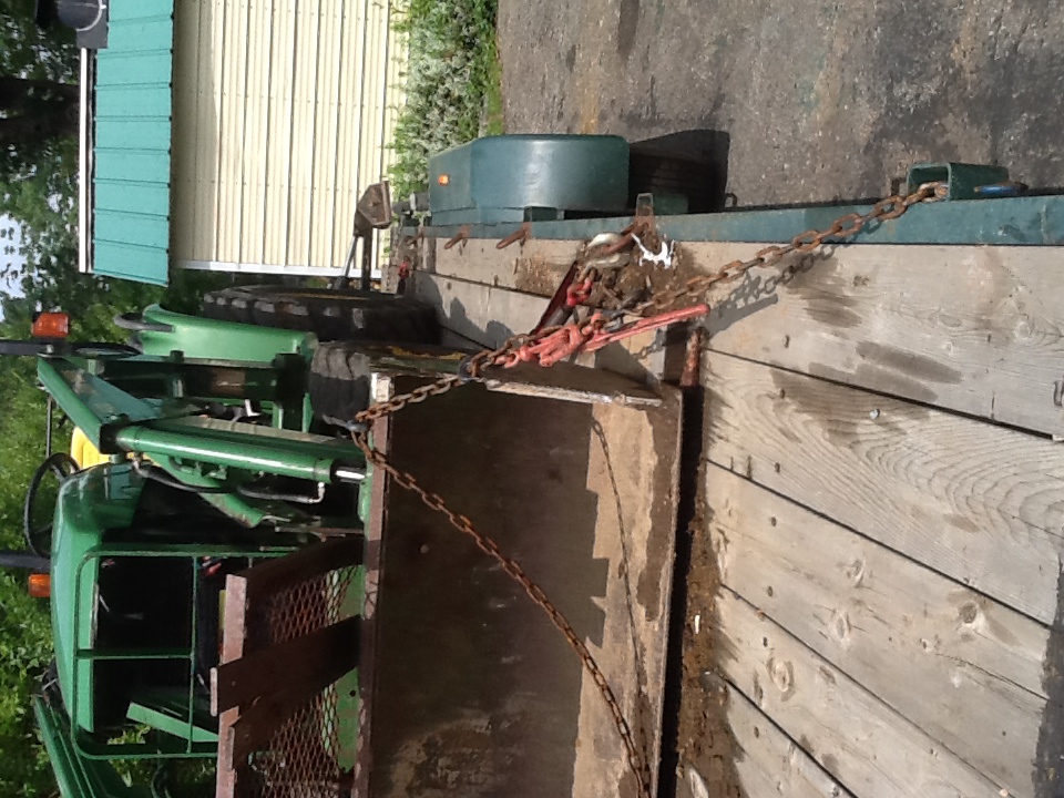

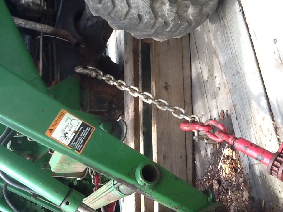

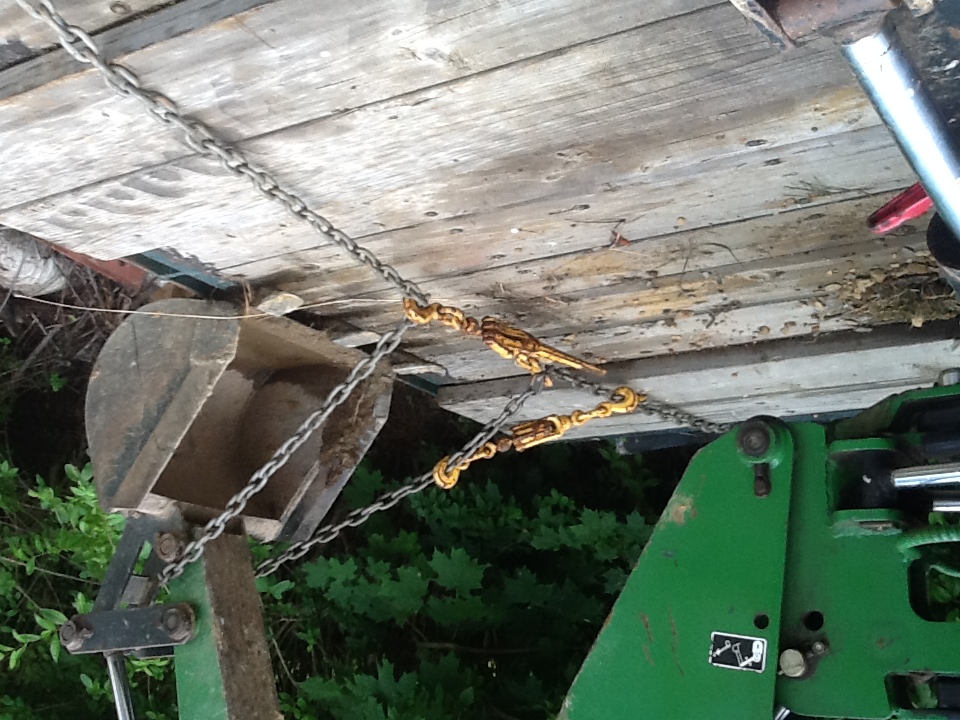

   / Towing tractor and implements 1,200 miles: help me be safe please #33
My tractor chained down.
