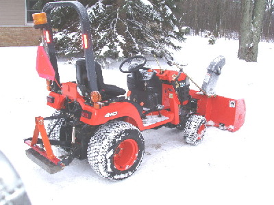

I have attached a picture of my setup which is a stabilizer, weight bracket, and boom pole mount. That is a chunk of solid lead bolted to the bottom.
