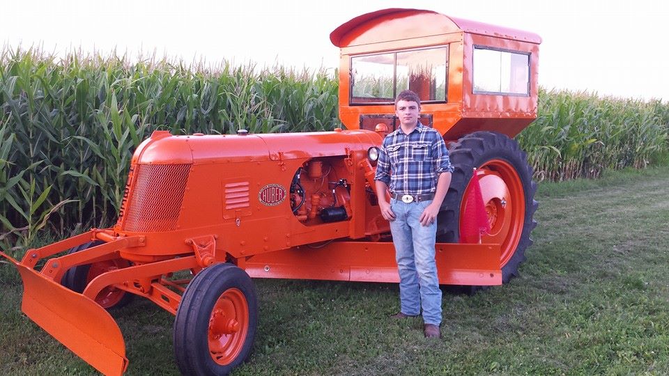

Here's a tractor conversion model as mentioned above. This one is very slick!!!

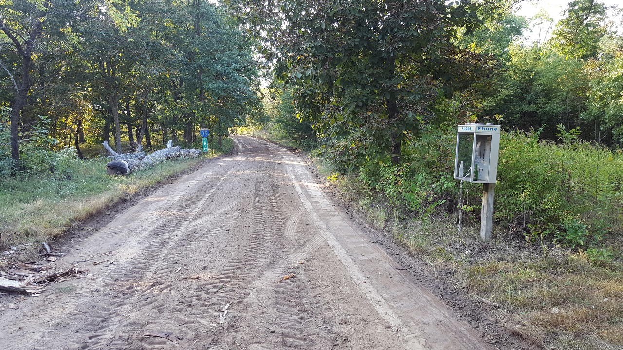

Here's the result of Danny's work on the ole pull type grader. It's a path thru our timber to the campground. He did pretty good for only having a couple hours experience. :cool:

It was already a dirt path full of ruts and not quite that wide. What debris he gathered is buried in the crown.
   / Tracked road grader #20
Gotta do whatcha gotta do..
That works great here in the south,
Bury it and finish with a nice clean tater bed road as we call it :laughing:
