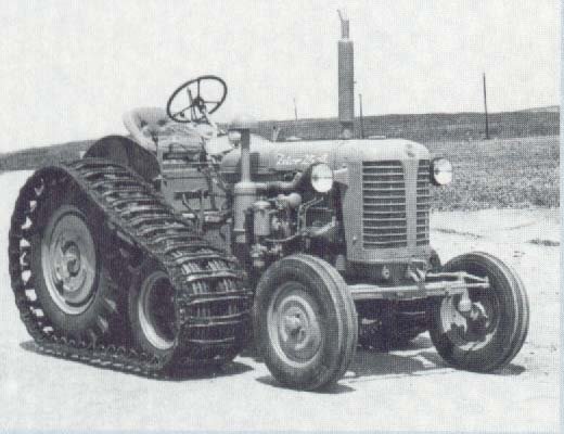

In the 50's Zetor made tracks of two rubberised steel cables with beams clamped inbetween them.
They were tightened by the additional mid axle, that is spring loaded lengthwise and in height. (otherwise the front wheels will come loose when you drive over a hill....
These versions were called "polopasovy"

   / tracks #25
They still use tracks shown in the last picture for collecting maple syrup in the spring up here.

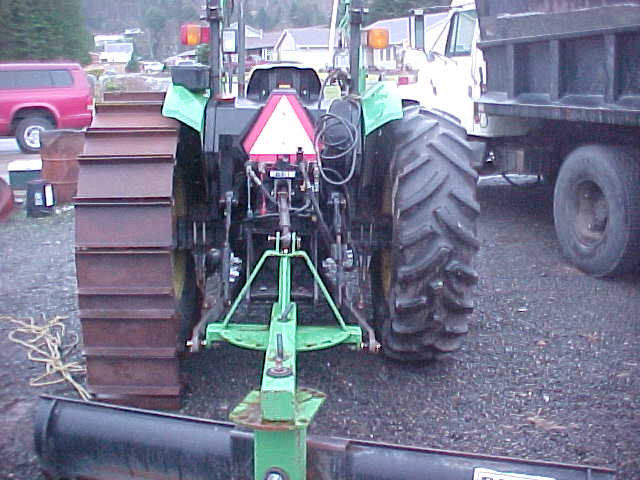

I'm still hoping to see a picture of these "road warrior" tracks.
   / tracks
#29
here you go. I didn't button them together, but you can get the idea by these pics. There is a smaller set for the front and I always widen out the tires to give me fender and turning room when I put them on for real. As you can see the tractor takes on a whole new attitude.
   / tracks
#30
here is one from the rear
