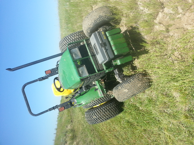

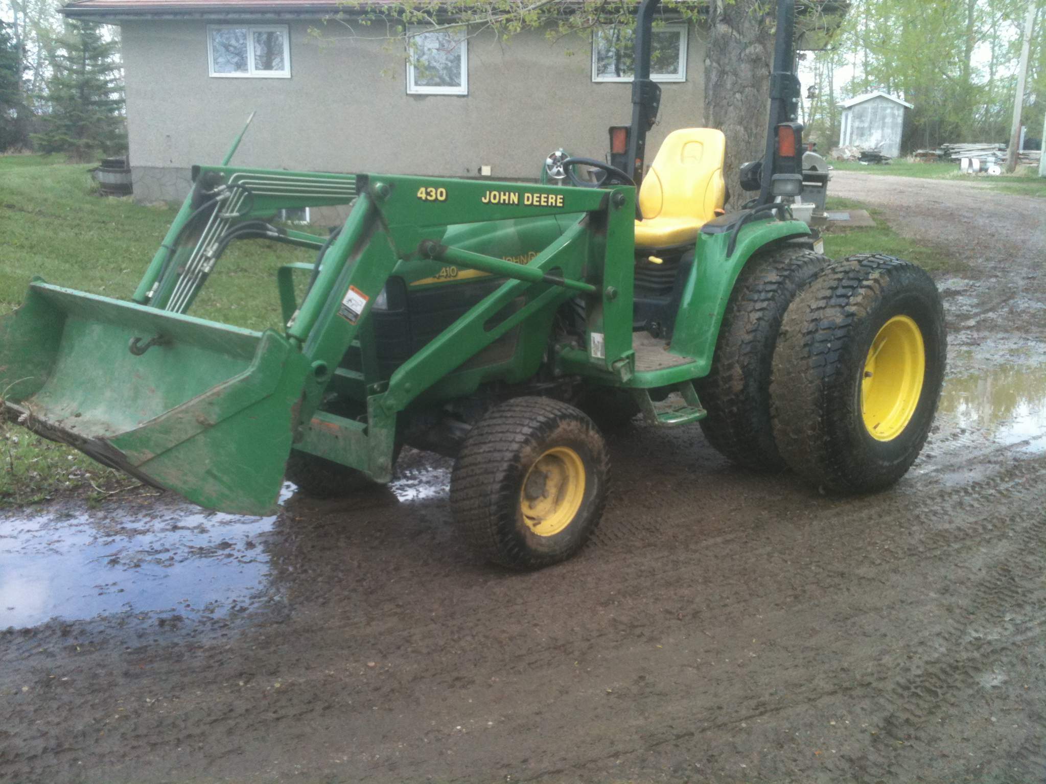

If you set up your tractor with duals and wider front tires like this you will never get stuck. If you want to know how I attach the duals I can post more pictures.
I also am better at modifying my tractor than making pictures rotate to the proper orientation. I need to learn how to do that but that is a job for another day.

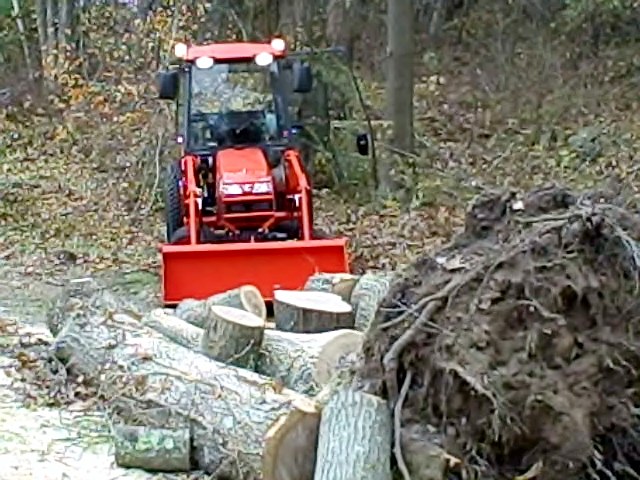

Depending on the amount of mud involved and if you are handy with a chain saw, why not construct what the loggers call a "corduroy road?" Place a series of logs perpendicular to the road so you don't sink in the mud.
