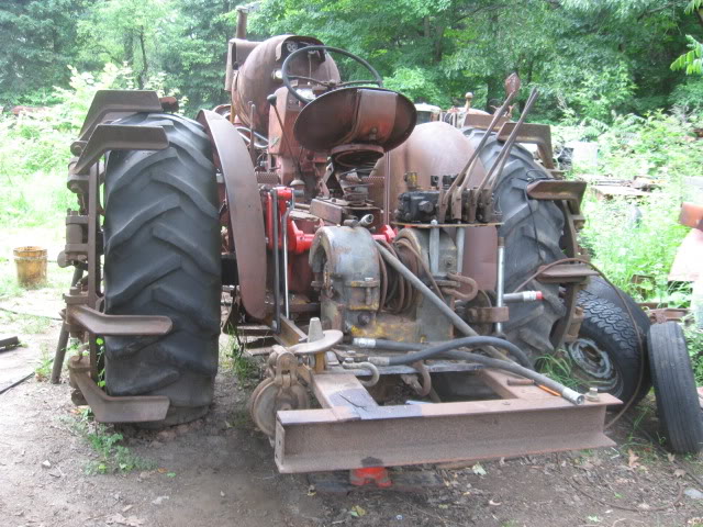

If you set up your tractor with duals and wider front tires like this you will never get stuck. If you want to know how I attach the duals I can post more pictures.
I also am better at modifying my tractor than making pictures rotate to the proper orientation. I need to learn how to do that but that is a job for another day.
With those turf tires, you could get stuck on a cow patty. You have good flotation almost zero traction in mud even with duals. I have gotten stuck with dual R 1 tires with over a foot of space between the tires to allow mud to shed. When they are set tire to tire like those, the whole thing will smooth over with mud very easily and you wont go anywhere even if you aren't bogging in very deep.
Any one who claims he cant get stuck has not been in the right situation yet.
Well what you say may very well be true for your soils but I have no problems with traction or flotation. Here the mud is sticky enough that even without the duals there is plenty of traction.
I have rototilled bare mud just to try and help a customer dry out the soil so they could move it around with a blade. I have also rototilled sod to make enough loose soil to repair irrigation ditches. There was water running over the sod that I rototilled. With the duals on I haven't been stuck but then maybe I haven't tried hard enough to get stuck either.
When I clean manure out of corrals is where I run a bit short of traction but as you remove the manure from the corral it drys out just enough to not be a problem. At least with the lawn and garden tread it doesn't chew up the soil and I don't need to be so careful with the corral walls. I need to take some pictures of these situations!

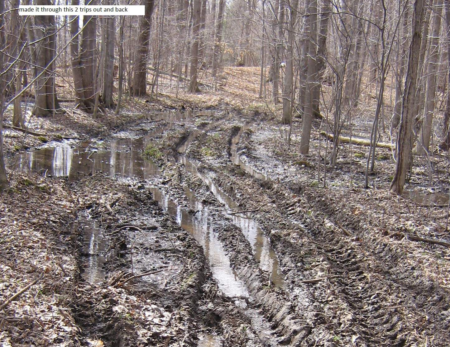

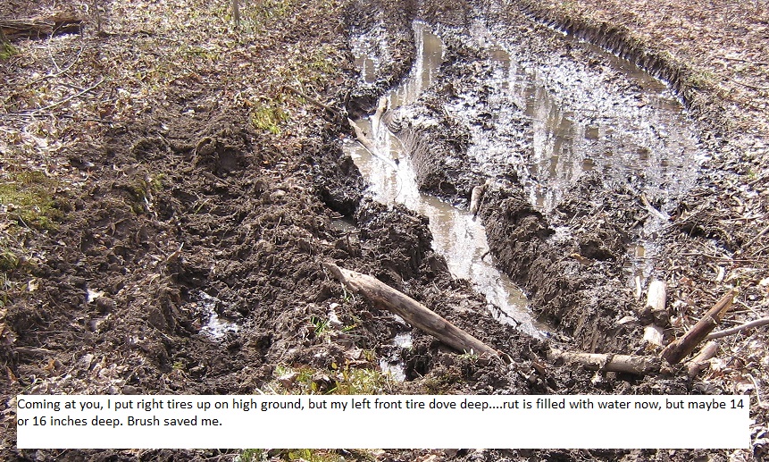

Here's two pics of the mud holes.
/ Traction in Mud #31
Yeah, those will do for mud holes all right.
/ Traction in Mud #32
After seeing the pictures there is now way I would have tried that.You "gotter done".

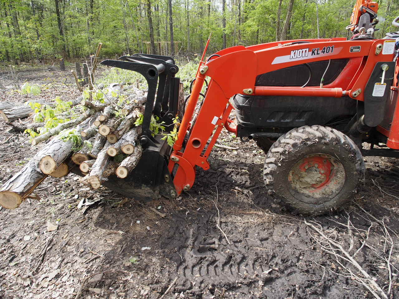

Yep. I live in these daily, and worse, created by my continuous "logging" with the FEL at near max. capacity as I am clearing my property home site and the very wet spring we are having. When the ruts get too deep I spend some time with the ROBB and bucket leveling it out and hopefully letting it dry out somewhat; but this spring has been unusually wet and drying out is seldom. I ran a subsoiler in the worst areas hoping for better drainage- but that has not seemed to help.
My course is to use 4WD continuously (2WD would get me nowhere). Then resort to differential lock when I start to get stuck. Had to use the loader once to get unstuck by lifting the left buried front wheel out of the muck, which allowed differential lock and the rear tires to pull me backwards to more stable ground.
Test your differential lock by being in a sloppy section, noticing only one wheel spinning and then engage the lock and hopefully both rear wheels will be engaged and spinning after a few revolutions. You can make the situation more lively by having your bucket digging into the ground while doing this test and seeing the results.
