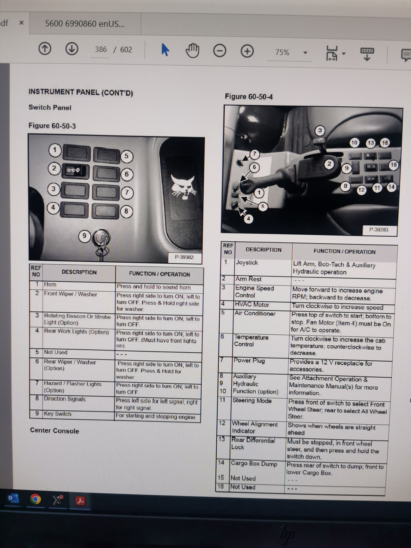

So I just found a 2012 Toolcat that supposedly has the traction control option. I've come across varying opinions as to whether or not only the 2014+ G series machines had a traction control system.
Would a 2012 F series have the same traction control system as the G series? I though I had read somewhere that the differential system in the F and G series may be different which would lead me to think that the traction system may work differently on the two different series as well.

here is a picture of the console, diff lock is switch #13, it only locks rear axle diff, the wheels have to be straight and front steer only, the front axle does not lock though as the front and rear are the same if you apply pressure to the fitting on the front it will lock, I added a Tee and a solinoid to do this, only use in snow as it does lock it solid
the traction switch works differently, in low/default speed traction is on all the time, in high speed it turns off by default, never tried switching it during either speeds never had the need to try, next time out I will see what it does

Thanks for that pic. Turned out the 2012 did not have traction control. The switch on the 2012 for what I had thought was the traction control as found in the 2014+ F series, was actually the strobe light function as found in the earlier machines you have pictured.
