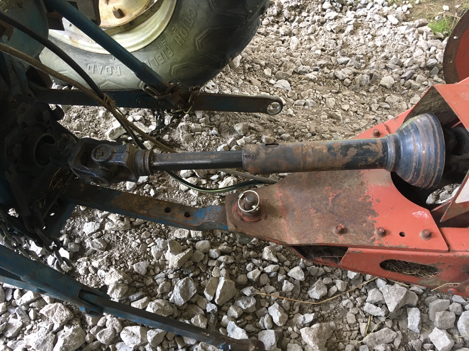

While my cousin was baling hay he started to pull the trip rope to kick the bale out.
He remembers the trip rope being close to the pto shaft and starting to push the clutch in to stop and reposition it.
His next memory is coming to on the ground, being unable to move, watching his tractor and baler going across the field.
A couple of young boys saw the tractor and baler, sans operator, going across the field and ran to tell their dad who found my cousin and called the ambulance. Tractor crashed into a tree.
He was airlifted to the hospital to find his hip was shattered, vertebrae cracked and ribs broke. They put screws and pins in his hip to hold it together and he has to wear, as he calls it, a turtle shell brace.
I went and looked at the tractor and baler today. Surprised it didn’t happen sooner.
Unshielded pto shaft.
No seat belt.
No support to keep the trip rope from the
pto shaft.

What exactly happened? Did the trip rope get caught in the pto shaft and the other end get wrapped around him pulling him off the tractor? It's **** too easy to get complacent on a tractor. Let's be safe out there. I'm glad your cousin is going to survive to tell the tale (what he can remember about it).

He doesn’t remember exactly what happened. We assume that he had the rope wrapped around his hand. The pto grabbed hold of it and pulled him off the tractor.
The baler tire ran over him.
All I know about the rope is what he has told me. That he pulls it to make the bale and kick it out.

Half the pto shaft had a guard on it. I’m not sure a seatbelt would have helped. Glad to hear he wasn’t hurt worse. Speedy recovery hoped for on my part.

Half the pto shaft had a guard on it. I知 not sure a seatbelt would have helped. Glad to hear he wasn稚 hurt worse. Speedy recovery hoped for on my part.
Well, depends on what the expected outcome is.... With a seatbelt it would have ripped his arm off. Probably at the shoulder. For sure at the hand.
Not condoning unsafe practices. Just remarking that with everything else wrong in this scenario a seatbelt would be far down the list.

I've read far too many stories about guys getting wrapped up in PTO shafts. If I buy something without a shaft shield, I won't use it until I've put one on it. I've got 4 little ones and a good woman under my roof, who all have my last name... just not worth the risk.
