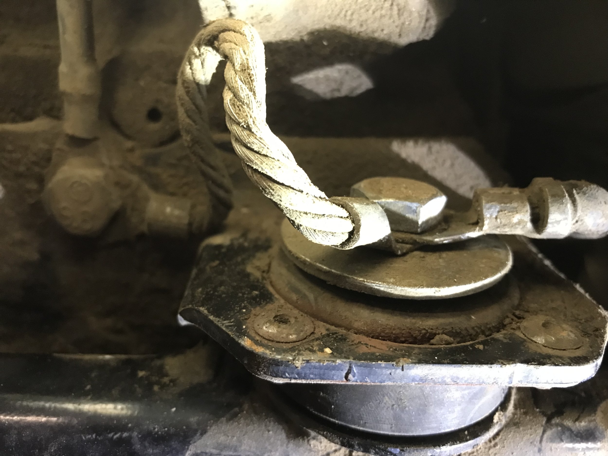

Mine stays running /. Do you have pic of selonoid and where it is i see the starter
On about 95% of starters the Solenoid is a can on top of the starter.
startermarked-jpg.831346
On a few vehicles, the solenoid will be a separate switch mounted somewhere else (fender or firewall of a vehicle).
I like to use a screwdriver to short between the battery connector and the ignition connector on the Solenoid. WITH THE TRACTOR OUT OF GEAR!!!
That'll help you track down the problem. Battery wire problems, ignition wire problems, safety cutoff problems, etc. If it starts, then the battery and starter are fine.
