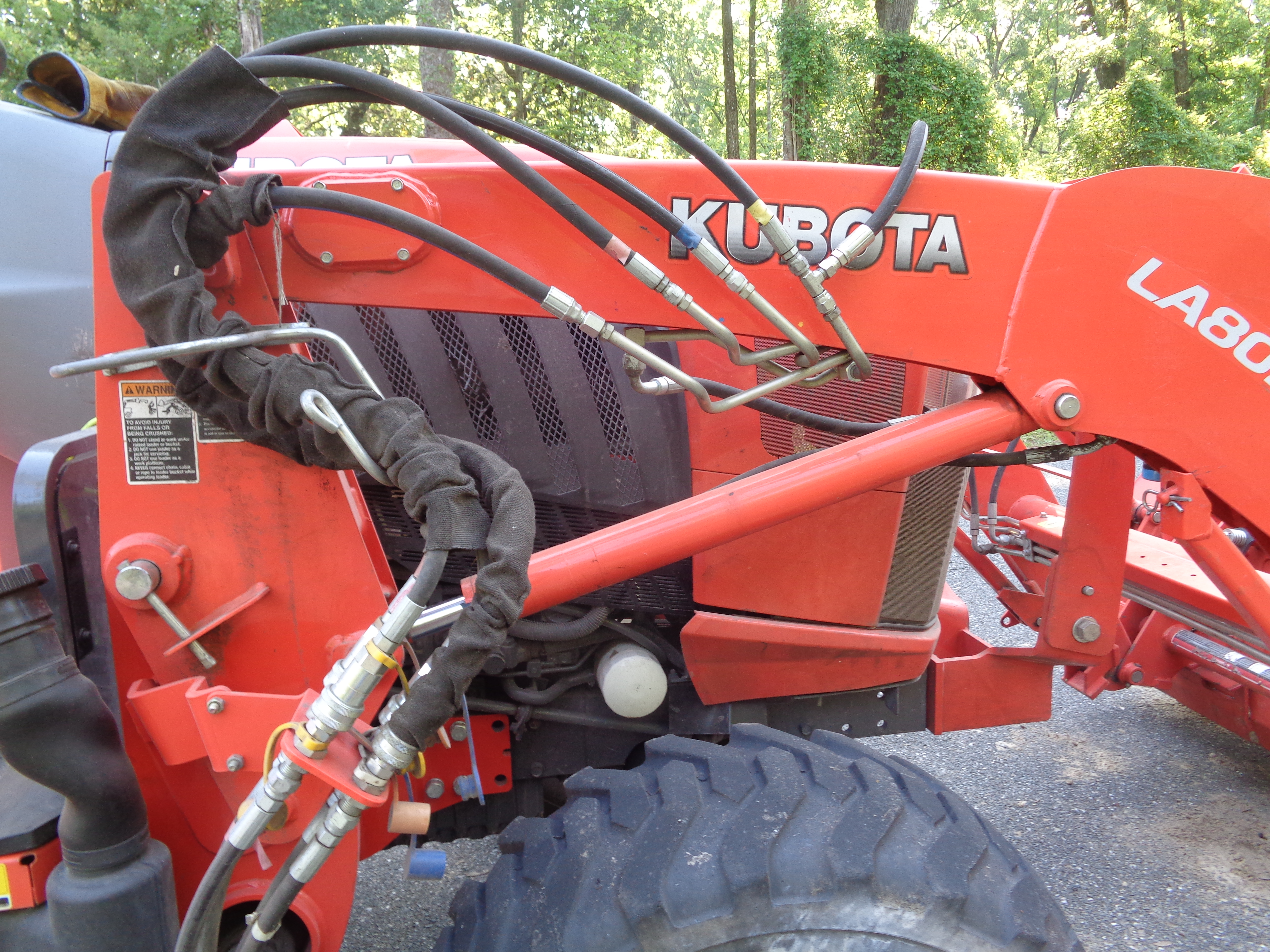

As mentioned before, this happens on large wheel loaders and backhoes as well. Most new models have a feature that dampens the main loader boom to help prevent this (Ride Control). Anyone who has taken them down the road at road speed knows how they will begin to teeter-totter. Anything can set it in motion (bumps, acceleration, braking, etc) and the oscillation becomes worse and worse. My fathers Cat 416 was so bad you would have to come to a complete stop regularly to control it.

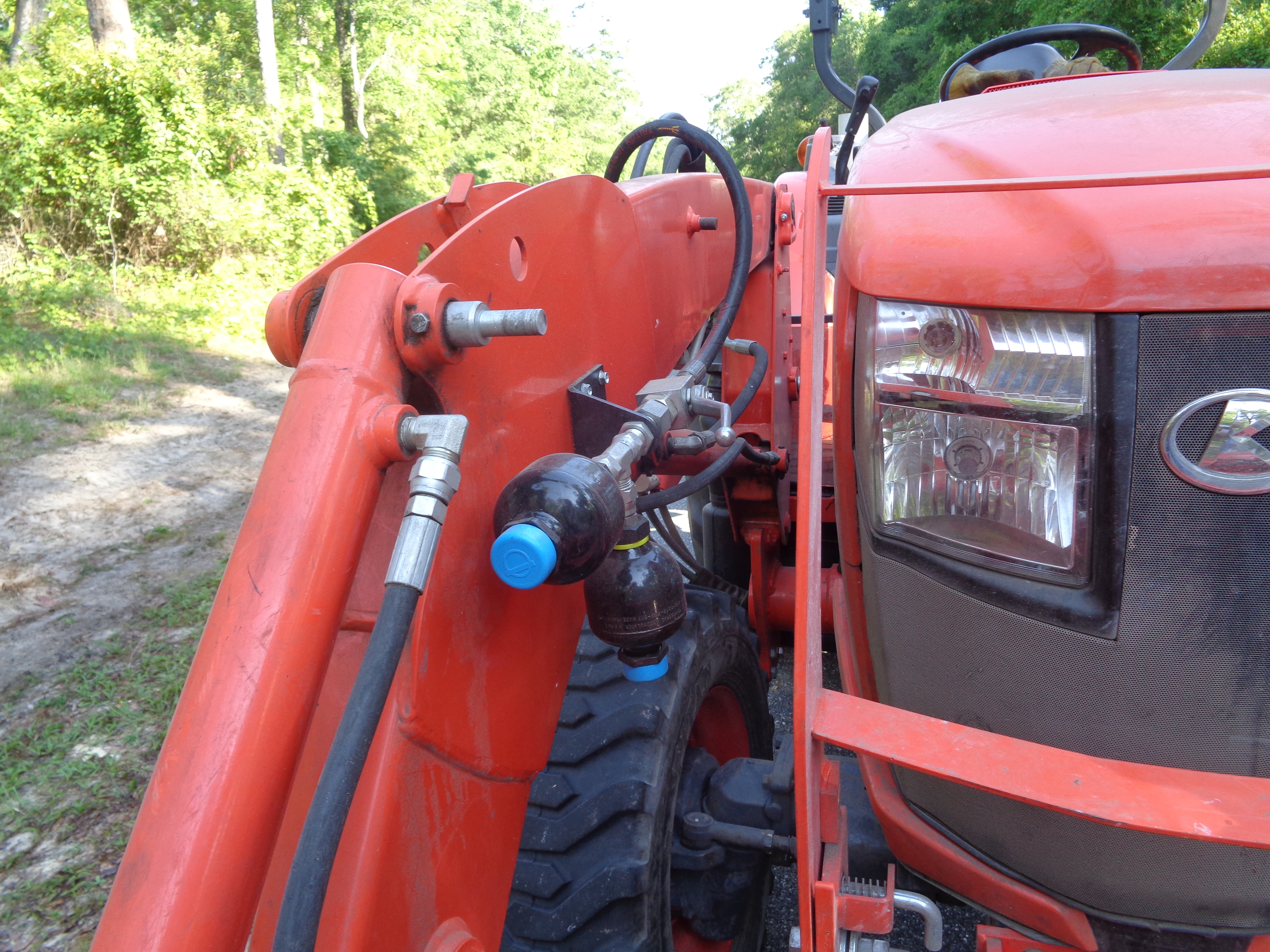

Would consider comfort ride on the loader, reduced wear and more comfort.
/ Tractor "bouncing" ? #36
It does help, but its not a cure. I'll spear 2 4x5 round bales and drive down the road with them and the tractor ride quality is at least 50% better with KSR turned on. Takes the stiff pounding out.
