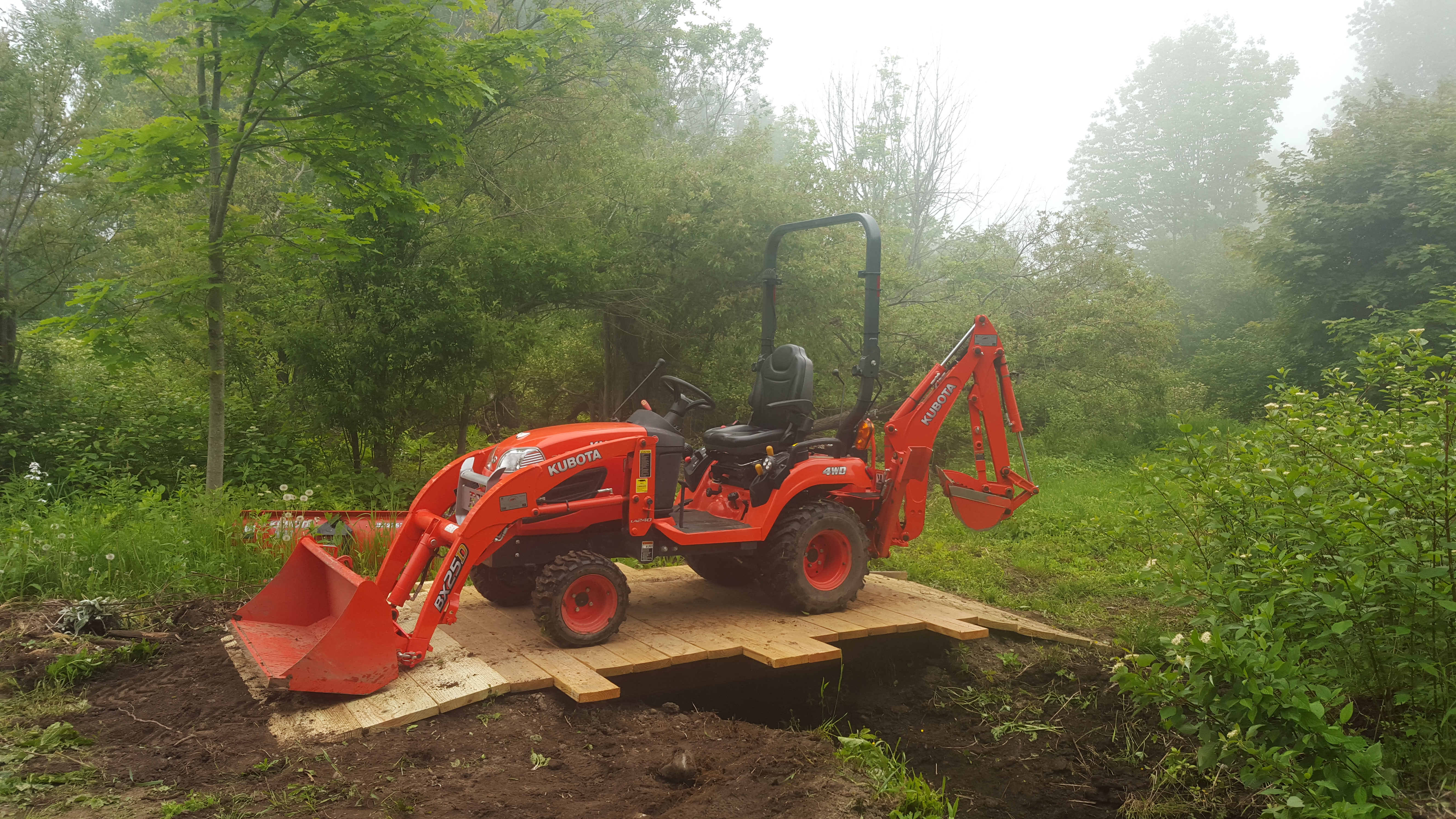

We went with a bridge...in part because of the aesthetics and where it is on the property and in part because they just replaced the utility poles on our street and gave them to us. :)
   / Tractor Bridge Ideas #17
Nice bridge, utility poles make great bridge support beams, there most likely treated against rot. The top blanks probably will need something for rot prevention unless you used cedar. If I made a bridge, I'd try wooden nails, that way it will rot with the planks, steel nails will last quite awhile and could cause a bad day 10 years down the road.
I had a stack of PT boards that I decked with, but cedar would have been nicer. We still need to build the railings.
   / Tractor Bridge Ideas #19
I just noticed your in Rockland, hey neighbor, probably got your tractor from the friendly folks.
I thought PT lumber had a green-ish tinge to it, those planks looked like regular lumber, good deal guess your all set, after the rails are on, post another picture when you get a chance.
