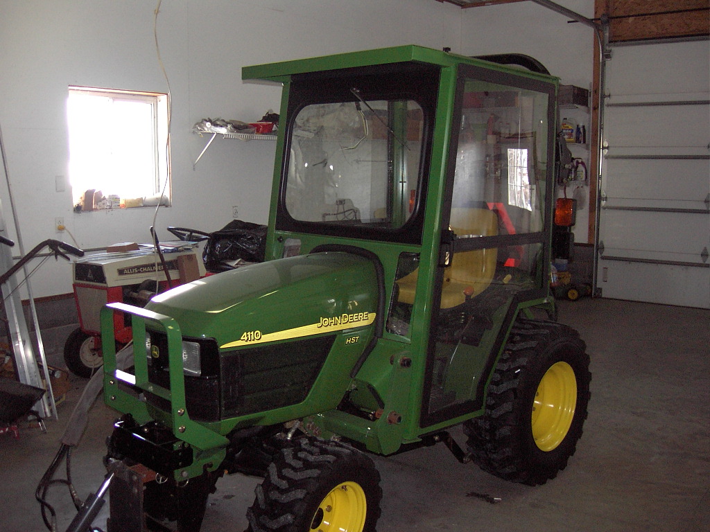

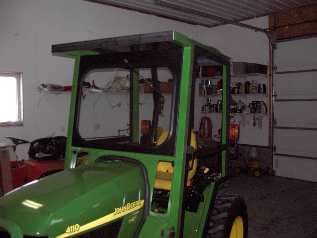

tractor cab 041.jpgtractor cab 039.jpgI built a cab for my 4110 a couple of years ago. Like you, I read many threads and picked out the features that I thought would be the most beneficial to my particular application. I wanted something that would be light weight and easily installed and removed as the seasons changed. I'm located in the western part of Virginia, so our winters are not as cold and harsh as many areas. I only intended for my cab to be a wind break and did not install any type of heater. I seem to stay warm enough wearing just a coat. For me, just staying out of the wind is great.
For my frame, I used 2" square aluminum tubing. The roof is 14 guage aluminum sheet metal, and the doors are aluminum angle. The windshield frame is 14 guage steel sheet metal with tempered glass and a universal wiper kit. All other windows are lexan. The rear window, as well as the lower front windows are secured in place with velcro, so they are easily removable if needed. The doors hinges are the pin style, so the doors can also be removed when desired. Due to the fact that my ROPS is the folding style, I had to get creative with the rear part of the cab in order keep the ROPS in place and still have some room behind my seat. While there is plenty of room to work inside the cab, I have doubts about enough room for your four legged buddy. My cab also seems to be very noisy. I have taken certain measures to try and deaden the noise, but haven't been very successful so far. Perhaps soft doors and windows instead of lexan would help soften the noise. I also used mostly 1/4-20 fasteners with knobs, just for easy installation and removal. I also had to build the windshield frame so that it would pivot a little in order to raise the hood of the tractor.

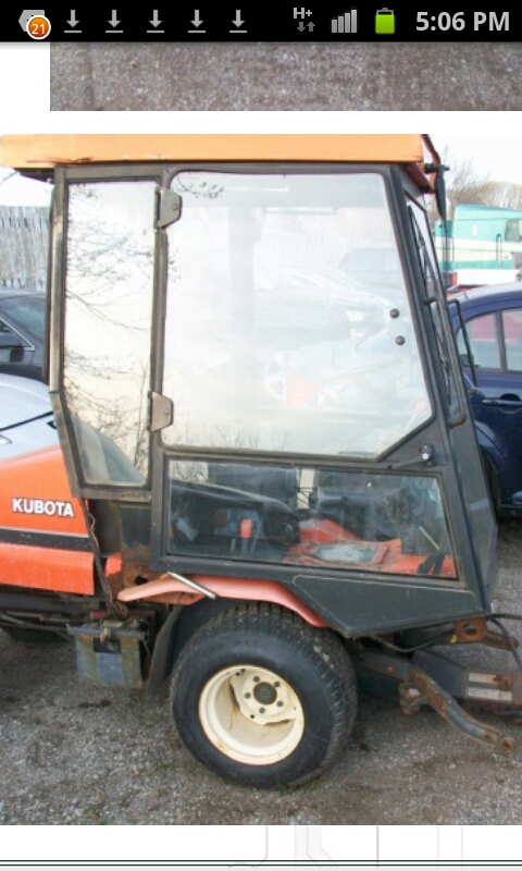

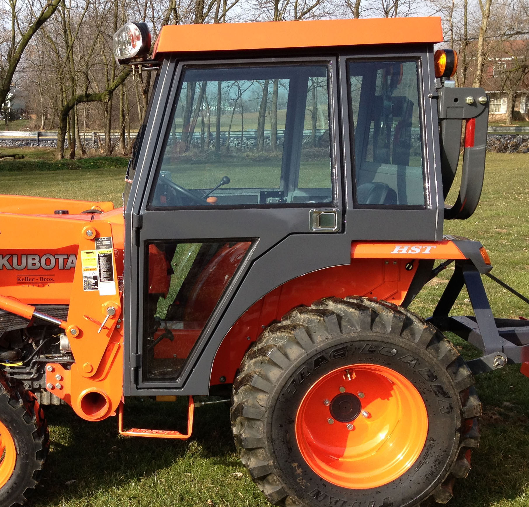

I modified a Jo dale Perry front mount mower cab to fit on my brothers John Deere 4115 (same as 4110 but longer wheel base). I was in the Auto Glass business for over 25 years so that was a big advantage. The cab was started to be modified for a Kubota by my friend then he came across a Laurin cab for his model so sold the Jo dale to my brother. If you can weld and cut steel it is not that difficult of a task. The biggest expenses are Glass, Wipers, Heat and good lighting. Starting with the cab gave me the top half with roof and heater so I only had to modify the bottom mainly.roys old cab.jpegtractor 2.JPG4115.jpg

About 10 yrs ago I built my cab for my Mitsubishi MT180D on the cheapo.
Made 2 frames of 1.5" sq tubing and then joined up with same material to form the cage.
I obtained glass panels from scrapped school buses as well as the gaskets to install the glass. (emergency doors are nice size)
Next I had a shop cut me galvanized (about 16g) panels to cover front and rear spaces as well as the frame roof.
For the roof I had them fold over the edges for rigidity as well as a 'drip edge'.
The widows were free as there is no value in glass.
Using the glass as a template, I cut out the panels to insert the glass and then simply used 1/4" sheet metal screws to attach the plates. I did not weld the plates as I wished to stay with the galvanized finish which will never rust.
B4 installing the roof, (screws again) I sandwiched a headliner backed with thin foam for insulation as well as sound deadening properties.
Roof sports 8 screws and the front and rear panels 6 ea.
Door is 1" angle stock using soft plastic as found on convertible rear windows as is the non door side.
Soft material is held in place with 1" strips that are 'pop riveted' about every 4 inches.
I also recycled one of the buss 'under seat' heaters to heat my cab.
And YES, I would go this way again. Very satisfied and very functional.
I will post a few Pics tomorrow.
True we are some years down the road but at that time my total 'out of pocket' was $200.!

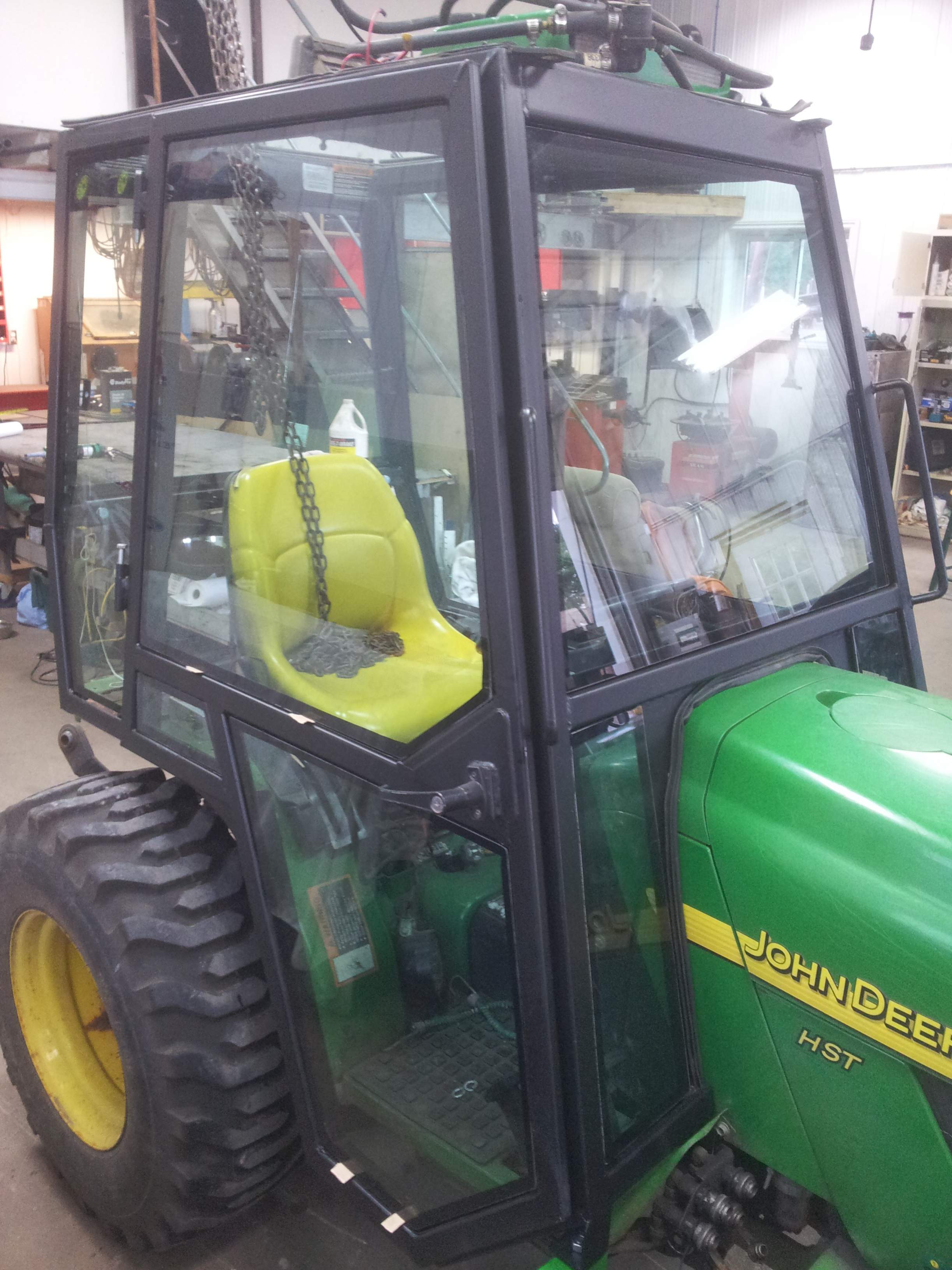

Mine extends just wider than the fenders at the door frames, and has a taper from there up. That shape did cause some coffee breaks (head scratching breaks) during fab. The door opening is as big as I could make it and it still takes some getting accustomed to after having a wide open area all summer without the cab.

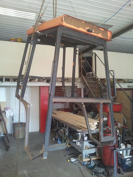

I reread your build posting last nite and the taper to the top has some intrigue. Just tossing around the door mounts as they can only be on the longest vertical straight post. Was wondering if there is any door flex or if it would cause a problem. I have a smaller tractor frame. Using 1 inch tube steel there is less strength with narrow material. I still think the wider base is a good way to go. Not entering any beauty contests so I am going to explore the more room idea.
/ Tractor cab ... any helpful hints ? #14
No noticeable flex on the doors. The doors are 3/4" square tube that's fully welded for starters. Then there are sheet metal strips welded to the door frame to bed the glass. Other metal welded into place in/on the door is the skin, some steel for the latch, etc. All that stuff tends to make the door a self-reinforcing unit. The glass is glued into the door and then siliconed from the outside.
The cab frame sections are 1" square tube and really solid. Most of the cab frame has double runs of tube only inches apart for the attachment of the metal skin. There are some single vertical pieces of 1" tube at the glass. When the cab sections are bolted together even those are effectively doubled as well.
Originally I wanted "suicide doors" but as you mentioned it needed a vertical post. That meant hinges in the front. Hinges on the back end of the door were only possible if the doors swung up as they swung back. It was complicated enough without trying for modified gullwing doors.
The doors use simple pins for hinges. The pins are captive in the lower hinge half mounted on the cab, and I did have the presence of mind to make the lower pin shorter than the upper pin so they can be aligned one at a time while dropping the door onto them.

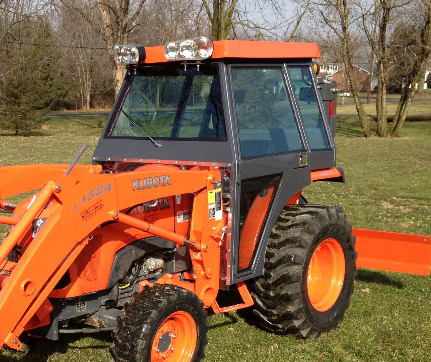

I built the doors using the same 1" square tubing as on the cab frame. The side and rear windows are lexan - rubber gasket mounted to 16ga steel.
Mine is built in sections that bolt together. One section around the hood, one is the roof, then one for each side.
The doors and windshield are on the slip off hinges. It is always interesting putting the windshield on as it is heavy and you have to line up the two pins at the same time - cured by making one pin slightly shorted. The windsield is all cracked from twisting and being hit by things.
Used all LED lights to keep power consumption down.
The heater helps, but it keeps the engine temperature cooler so you don't get as much heat. It does help though.
I mounted two small 12volt muffin fans to blow on the windshield for defrost.
Bought Bose noise canceling headphones to keep the noise down as most other noise reduction methods failed. Hooked headphone jack on the radio.
Used a car radio in my 'dash' - rain killed it.
The back panel is a 'squeeze' fit into the ROPS.
In the summer I remove the two doors, windshield and rear panel. The roof is a nice sun shield.
The Kubota (BX2200) sucks cooling air from under the steering wheel, passes through the radiator and out the front. In order to heat the cab, I removed the panel uder the battery so it sucks air from under the tractor and blocked the vents into the 'cab' area. The problem is that in the summer with the panel removed, it sucks grass and debris from the MMM and blows it into the radiator.
If I were to do it again I'd use lighter materials to keep the weight down. The weight that high makes it more tippy. I would also really isolate the cab from the tractor to keep vibration down.
