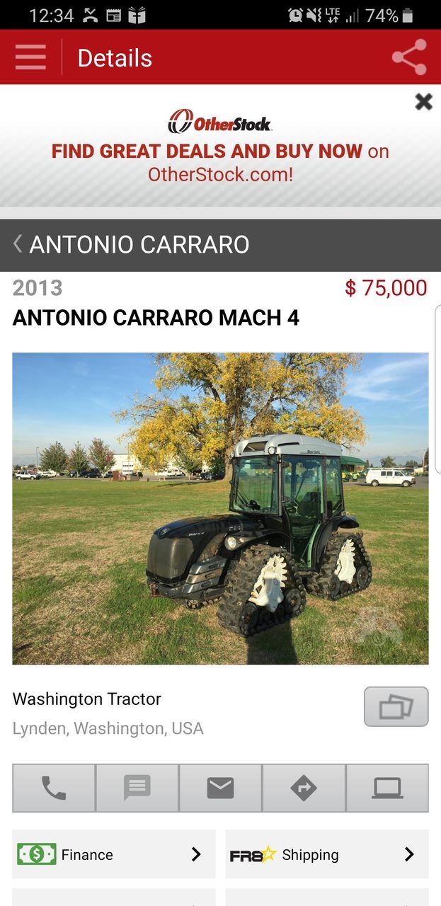

These are typically found in vineyards in the east and west. There are good dealers there. If you're in the mid-west, you might be farther from a dealer than is practical

I agree 100%. I was actually pretty serious at one point about getting an Antonio Carraro and putting a heavy-duty flail mower on it and do custom brush mowing. Maybe they would be a bit small for your application. They import up to 75 hp models. They have bigger ones but those arent imported due to emissions reasons. Those are the ones i really want. Also, check out their Mach 4 model. It's basically the same tractor, but a quad-track. In my mind, it's one of the coolest tractors in its size category.
Nearly all the Antonio Carraro models have the option of turning the seat and steering wheel around so you're looking out over the 3 pt/pto. The visibility is phenomenal.

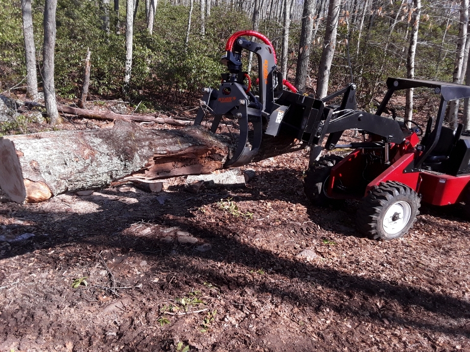

Just wondering, but why would you want a very complicated and expensive to repair Antonio Carraro over a US Built, component part, Power Trac that doesn't use a difficult to connect 3pt hitch and can lift all the attachments up higher then the AC which is nice when using lift forks, lift boom, front hoe, brush grapples, tree pullers and cutters, or even the rotary cutter to cut brush back that tends to invade along all the edges of fields growing to the light? The Carraro can't do any of this without buying a loader and then it is just like a standard tractor trying to look over a long hood.

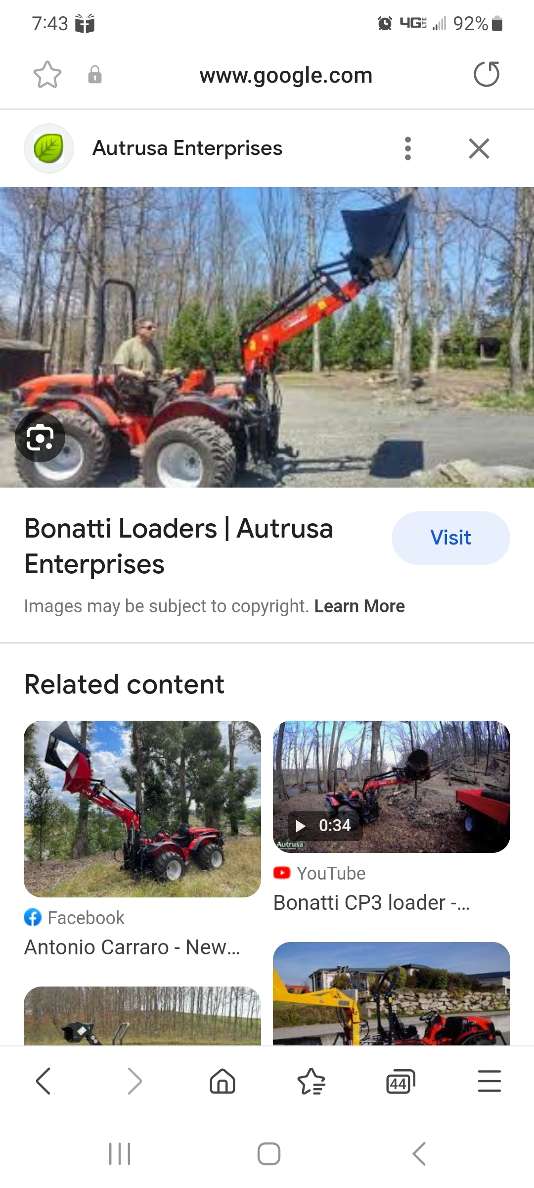

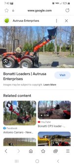

This is the loader I would get if I needed one. These tractors weren't really built with a loader in mind, like was mentioned already. There are loaders that mount on the front but I wouldn't want one of those. I really don't see how their hoods are that much longer or harder to see over than American tractors. But more to the point, OP mentioned mowing and neck strain related to that which is why I suggested this machine. If he had said he needed something for loader work, I wouldn't have recommended it

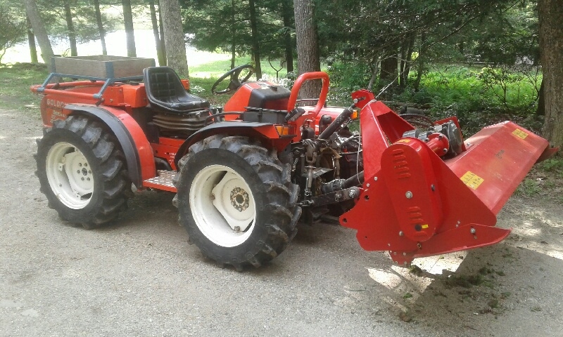

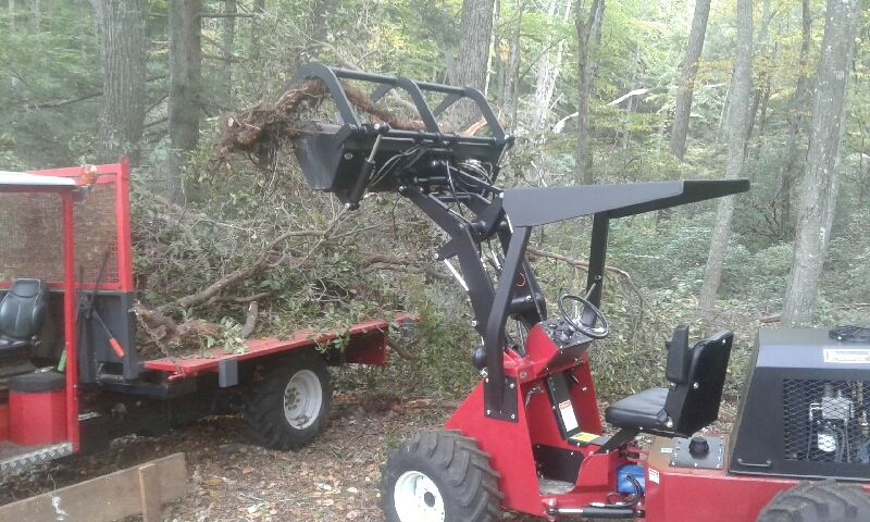

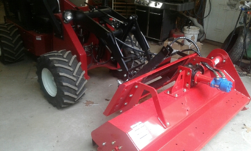

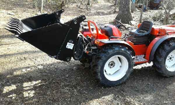

It is NOT a loader. CAT coined the term "Tool Carrier". The PT is just a better designed machine. The implement, in this case a mower deck is right out in front of you where you can see and because of articulation, can even move sideways just by turning the steering wheel. If all you want is a mower, then that is what it is...just pick the type: brush, finish or boom or all of the above. The VERSATILITY allows you to use as a loader too, but again, it is not a loader. AND it is much easier then a 3pt hitch to connect, all can be done without leaving the operators seat except for connecting hydraulic hoses when applicable. Forget about struggling with a large PTO shaft between the lift arms!
I owned a Goldoni which is just like the A Carraro and they don't hold a light to the Power Trac in versatility. The the cost to buy these tractors, why not have one that can do a lot more work easier. I have attached 2 pics of my Goldoni and 2 of my PT similarly equipped.
