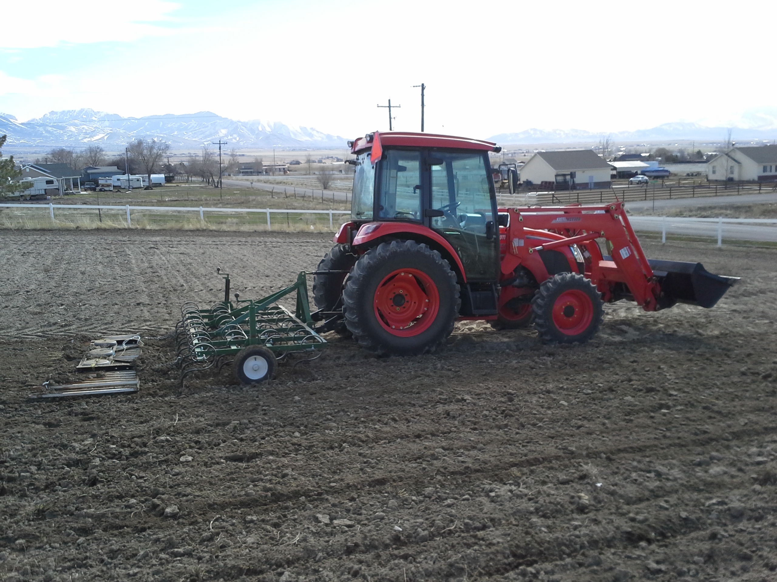

As stated already, a dozer with a root rake to remove any larger pieces of roots and debris will save you time. Then you could use something like this springtooth harrow. I think it's my most used piece of equipment.
I would not hesitate to give Kioti a good look. I have had no problems with mine, does everything I need. Mostly farming/haying type work.

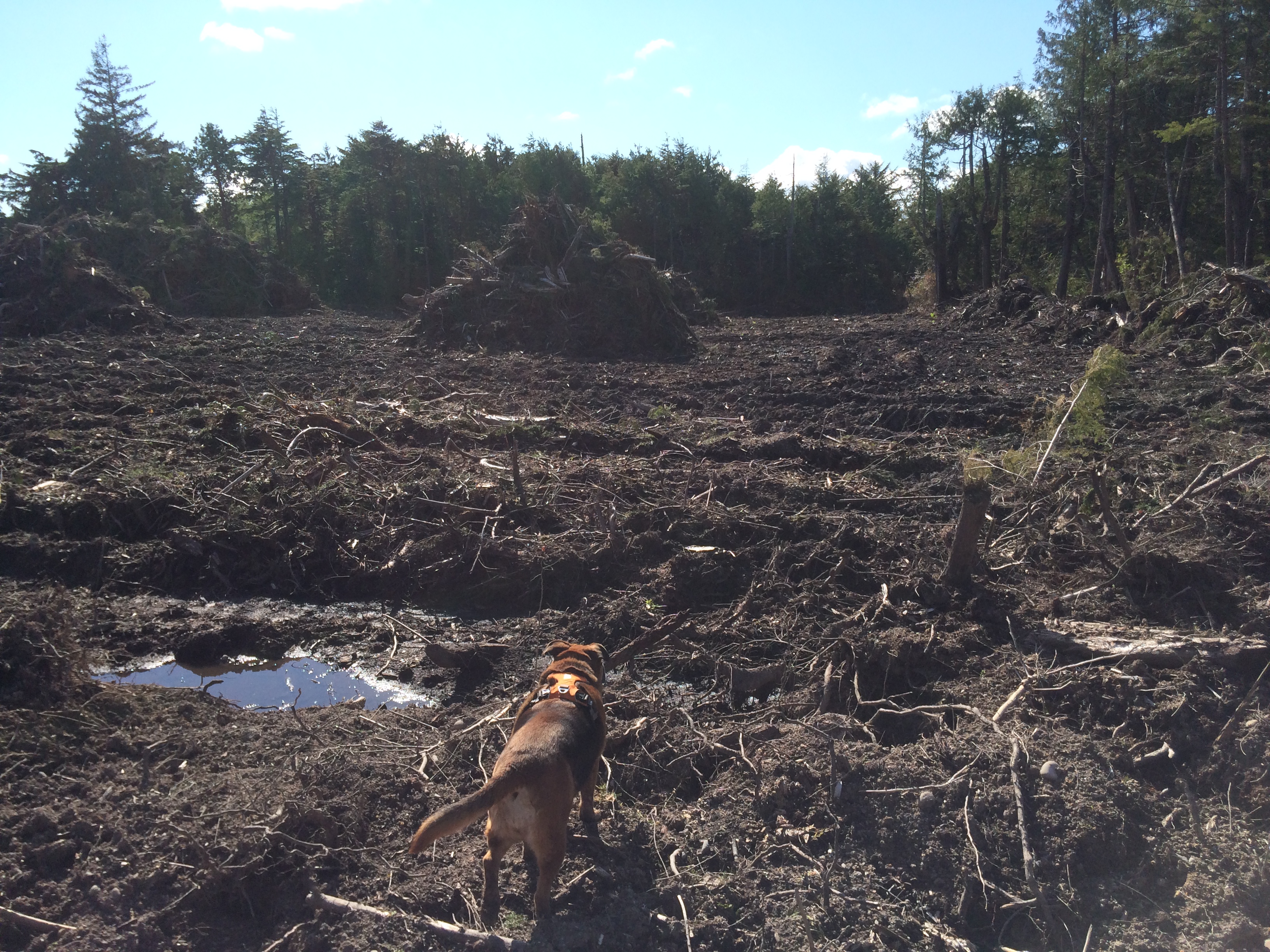

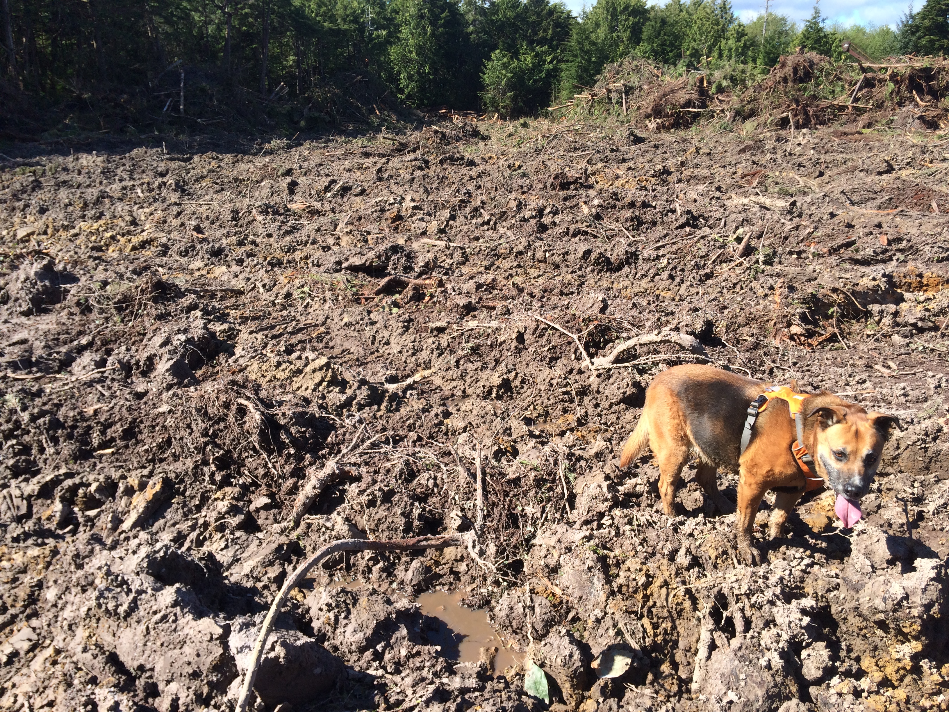

Primary land clearing is done and it finally stopped raining long enough to get some pics today. These will give you some idea of what I am working with. I'm pretty well sold on having a dozer come in before doing anything else. It seems like it would be really rough going trying to drive a small tractor around out there.
As for tractors, the local Kioti dealer suggested either a NX4510 or NX6010. I need to learn more about the transmission options, but it looks like there are plenty of threads here on that subject. I can't get a dozer out until July, so that gives me lots of time to keep learning.
