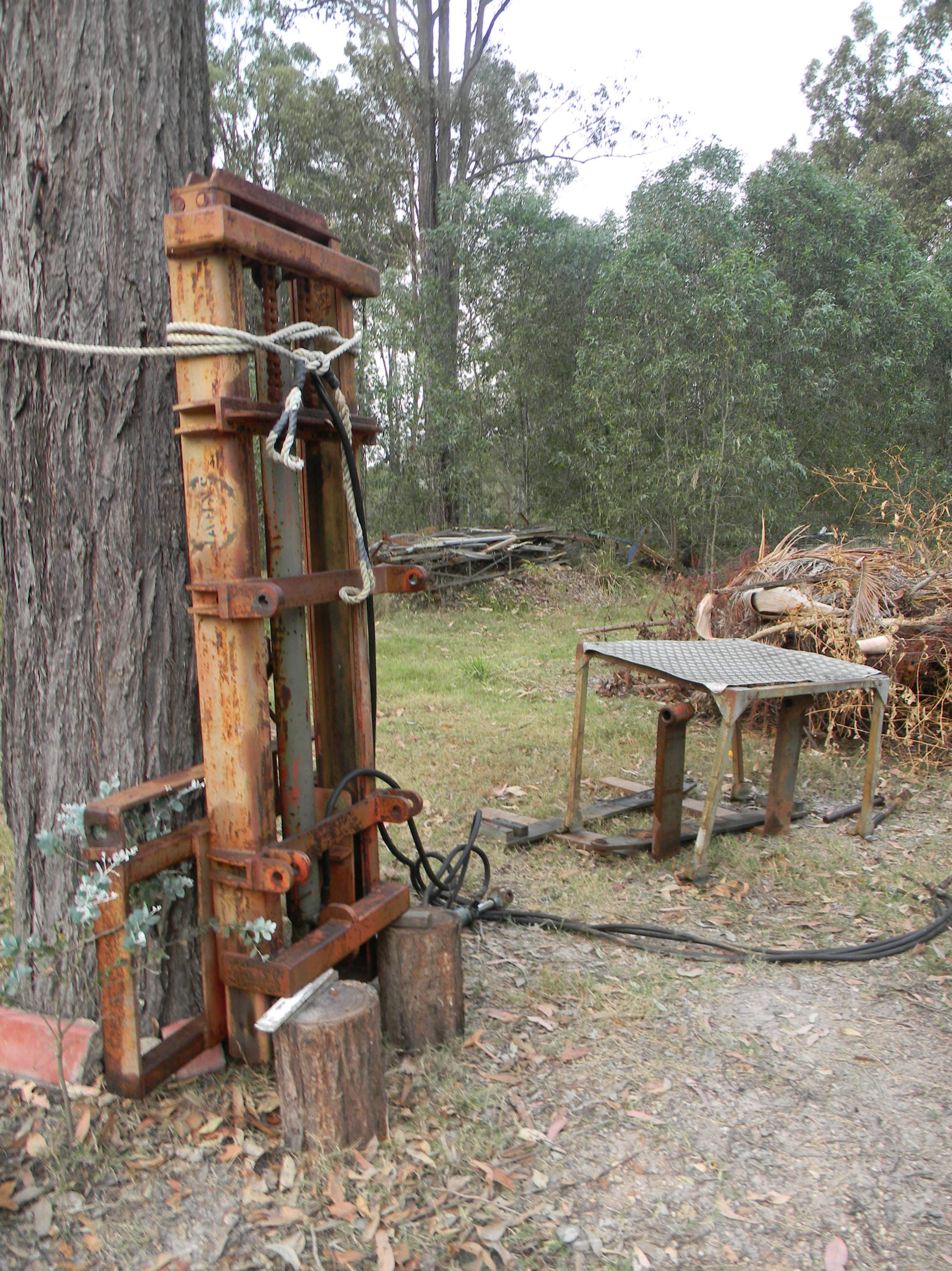

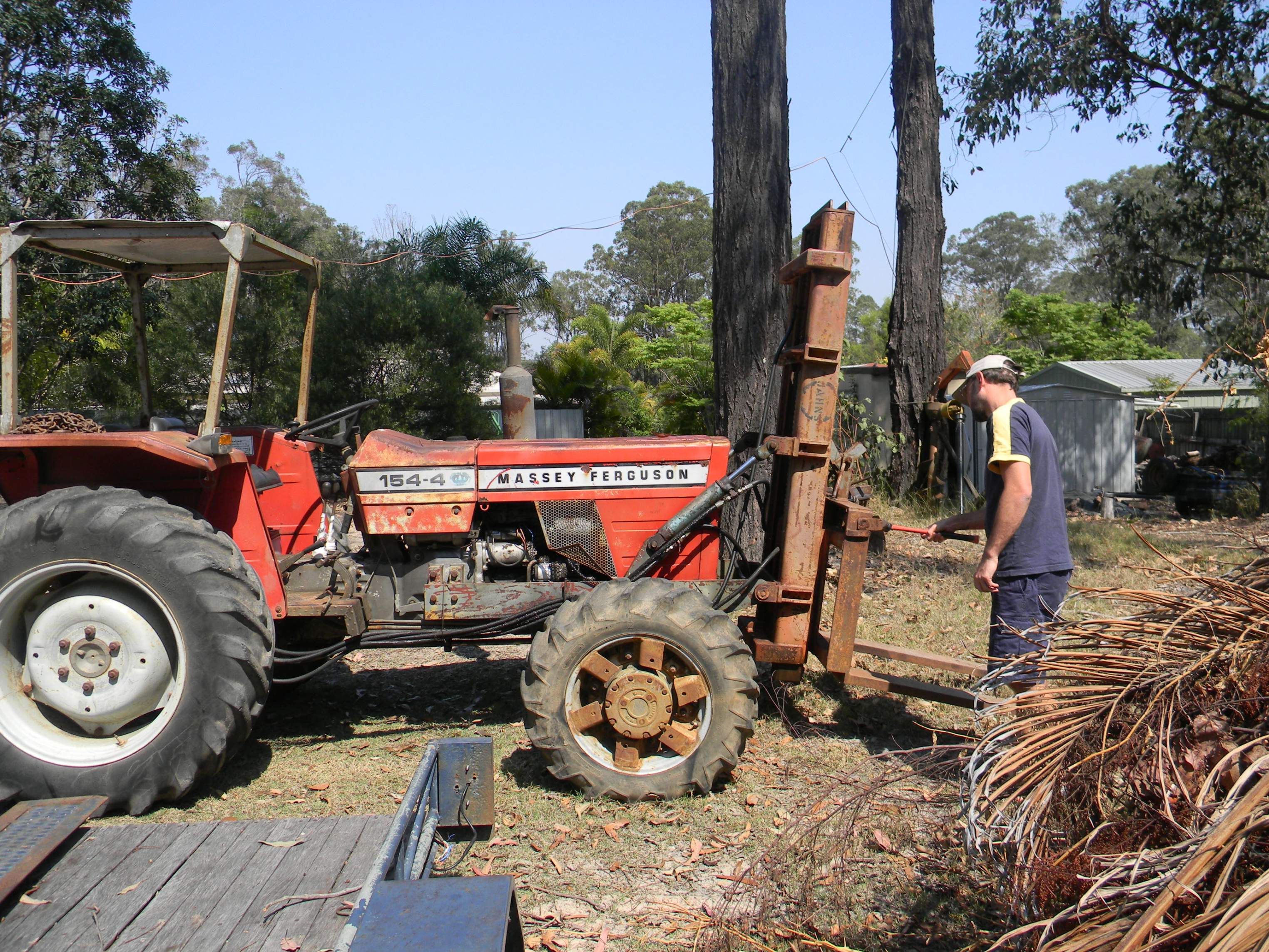

There is a forklift on the front of my tractor. It is designed to lift 1 metric tonne. (1000 kilograms). It will lift almost 3 metres. It has three rams. Two for tilt and 1 for lift.
Not a very clear photo but I can take more if you are interested. DSCN4325.jpg DSCN4327.jpg

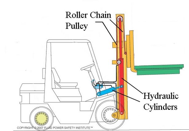

Excerpt:
Cyl and roller chain.
Lifting Mechanism: Roller Chain Pulley
The hydraulic pistons are attached to the two main vertical structures called the "masts." However, the actual forks that carry the load are attached to the main body of the forklift through a pair of roller chain pulleys whose fulcrum is a gear at the top of the mast.
Thus, when the hydraulic pistons push the masts up, the gears on the masts push against the roller chains. Because one side of the chains are attached to the immobile frame of the forklift, the only way the masts can move up is if the gears rotate clockwise and pull the forks up.
The importance of this mechanism is that it allows the forks go far beyond the reach of the cylinders alone. If it weren't for the roller chain pulleys, forklifts would need much taller cylinders to lift loads to a comparable height. Taller cylinders would mean more building material, which would shift the vehicle's center of gravity forward and increase the risk of tipping. Likewise, taller cylinders would demand stronger pumps and higher pressure thresholds.
With a 4 in cyl and 2 in shaft, 48 in stroke, and if you have a 33 GPM pump at 3000 psi, the cyl will extend at 10.1 ips, and take about 4.752 sec to do it.
Cyl can push 37,699, or 18.84 T
A 2 in bore 1 in shaft, at 3000 psi can push about 9,425, or 2.71T
Now to power that 33 GPM pump, at 3000 psi will take about 68 HP.

As you can see from my photo the tractor is a good size and yet loaded with 1 tonne on the front flattens the tyres to some degree and even with power steering, turning is heavy. The tractor becomes light on the rear wheels and I used to put a heavy rotary hoe on the back to counter balance it. 4000 lbs would be better with solid tyres. You will need an equivalent counter weight on the other side of the front axle. This needs serious engineering with this weight.
