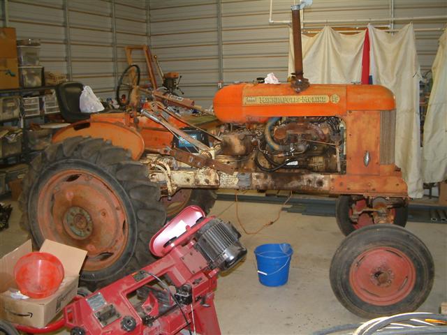

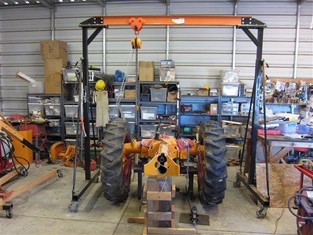

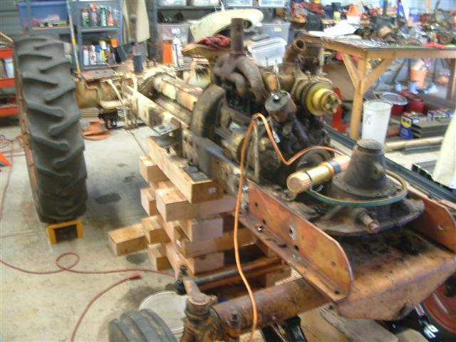

There are levels of restoration:
-Complete restoration--means complete disassembly, replace worn/broken parts, replace leaking seals, possible engine rebuild if compression is less than 80% of spec, semi-professsional to professional repainting, new authentic decals and gauges, new seat, steering wheel. I'm doing one of these on a 1951 Minneapolis Moline BF tractor
