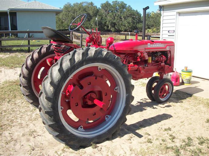

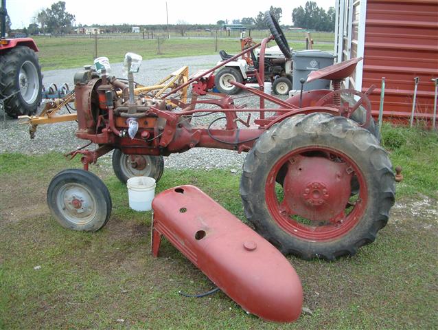

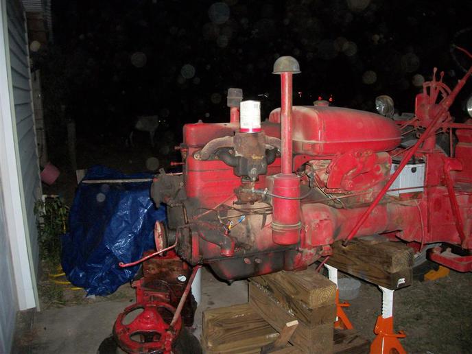

I prefer to buy old iron that's running (maybe not running perfectly, but at least blowing exhaust out of the muffler). But I have my wish list of old tractors that I want in my collection. So when I find one of these I pounce on it, running or not.
Last non-runner I bought was a 1948 Farmall Cub. As soon as I can clear a spot in my shop, it's engine gets pulled and sent to the engine shop for a complete rebuild (low compression on all 4 cylinders). That Bolens GT1453 lawn tractor in the background in the photo is taking up space now (new engine, new seals all around including rototiller seals).

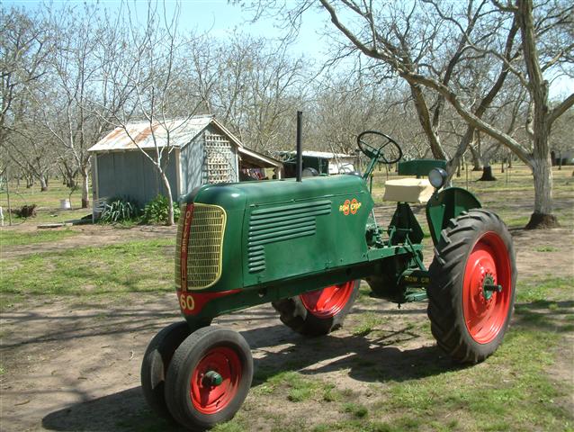

Last runner was a 1945 Oliver 60 Row Crop.
It needed brake relining. Gear oil was like thick molassas when I drained the rear end. Needs new temp gauge. Otherwise it's pretty much parade ready as is.

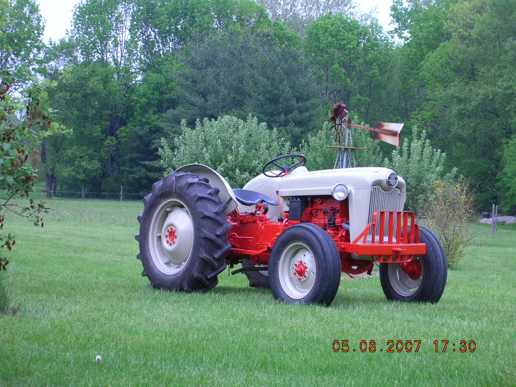

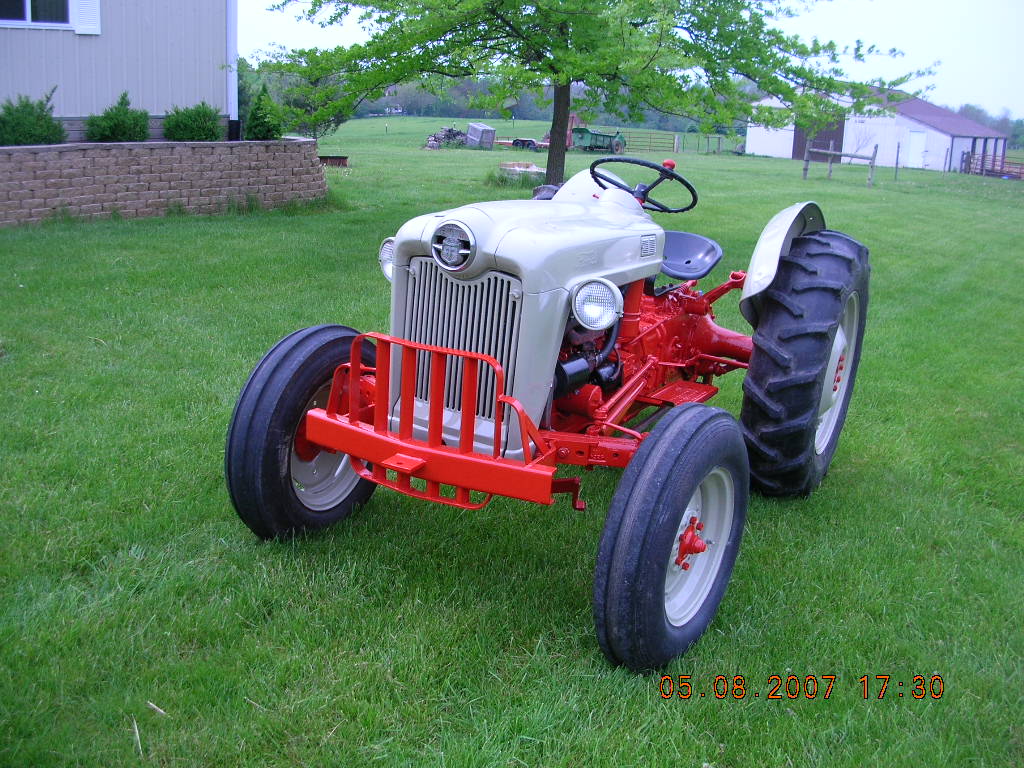

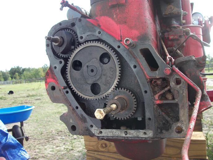

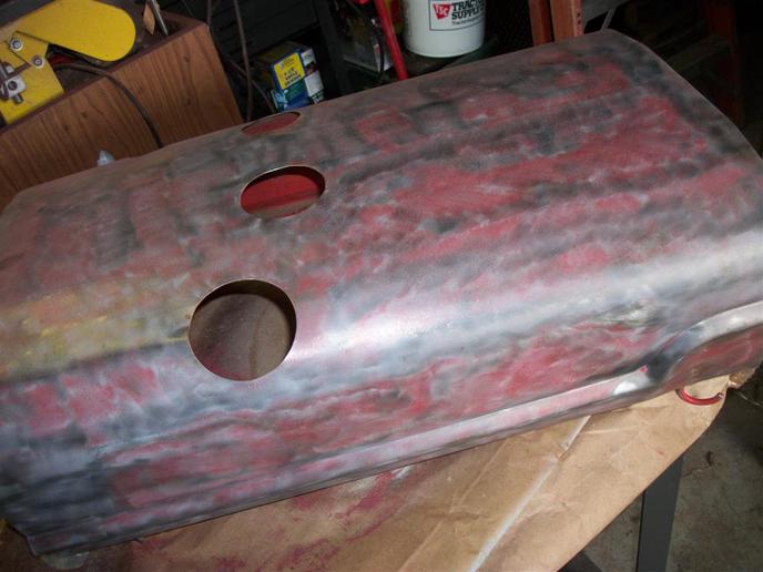

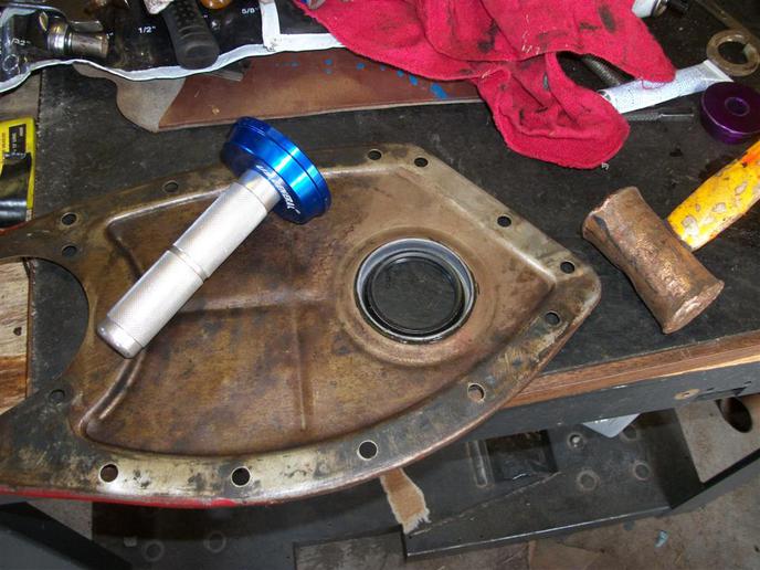

last 'non runner' i bought was my farmall C it had no battery and had been setting.
I hooked cables over to my truck, and actually managed to hand crank it strted 1 time.
came back the next day to get it.. and it would not hand crank ( tried for an hour! )..
when it did run, a steady stream of oil flowed out the place hwere a front crankshaft seal used to be.. :)
was a fun project. had no oil pressure gauge. etc. that 2nd day I came back out with a test gauge on a whip ( gauge on a grease gun hose with box of fittings ).. that's my test gauge I carry to evaluate old tractors.. etc.. had good pressure.. once we drug it off with a donor battery for coil power.. stiull wouldn't crank start / hand start at that point.. starter was all gunked up..

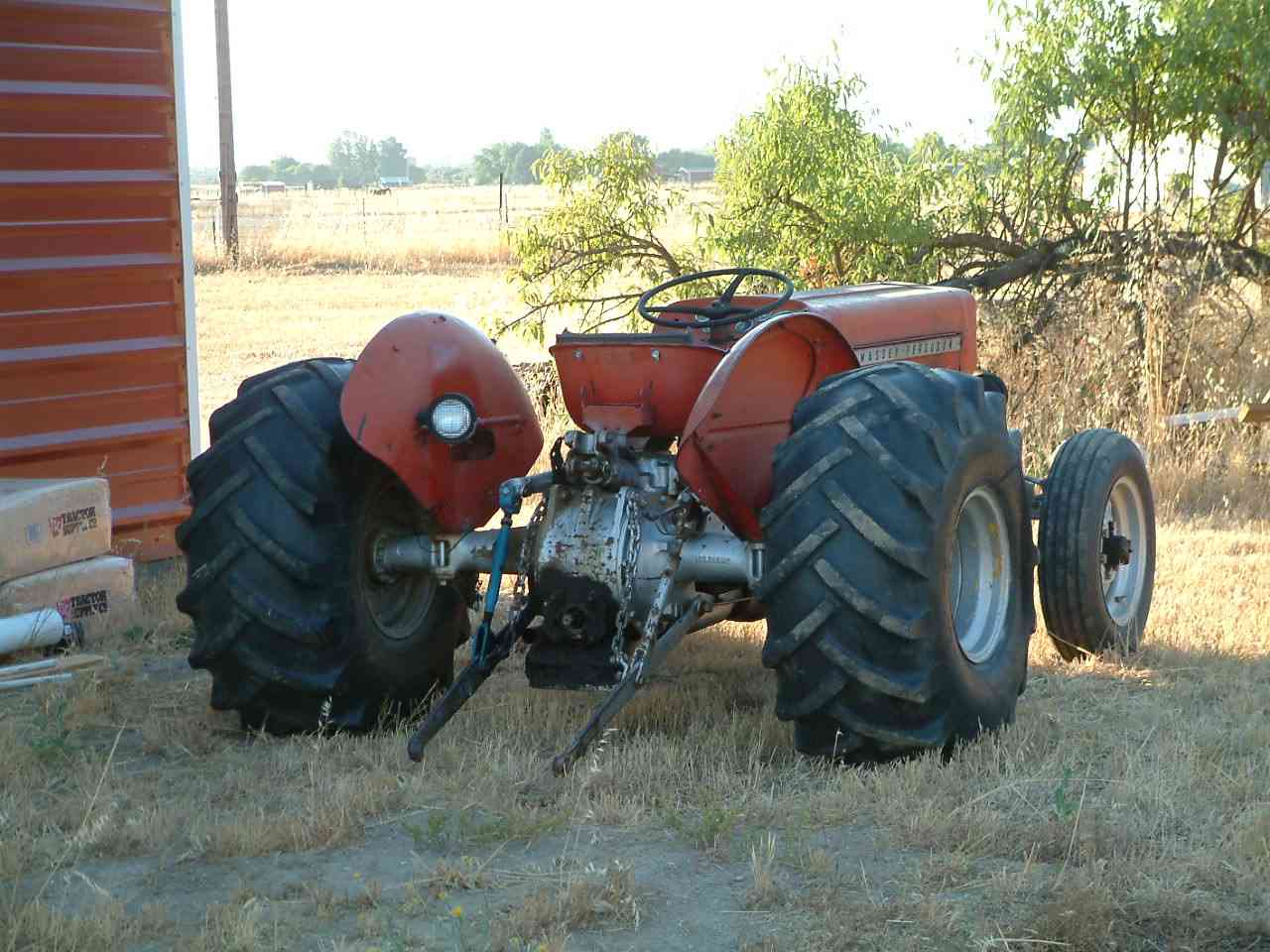

So, I just bought a MF 135, don't know the year as the mfg plate is missing. It is really a kit. The engine is removed and apart. Came with a Ford front end loader.. It's all there. It has the Multi-power transmission and remote rear hydraulics.. Motor needs a bottom end rebuild.. The head was just done, as were the injectors and pump. Weirdly, it has 16.9-24 rear tires (need replacing) and has brand new front tires. I have ordered every part to rebuild the motor, including a new crankshaft, liners, oil and water pumps, etc, etc. Paid $980 for it. I hope to have no more than $3500 into when done.
I own a race car shop and have all the equipment needed to rebuild it.. But my customers are a little freaked to see the tractor sitting next to their expensive road-racing machinery.
So far I've spent $70 on the fuel to go get it, $1500 on all the engine parts and a power-steering kit. The tires should be around $850 for the pair..
It will not get a pretty restoration as it will be a working tractor, but everything that needs to work will get attention. I'm in California so it has no rust. I'll post some pics as I have time.. And I'll keep y'all informed as I progress.

WOW !!!!!!!!!!!
NICE !!!!!

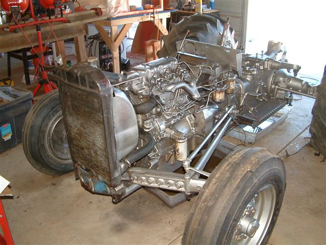

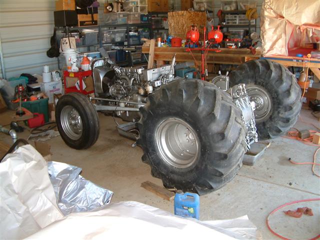

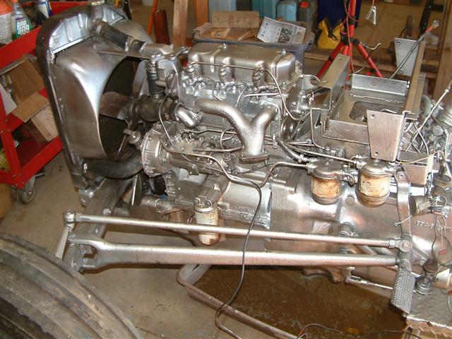

Now that I've actually begun the process of restoring my Massey 135 tractor, I find that it's a very rewarding experience. Thankfully, I haven't found many unexpected surprises. As you can see, it's a work in progress.

there's always surprises once you start taking stuff off and turning bolts.. and hardship cases yet?

So far, it's not been too bad. However, I did have some trouble with a couple of things. The steering wheel was stuck, and I had to cut and crack the hub to get it off the shaft. Also, the draft control spring clevis was stuck on the plunger shaft, and I had to weld the plunger shaft to the cup so I could use a pipe wrench and bar to unscrew it. Here's a picture of the draft spring assembly after I disassembled it.
