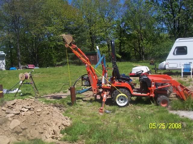

has anyone ever seen a winch that you can make by mounting another rim to the back tire of the tractor, using the bh outrigger to lift the tire off the ground, and use the rim to spool in the winch line? seems simple.
thanks
shawn
I've never seen someone use a second rim for this purpose, altough it would move the winch further outside the tractor, but I have seen it done with a rope wrapped around the tire.

I did this last year to put my well pump in and pull it to lower it.
[/IMG]
It is as simple as 4 threaded rods from one rim to the tractors holes for the wheel weights and tighten them up.
note on BX23 you have to keep the inside of tractor rim ends short.
tom
   / Tractor rim capstan winch?? #13
[/IMG]
tom
That is a neat set up.
Thanks for sharing.

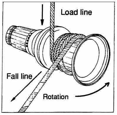

Not to be picky but some of the posters should access there web phone and look up capstan.
A capstan is usually considered vertical, some times horizontal but many times the horizontal unit is called a windlass
It is drive for a rope or cable that is wrapped around the drive drum and is normally controlled by tightening the rope so it will grip the capstans drum, , the rope chain or cable is not stored on the drum, as it is on a winch.
but I have to agree the wheel winch and the use of the backhoe is a very clever idea

I started using it like a capstan but the rope twisted it over it self and got jammed so I had to let it wrap up.
I was pulling 430f of pipe and the pump by my self.
Then lowering it back down after adding another 20 ft of pipe because the well ran dry.

I suppose we could argue semantics all day but it is my understanding that the term capstan refers to the drum to which a rope or wire is wound regardless of whether it is used alone,in a winch,windlass or tape recorder.
