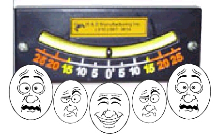

What if there was a black box on the tractor that actually
calculated c.g. position and centripedal acceleration to
determine safe operating area even with different loadings.
bucket height, etc. ?
I did some calculations and I think a small microcontroller
could do this.

But let's say you are on a slope tilted in both roll and pitch
and picking up something heavy with the bucket. Such a device might give a warning BEFORE things got too far.
Such a device is possible. It might be too expensive or
too subject to liability issues to be a practical product.
I just thought about this because I don't like not knowing
when I am in the seat....and because I design such systems for a living.
Any merit, or is a simple tilt meter enough?
   / Tractor Roll Over Accident Safety #16
Les,
I can't speak to the microcontroller idea however, I have come up with a simple addition to the tiltmeter that tells somewhat of a story in real time........see attached picture>
Don

   / Tractor Roll Over Accident Safety #18
Don, I like that tiltmeter!
I think the tiltmeter is a good step, because it responds to
both tilting and centripedal acceleration forces. If you
go around a curve too fast it slings the ball over
showing the vector sum.
Soundguy, you might be right. It might be ignored.
But here is how I figure it: Here I have a shiny new FEL.
I know it is a potentially dangerous so I read up as much
as I can on proper operation.
But when I am in the seat I just have no idea. I never owned
such a thing. 10 degrees might be perfectly fine in one instance and a guaranteed flip over in another. I am tending to be super cautious because I just don't know.
