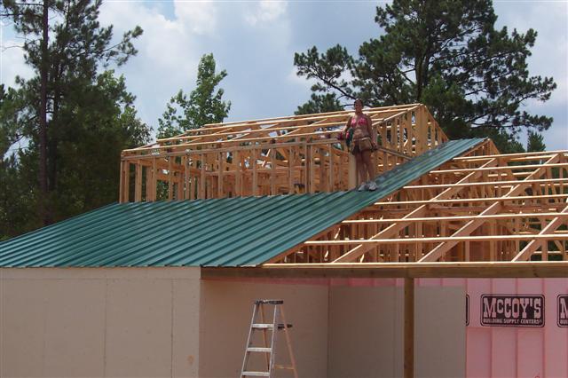

The spacing for the purlins is based on the metal material that you use. If you use a thicker metal, you can space your purlins out further. I bought my metal roof from Muellers, who advises 4ft centers on the purlins. I forget the thickness of the metal off hand. Sorry.
Here's a picture of my roof with my wife on it when we were installing it. You can see the spacings in the picture and also get an idea of how the trusses and rafters tie in together.

Isn't not worrying about a snow load wonderful!! A few folks around our area have put up metal roofs, seems the in thing to do now is go ahead and deck the whole roof with the radiant ply, then put the metal roof on. Another layer if insulation. FYI, I would not do this on a barn.

If you build the roof with OSB/PLY decking, lay felt, then install metal roof you accomplish two important things.
1) deaden the dreaded rain on a tin roof sound
2) keep the metal roof from condensating in the building
Most house builders are more comfortable building in a "conventional" method, then choosing the style of roofing (shingles, metal, tile...).

as just mentioned, condensation on the underside of the metal will be a problem without insulation. we ended up stapling black plastic "under" our lean-to over where the cars are parked to avoid water drippage.
no snow, but probably frost, right? don't forget to get that foundation or footings for your slab below the frostline for your area. up here in kansas, all slab on grade settles unevenly. with large oak tree roots under there? defintely going to be a problem without a good foundation.
ditch the trees. i hate to say it, but trees close to a building a never good. for shade, you want deciduous trees on the south and west with tap root based root systems, not spreading surface roots. for windbreak, evergreens on the north and west. ever cleaned leaves out of your gutters? oak leaves are large enough they really clog things up. plus the root problem plus the falling branch problem. lightning? just not worth it.
don't forget if you go with metal roofing, the fasteners go on top of the ridges, not in the valleys! valley fastening leaks. ridge tops do not.
