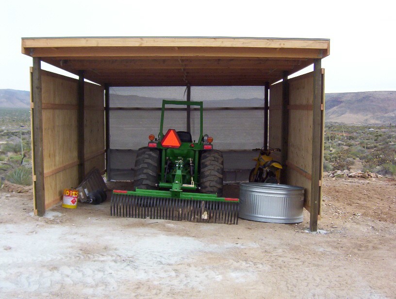

NEW QUESTION!
How tall should I make the inside?
I was looking into the posts options and discovered that 4x4's max at 12 ft. long. This would leave me with a 8 ft. ceiling.
4x6 posts max at 16 ft. long. This would give a 12 ft. max ceiling height.
Taller is better, right?
   / Tractor Shed - Need Framing Ideas #45
I think the new OSB is much different than what they used 10 years ago. I saw a earthquake similator with one shed framed with OSB and the other with Ply Wood and the OSB shed was stronger. I noticed the stuff I have outside in extreme conditions is still rock solid as well not the stuff that would crumble with hand pressure a few years back. I was told that Mold likes OSB and that's why they don't use it in Florida much.
Taller is better, a 10-12 foot ceiling would be find at the walls, I would think.
I think you will be happy with the diminsions, you have. Here is a shot of my inexpensive tractor shed prior to paint. It's only 15x20 and it's fine for what I use it for which is keep the tractor out of the elements.
Cool shed! Thanks for sharing!
