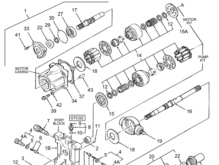

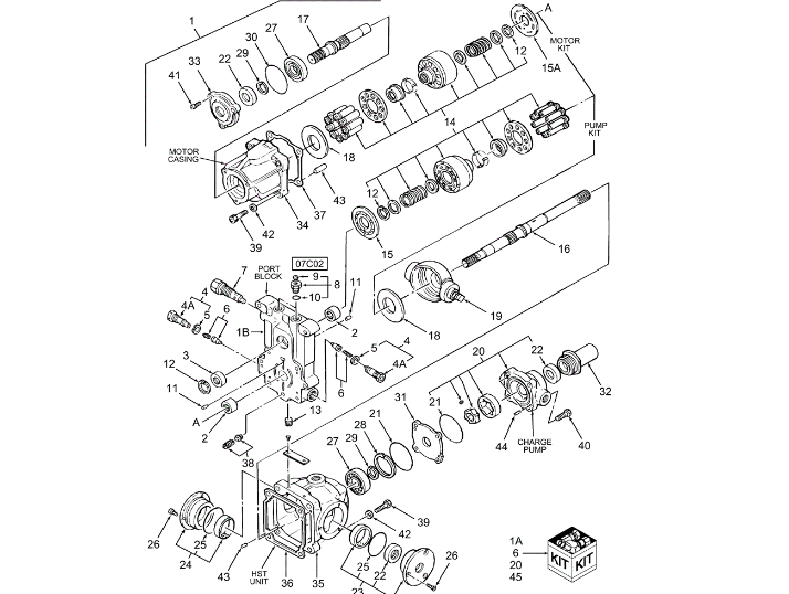

Attached is the HST assembly diagram. The HST actually has two rotating groups. I don't remember taking apart two. I'm not sure why it would have two, and what they each do? Having two would indicate to me that what I posted in the previous post is not true, or at least maybe one of the springs is not strong enough...

Wow, gotta check out Messicks.com tonite....I love breakdown sheets like these cuz the local dealers around these parts hold on to their "Interests" very tightly.....I'm just a repair guy taking work away from them (Until they need something from me:laughing::laughing:...
One of the problems Luke will have with testing on his machine is the Hydro Pump and Motor are one unit....(Cannot run flow meters between components to test).....may have to tear down anyways.....hopefully not but when do you just give up playing and get down to business and dig in...
The unit we rebuilt we changed valve plates (#15 & #15a), lapped barrels,pistons,new bearings, seal kit and go....:thumbsup:
Customer brought it in as basket case and saw nothing wrong with the wear on the critical surfaces....after we were thru it was back to climbing again...his unit had the same symptoms as Luke.....
Best would be to find proper test procedures as you suggested...I'm sure there must be ports to check charge, case and high pressure before he gets too deep...

"Customer brought it in as basket case and saw nothing wrong with the wear on the critical surfaces....after we were thru it was back to climbing again...his unit had the same symptoms as Luke....."
Luke, you have bad wear on your rotation groups......what you needed was a trained eye for the details of critical sealing surfaces when you had this apart the first time
   / Tractor squeals under load after getting warm #97
I took off the clutch housing and removed the HST. The HST looks beautiful inside ...................
I just wanted to take out the HST and open it up to see if there was any obvious wear inside, and to see if there was any obvious problem with the relief valve, but it all looks fine to me...........................
Luke
It doesn't look fine......you have wear on the faces of the piston barrels and valve plates resulting in internal by-pass
the plates can be replaced and the barrels and pistons need to be be lapped.......but if the pistons in the bore of the barrels are sloppy or the shoes on the end of the pistons are loose (even slightly) then new rotation groups need to be ordered
the wear I'm talking about is on the mating surfaces and there should be absolutely no scratches felt with your finger nail......if you can feel ANY imperfections then it needs to be precision lapped (valve plates need to be replaced with new)......

I'm having trouble copying the pix but it's in the post #65.........the eighth pix showing the bottom of one of the rotation groups
BTW, the reason for two rotation groups is one is actually the pump, the other is the motor side

BTW, charge pressure decreases because of excess wear on rotation groups when engaging the swash plate....charge pump's job is to replentish oil on the suction side of the pump (depending on which way the swash plate is operating.....if the charge flow can't keep up with the excessive wear (by-passing) then the charge pressure drops too low, resulting in more wear and destruction of pump parts from cavitation on the suction side
