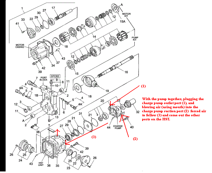

Something I haven't mentioned because I didn't think it was an issue is that when I had the hydrostatic drive out of the tractor, I plugged the output port of the charge pump, and blew air into the suction port (with my mouth), and some air seeped along the shaft into the high pressure orifice of the hydrostatic drive and came out the other ports. I figured it was probably just the way it was and one couldn't expect it to be completely sealed from air since the shaft had to spin, and spinning on a seal or o-ring would just wear it out. However, maybe that's the problem.....
When I took the charge pump apart, I looked for an o-ring and didn't see any o-rings that would go on the shaft, and there aren't any shown on the pump. I'm not actually sure how it seals and keeps the fluid from moving along the shaft.

I am not sure what your gerotor uses for seals with the main drive shaft. I was thinking of using a flow meter to see if charge flow drops off as it gets hot and the oil thins out. If not that the next most likely culprit is wear in the expensive piston pump and motor. Your parts look so good though when compared to something like the rotating group I have shown here. This customer said the system which is a constant speed hydro kept slowing down until it stopped completely. It's hard to believe something can run long enough to be worn this bad. Your system may have worn parts other than worn slippers like this - pistons or barrels for example. Sure would be nice to find something less expensive to repair like a worn charge pump or defective feed/neutral valve - like an o-ring that isn't doing its job anymore due to age.

I still have not fixed the problem, but maybe I'll look at it again this summer. I have a flow meter I'm planning on putting after the charge pump. I'm not sure what it would tell me though, but maybe something will be obvious. However, even if it was obvious that the charge pump was the problem, I'm not sure how it could be fixed as it looks very good and there are no seals in it.
