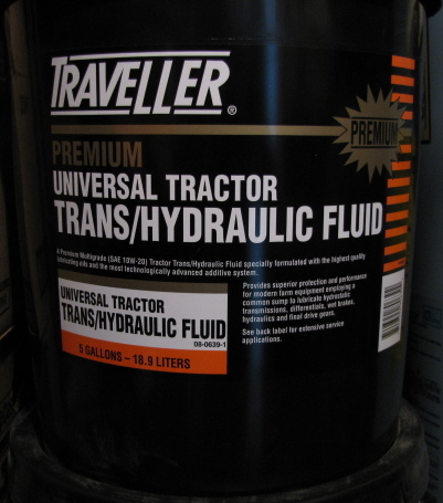

daman1 would you please post a picture of the other side of that bucket photo in post 20?
sure but not sure on what you want to see tho it's as i described(see below)
It is funny you seem to be the only one on the internet that thinks Recommends and not MEETS is on the the Traveller Premium Universal Tractor Trans/Hydraulic Fluid label.
Nothing funny about it, as i said in my above post thats what my store carries,they do have the Renew oil witch looks like bp fick pic but say's renew on it, and aslo like i said above " that could be the new renew UTF oil and they just combined the labels to read as your jug now and going away with the old"
please reread above posts i'm having to repeat too often here...

daman1 thanks. It will help get a time line/location info.
   / Tractor Supply Trans/Hydraulic Fluid- JD 450C Dozer?? #24
daman1 I am here at TSC with the store manager and he states the picture you posted was the older line and the current Traveller UTF does actually MEET the OEM specs stated on the containers.
   / Tractor Supply Trans/Hydraulic Fluid- JD 450C Dozer?? #25
Good to hear, they must have made a formula change,,did you happen to ask about the "renew" oil,or get a MSDS?

Thanks for the link but yea i knew about it, read the pail at my store thats why i stated it meet spec,anyway our store only carries the renew and the premium(my pic) so i'll have to research see if there two different products or what's going to be new at my store,stay tuned......
i agree use the standard in your truck and the renew with the better additives for your tractor.
Won't make a noticeable difference in your hoe because viscosity is showing the same even tho it states "Increased hydraulic performance. Pressure will improve during and after use", i don't know how they came to that conclusion it's still a 10w20 oil,i'd call that part marketing, but the other more important anti wear adds is what you want with added esters(seal conditioners).
