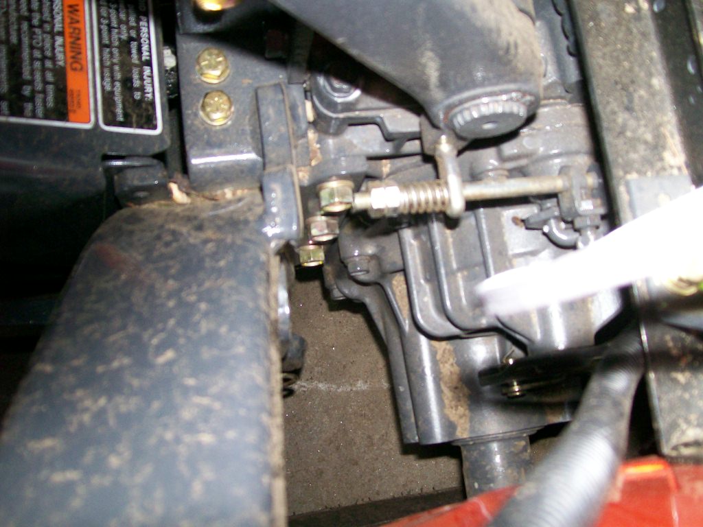

"The only thing I am not that crazy about with the B2X20 series is the 1/4 inching valve. I think I would prefer the other system for using the rotary cutter."
I'm not either! I do usually set the lower limit travel stop when I use the rotary cutter though, and at least that keeps it at a pretty consistant height. It is located under the seat on the right hand side. I lower the cutter to where I want it, mark the shaft, and then set the stop just shy (on the up side) of the mark. Sometimes it takes a couple of trys to get it where I want it, but it is worth the effort. I don't like the 1/4 inching for box blading, or using my middlebuster either. It seems that there is no movement, and then the movement is too much, but I'm learning, and maybe it will get better.
