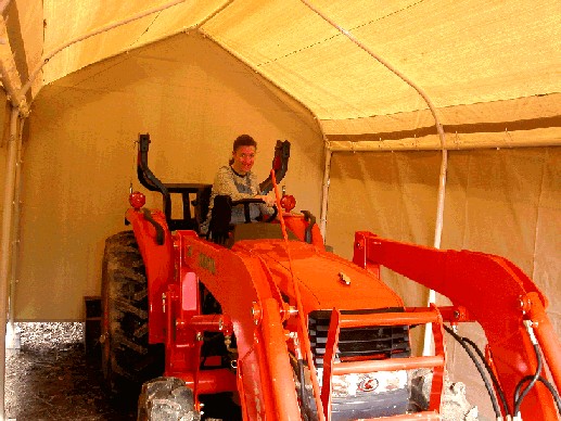

Like I said, MAKE SURE TO ANCHOR IT! I've had the first one of these up for over a year now, had some very heavy winds (50-60mph gusts) and had no problems. Costco sells these for about $170-$180. It seems to vary a little by location. I bought one in Atlanta and one in Nashville. The frame is about 2" powder-coated steel, the cover is very heavy poly that appears to be fiberglass reinforced, and I assume is UV stabilized. All of the cover pieces (top, sides, ends) bungee onto the frame VERY tightly. You can count on pinching a finger or two during assembly /forums/images/graemlins/mad.gif. They are nominally 10' x 20' and about 12' at the ridge. One of the end panels has a zip-open and roll-up door. It does require that I fold down the ROPS to clear the door.

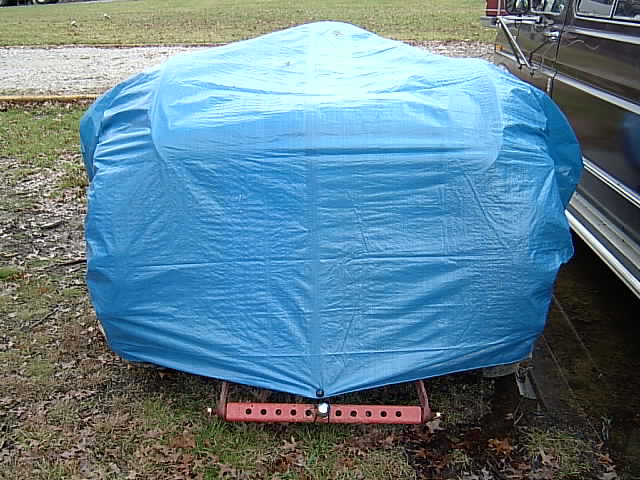

During the summer, I don't cover the 8N at all if I know it's not going to rain. If rain is in the forecast, I keep it covered loosely. Now that it will being staying in the same spot until spring, I've wrapped the blue tarp a lot tighter to keep out the snow. Hopefully I can build that garage next year.
