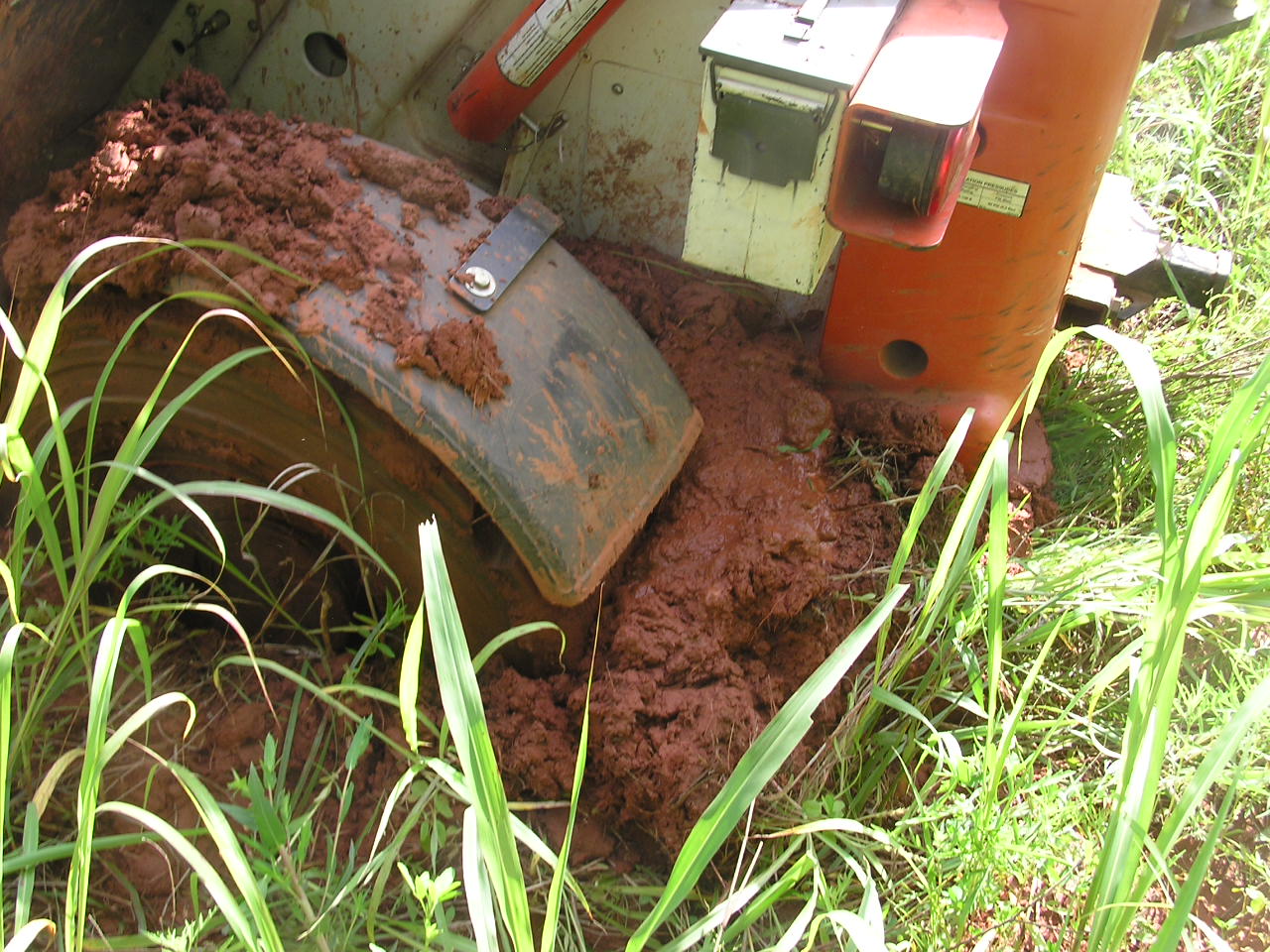

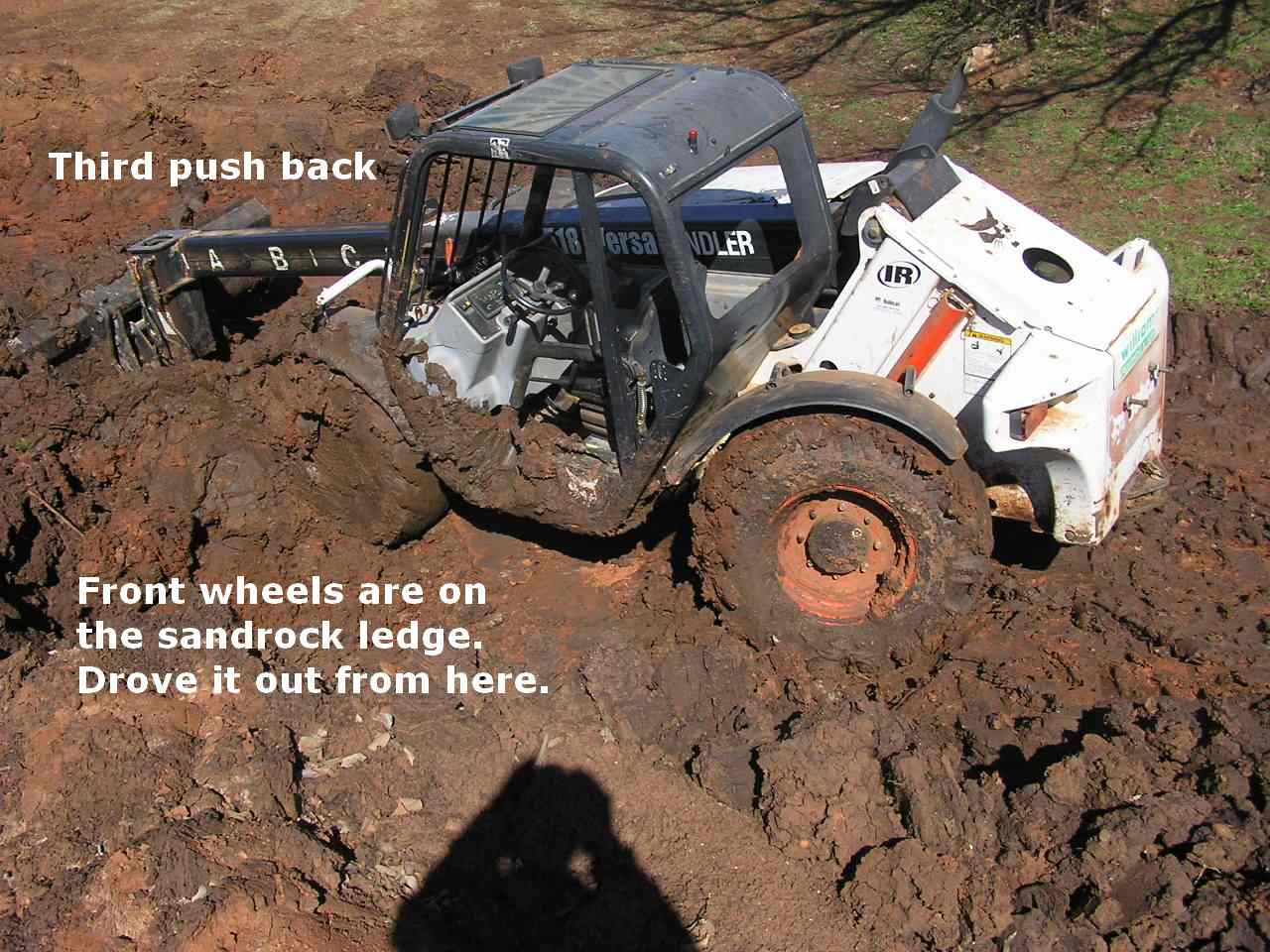

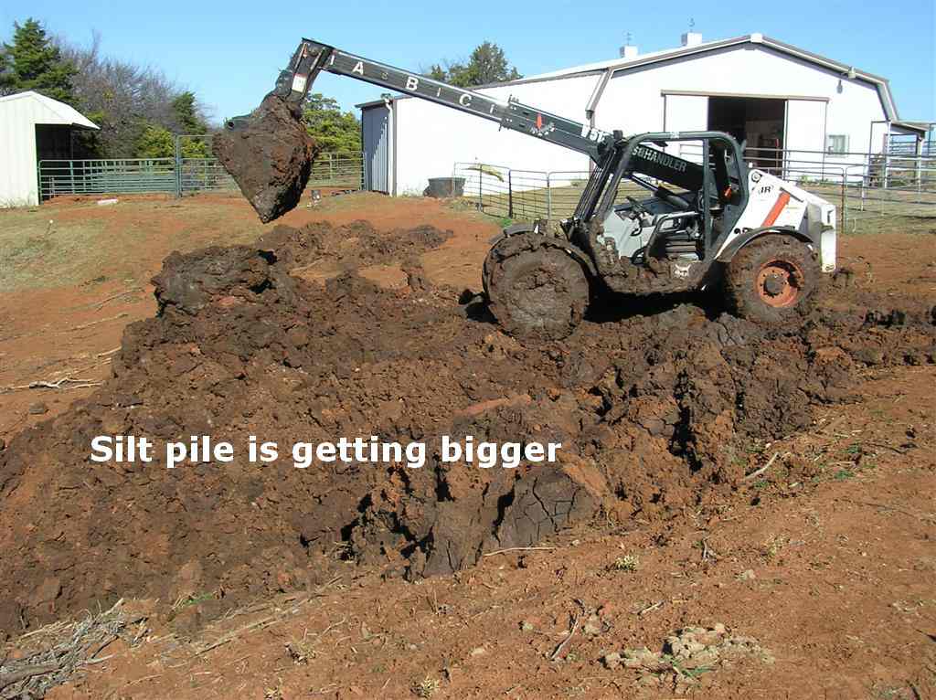

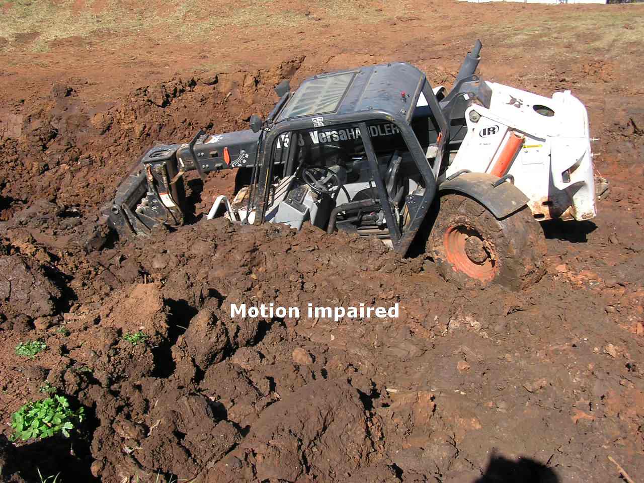

I beg to differ with your beg to differ. The two different compact telehandlers that I have owned are unstuckable! And I have the pictures to prove it. When the axles are out of sight in the silt, all 4 wheels are spinning and it isn't moving forward, it is stuck. Then you retract the bucket, curl the bucket down, lower the boom, pull it into reverse, spin the wheels, extend the boom, pushing the machine backward. Then repeat the procedure until it is unstuck. :thumbsup:
This is the first one, a V518, stuck.
Unstuck. Had to shovel the silt off of the floorboard

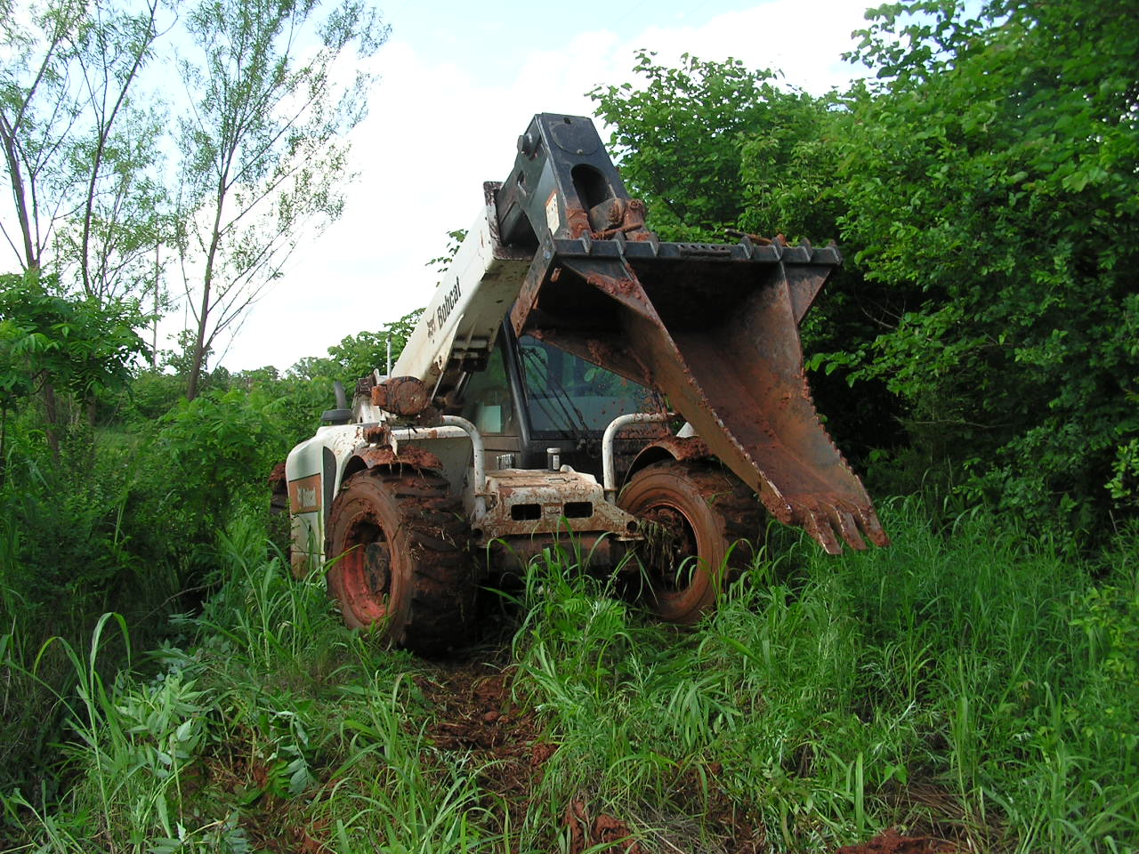

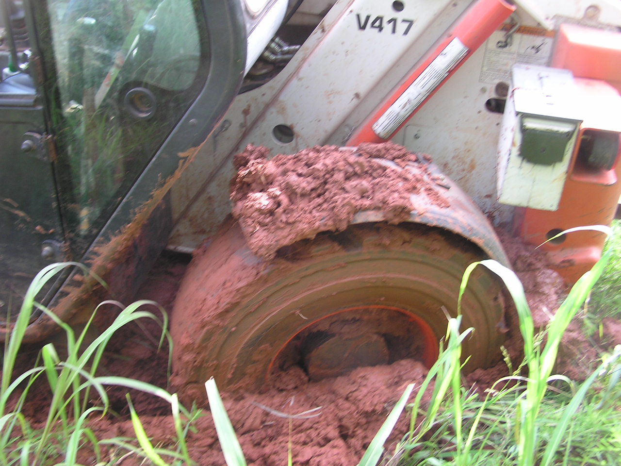

Sold the V518, bought The V417 that I still have. Here it is stuck in the mud.
Unstuck. It pushed itself out!
They are unstuckable!!! :laughing:

The construction company I work for owns 2 of them, and we rent them consistently, I have many hours in them, I assure you they can and do get stuck. I personally had one of our Genie 6000 lb machines in soft clay up to the deck, tried the push trick until I couldn't move. When you push down with the front to dig in you also push down the rear going deeper in soft materials. Luckily enough we had a 30 ton RT crane on sight that popped it out. Had one slide down into a retention pond full of snow one year, no amount of pushing would get it out, boom would push it 20' up the bank, as soon as I picked up the bucket she would slide back into the pond, chains may have saved the day. We had an excavator on site that did the trick that day. I will say they are quite impressive and I would love to own one for moving round bales especially. I do not think they are as durable for ground breaking tasks, have seen at least 2 with major structural failures of the boom, but I saw an excavator with the main boom fail so I guess you can break about anything if you don't care about it. They are definitely versatile. Can't wait to see the price on them get into my range.
