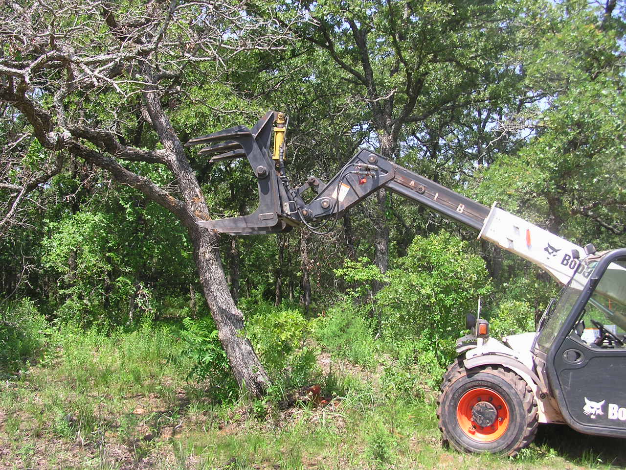

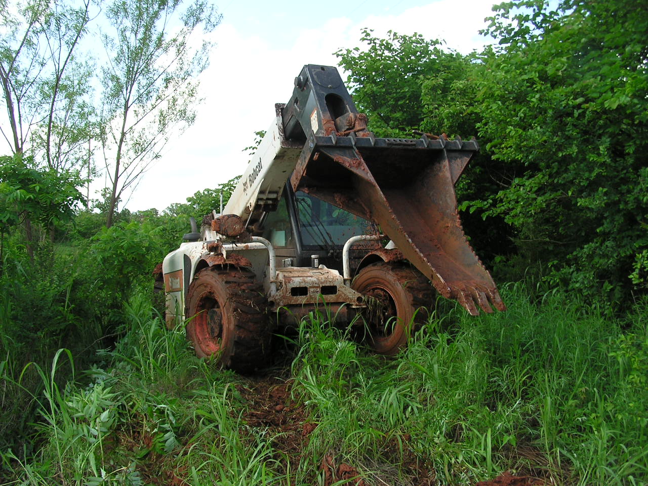

This compact telehandler will do it all. It does cost more, but it's worth it. :thumbsup:
It is only 6' wide, 6.5' high, 13' long, very stable on side hills and "unstuckable".

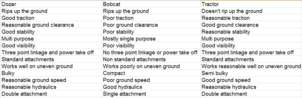

I wrote a list of what I thought were the goods and bads of dozers, bobcats and tractors, so here it is. I have any additions or criticisms please reply.

I would change dozer to single purpose; they grade and push dirt, they do also pull, but thats it.
Visibility? Skid steer and tractor seem reversed... skid steer has good visibility forward where you are working, tractor has poor forward visibility.
I would add road ability; dozer is not road able, skid steer is poor, tractor is medium to good (most run 12-18 mph)

I am talking about a dozer with a front end loader and three point linkage and a PTO. In terms of side ways and rear visibility a tractor is a long way in front of a skid steer. I agree with the road ability and will add it to the list.

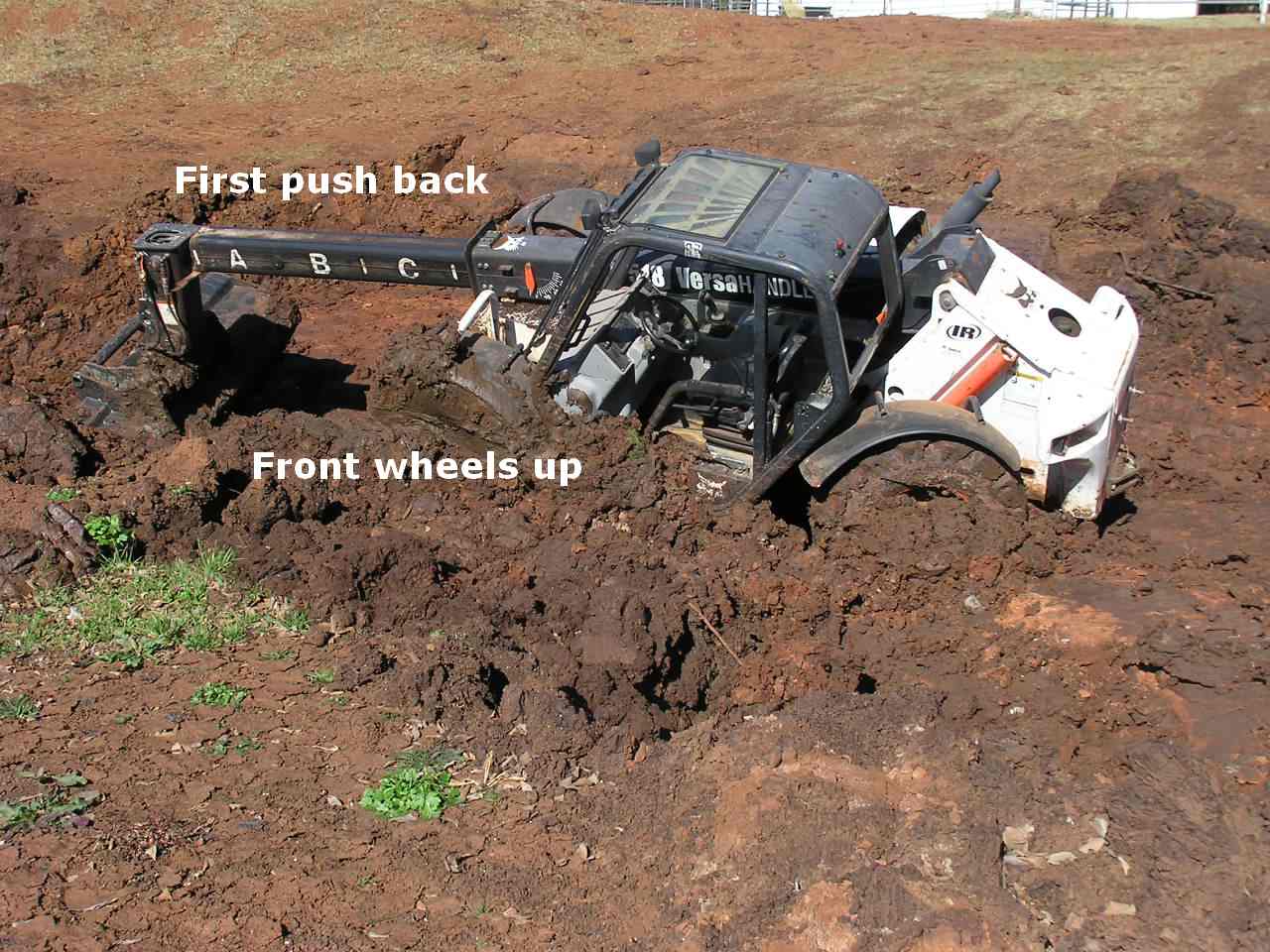

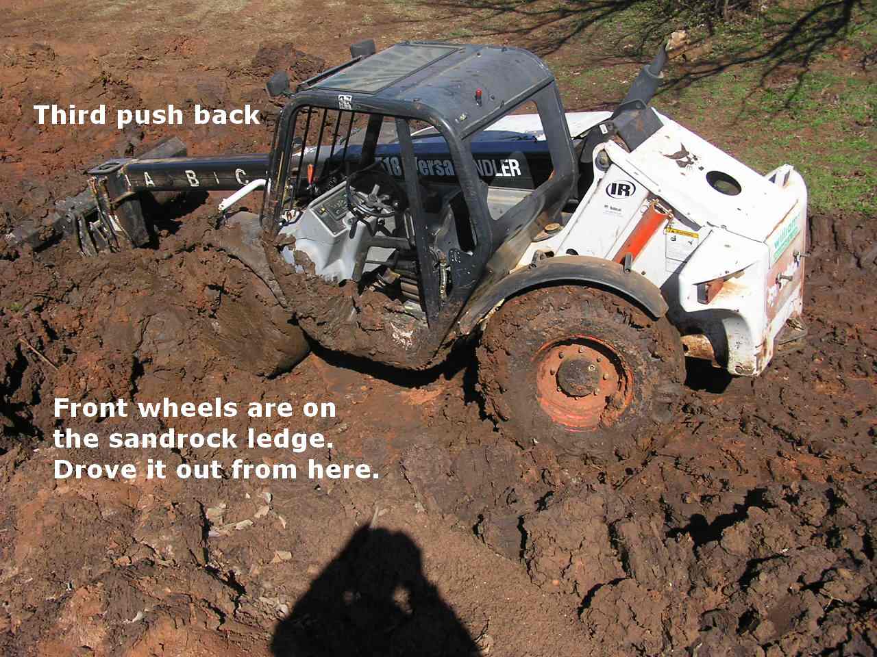

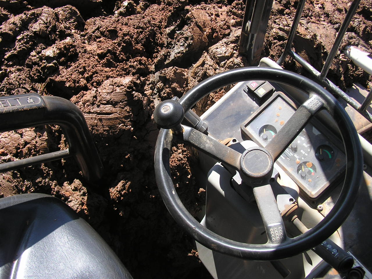

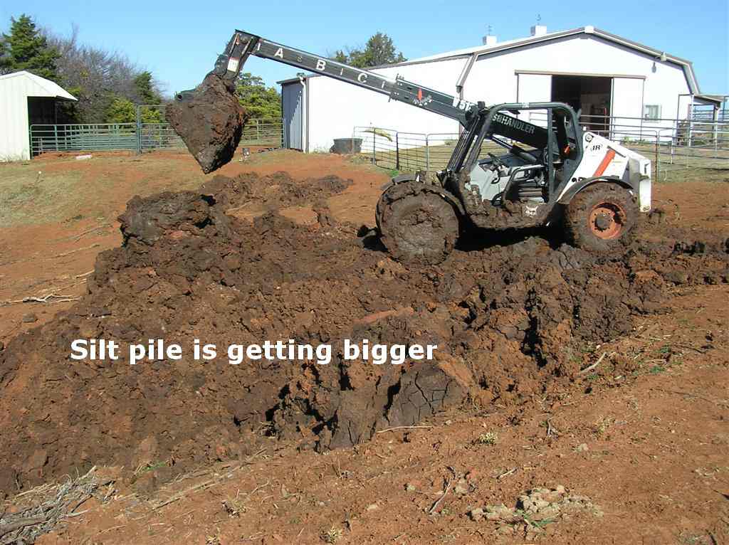

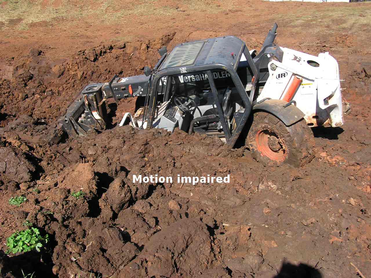

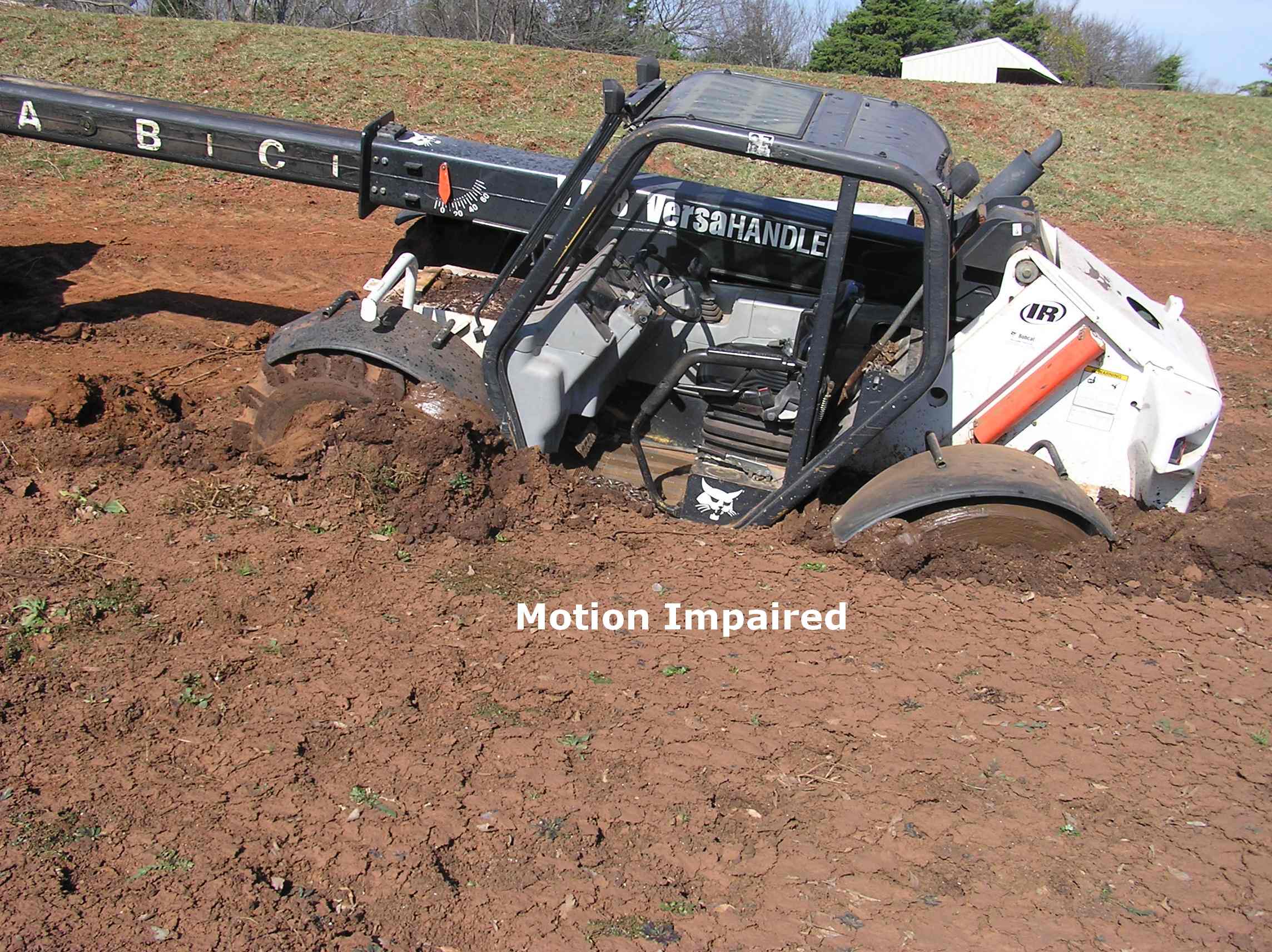

I beg to differ with your beg to differ. The two different compact telehandlers that I have owned are unstuckable! And I have the pictures to prove it. When the axles are out of sight in the silt, all 4 wheels are spinning and it isn't moving forward, it is stuck. Then you retract the bucket, curl the bucket down, lower the boom, pull it into reverse, spin the wheels, extend the boom, pushing the machine backward. Then repeat the procedure until it is unstuck. :thumbsup:
This is the first one, a V518, stuck.
Unstuck. Had to shovel the silt off of the floorboard

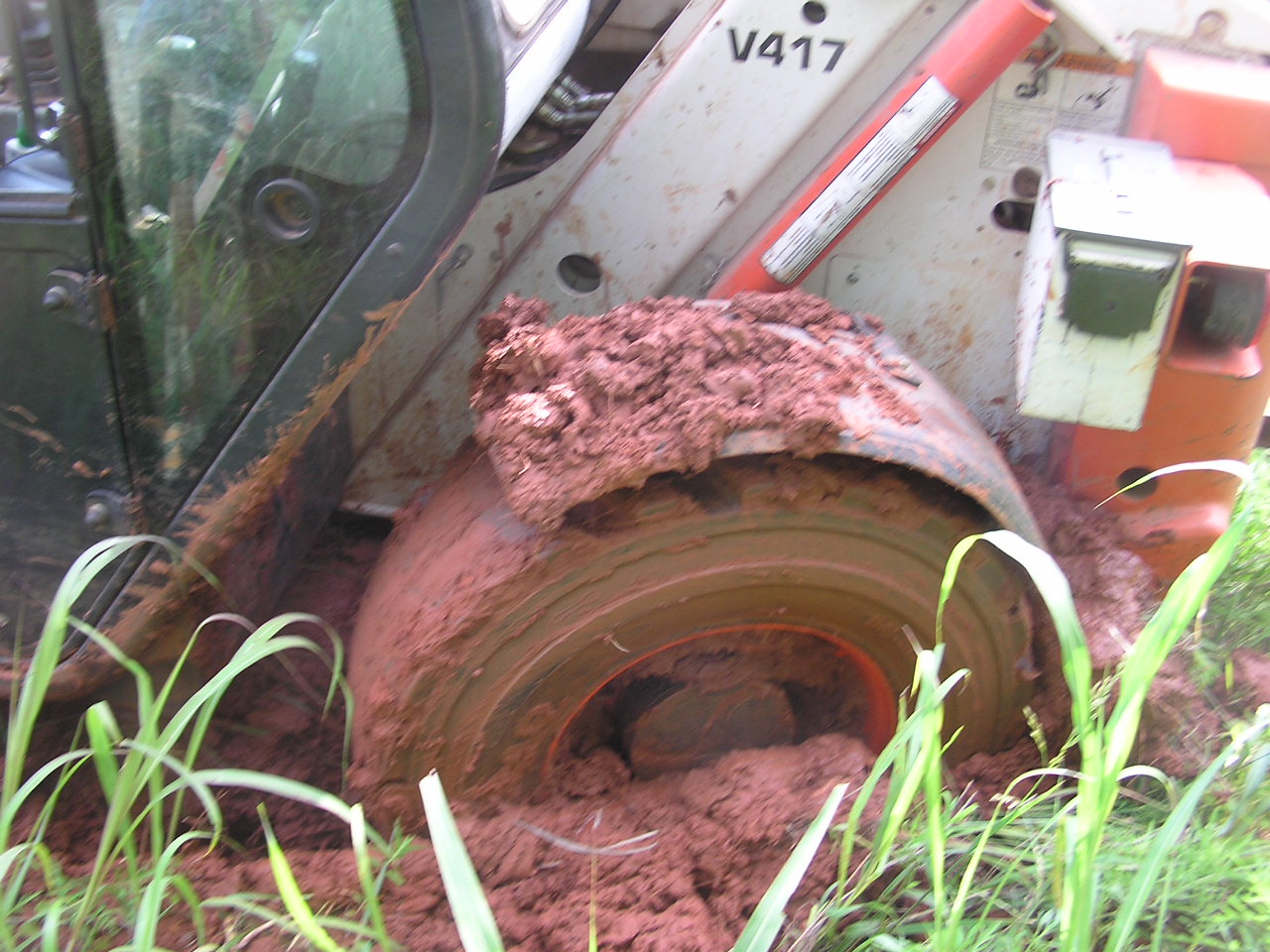

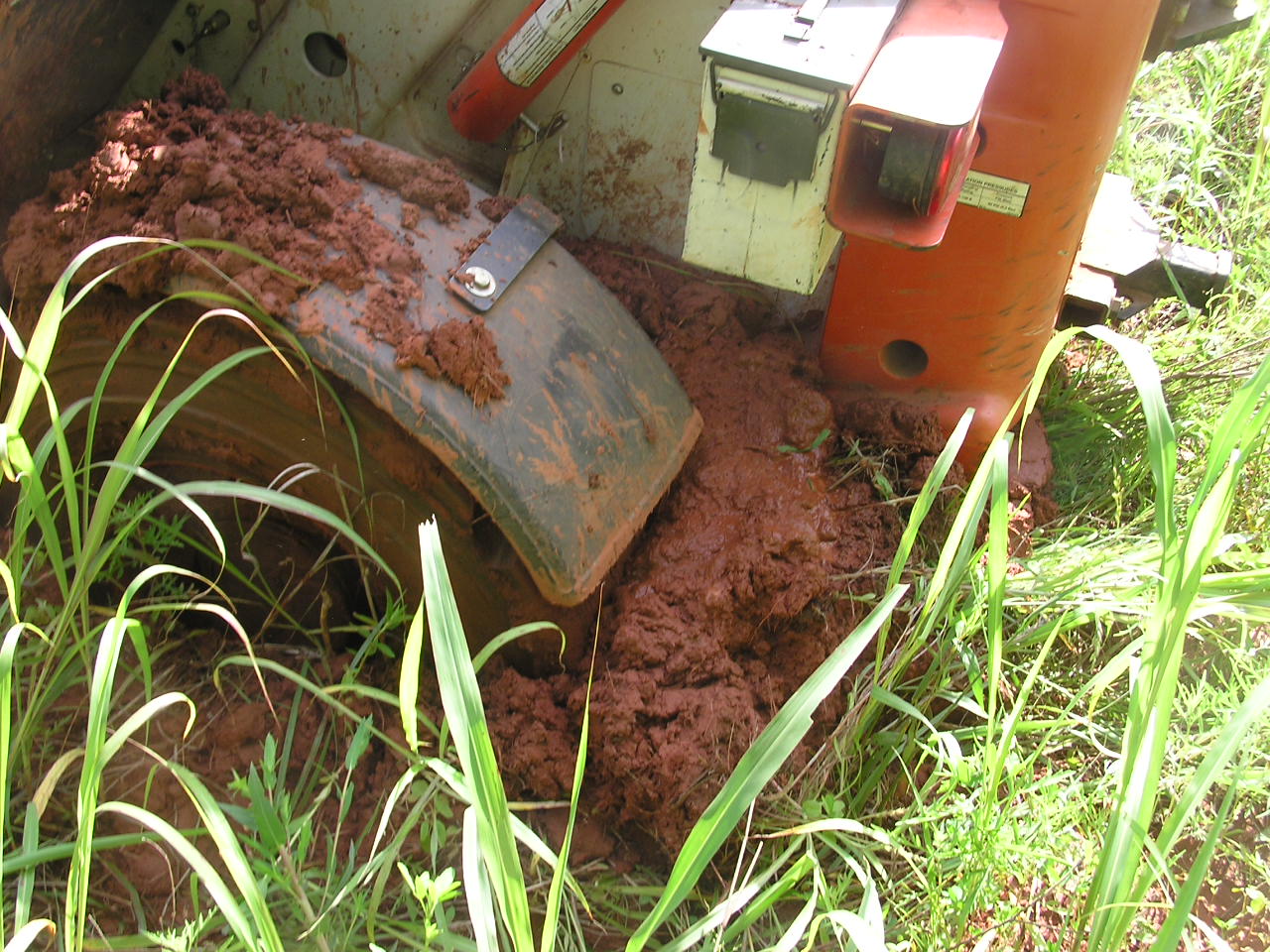

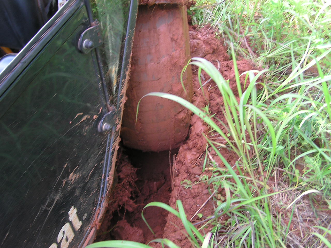

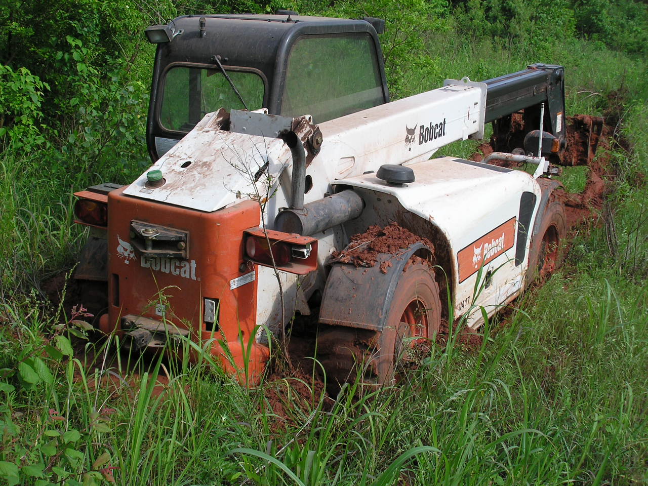

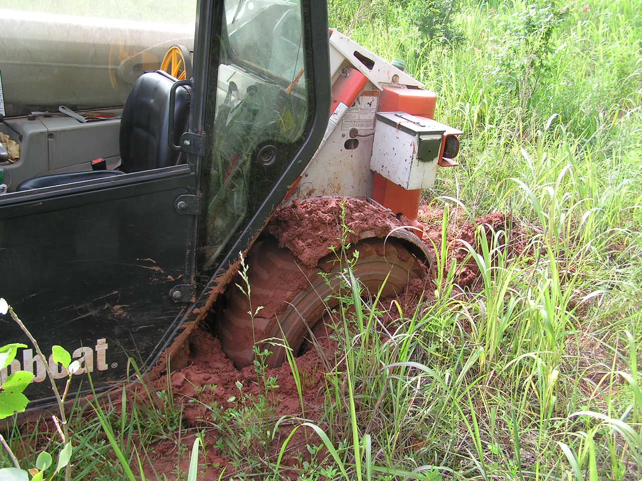

Sold the V518, bought The V417 that I still have. Here it is stuck in the mud.
Unstuck. It pushed itself out!
They are unstuckable!!! :laughing:

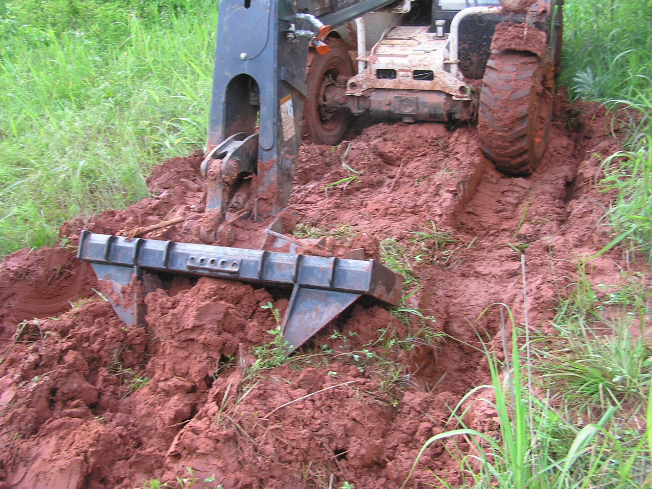

The compact telehandler boom is made for ground engaging attachments. The teeth on my 6' bucket are worn to a razor sharp edge from working in sand rock.
So far mine is unstuckable. :laughing:
Maybe next time it won't unstuck itself. :mad:

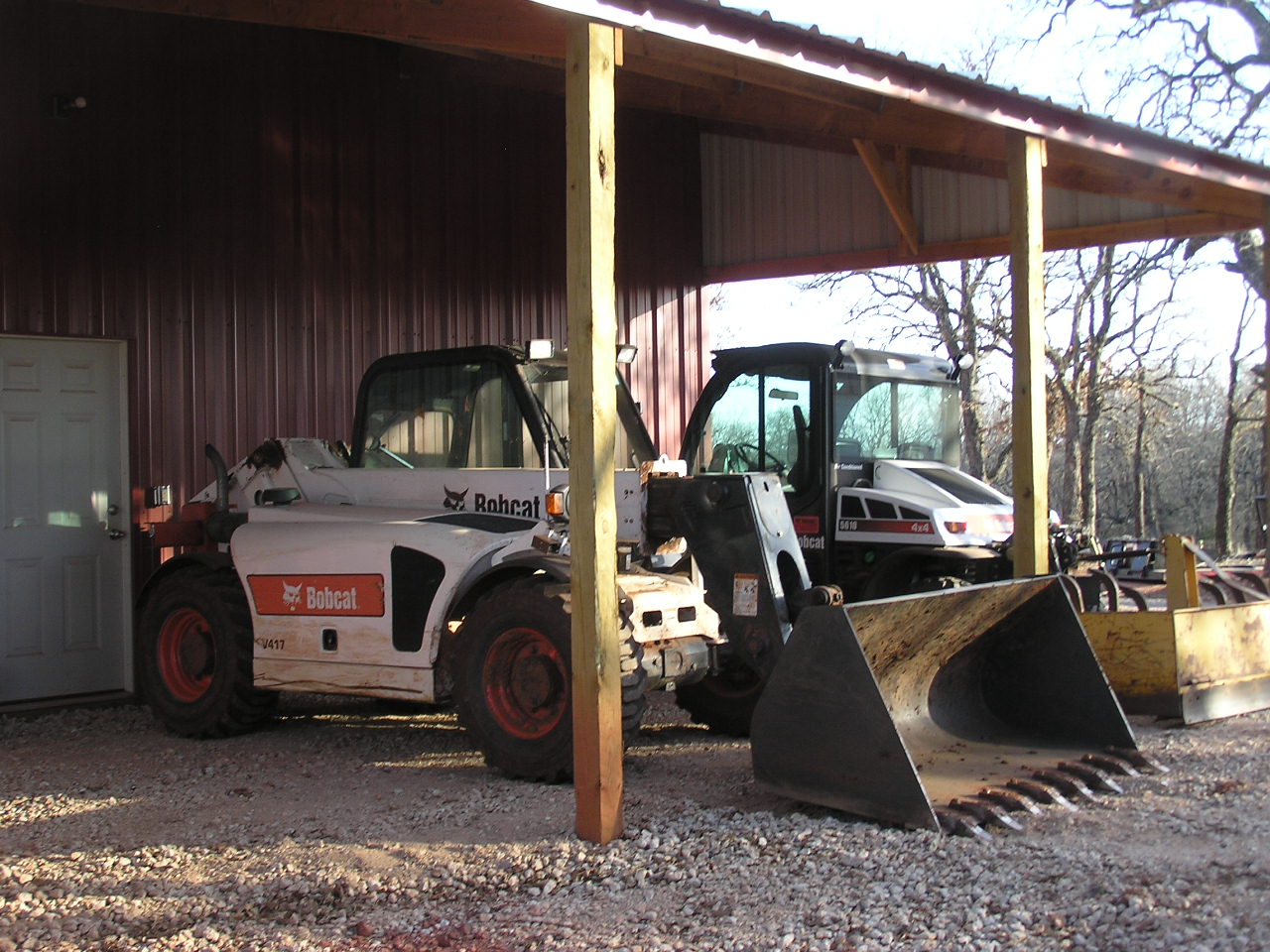

Yep, 6' wide, 6.5' high and 13' long. Top speed is 15.5 mph and it will lift over 5,000 pounds! :thumbsup:
Here it is next to the 5' wide Toolcat.
