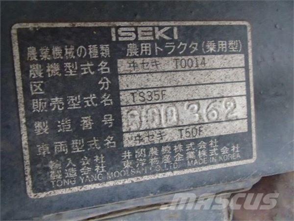

translate.google.com will help you with the japanese. It may not get the translation exactly right but should give the general idea of what the FEL capacity is.
Well, its the other way around I needed. And I didn't think to try, but now, searching for "iseki tractor data 35" -> "isekiトラクターデータ35" found some results, one key one showing the name plate of the same type of tractor, that it is actually a TS35F and made by Tong Yang Moolsan in South Korea for Iseki. http://archive.is/pmj56 iseki-ts35f-nameplate.jpg

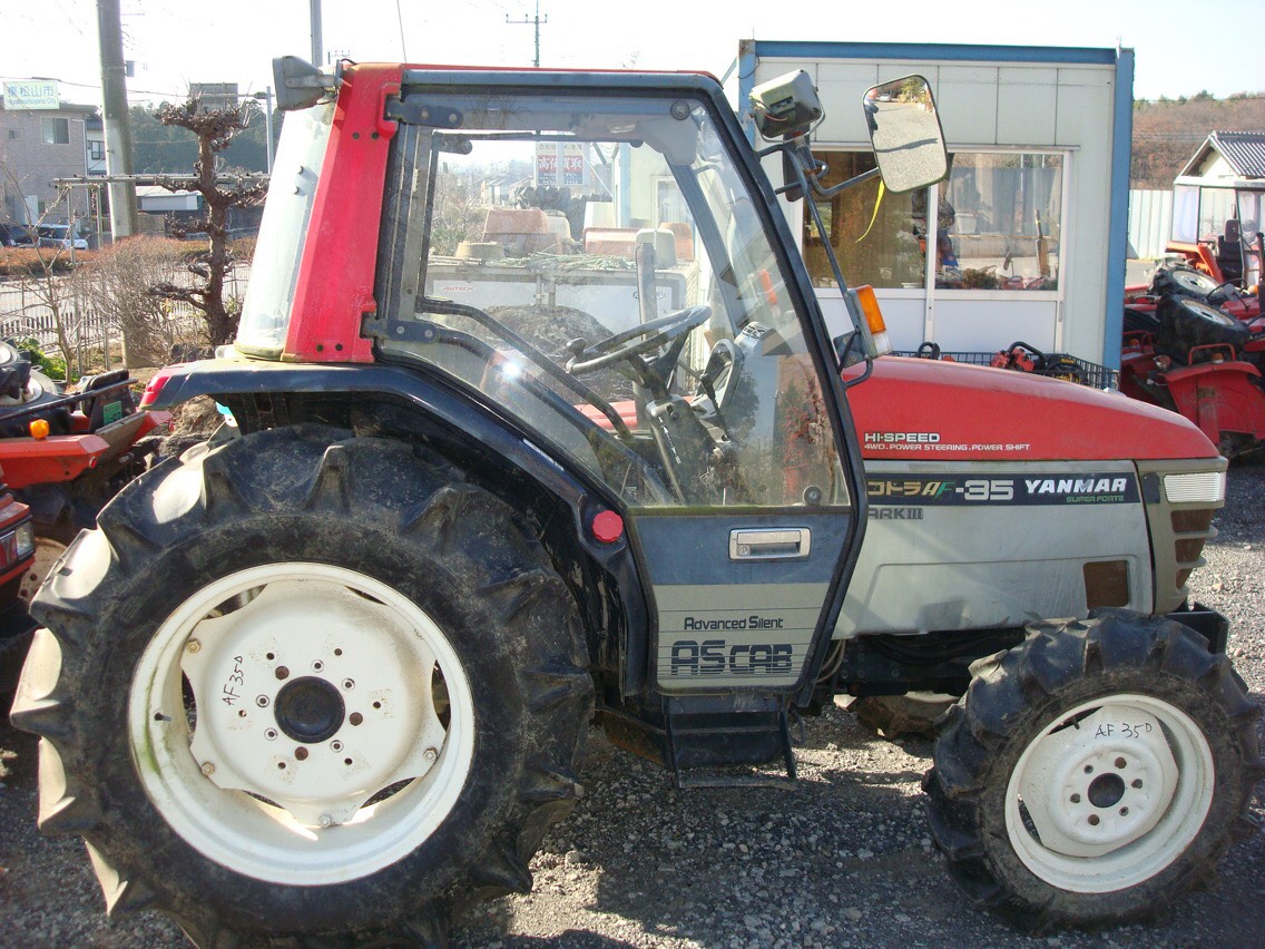

The guy emailed me some photos of the tractors on the way from Japan. Yanmar AF33 and AF35 as well as a Hinomoto NX320 that all have cabs. My wife is convinced that cabs will be safer than roll bars if something happens, and given that we have kids and they are going to want to ride in the tractor (obviously on flat ground, without carrying stuff on the FEL) having a cab with shut doors seems a lot safer too. They'll put some Polish FEL on to them.
Like everything else gray market, specs on these are hard to come by, though I saw a forum post here that the Yanmar AF series was made in the mid-late 90s. I can't find out anything on the Hinomoto. But I feel like the cab would be a good idea after all. As well, during our muddy season, if I want to just leave the tractor parked up the hill in our fields rather than dealing with the steep, slippery path down the hill, it won't leave everything wet.

Your wife sounds like she has been doing her homework on rollover statistics if she is encouraging you to go for a cabbed tractor.
Well, either that, or she doesn't like your cold hands in winter :)
For slopping ground look carefully at how wide the tires can be spaced, it really helps with stability and can vary quite a bit a between seemingly similar sized tractors. A larger frame tractor will generally feel safer on slopes and when you are stacking 750lb bales. Not suggesting you need to go as big as the Zetors, but it is something to bear in mind as you look around different tractors.

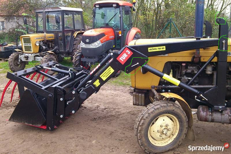

Hmm... it is a good point about aftermarket. The seller I went to see had sent me photos of some of the tractors on the importer's lot in Poland, and googling through Polish websites, I found the one of the importer, and also the specifications of the loader they attach to the imported tractors. It is kind of weak-- 350kg (~750lbs) to full height, which is only 2m (~6.5'). There are some FELs made by a company WOL-MET in Poland with 700kg capacity (~1500lbs) for the same price. I can't find prices for MX, but I see they are also present in Poland.
When I look at tractordata.com for specs on loader attachments-- these aren't available for the grey market tractors, but if for instance the Kubota L2501 takes an LA525 which can lift 2.4m more than 500kg, and weighs less with less HP than the Yanmars and Isekis I'm considering (and the Kubotas I was looking at as well), then I think I shouldn't get a FEL that only does 350kg!
   / Tractor with FEL to lift 550-750lb round bales
#36
Actually, looking at the Polish Wol-Met Tur 3 loader, it looks like there are different positions to set up the loader and change its geometry, maybe to e.g. increase height at cost of lifting capacity? Which if that is why, seems like a neat idea-- one position for stacking hay bales 3 high, another for scooping up gravel and soil.

Yes. As FEL lift height increases, weight capacity decreases.
With max loads on my 1,700 pound lift capacity FEL, usually green Oak tree trunk sections, sometimes I can lift the load only 3", just enough to transport.

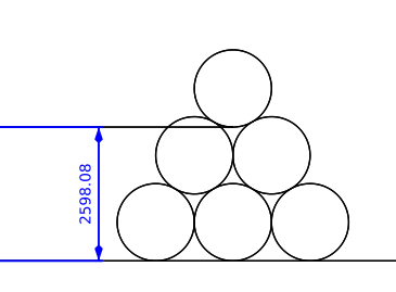

And now, no more guestimating how much the bales need to be lifted. Just a bit of time in FreeCAD, and I have the answer -- assuming 1.5m diameter bales, which the bottom bales must squash a bit under the weight of the next row of bales as well -- 2.6 m, or really a bit more, since the bale spike needs something to jab in to.
