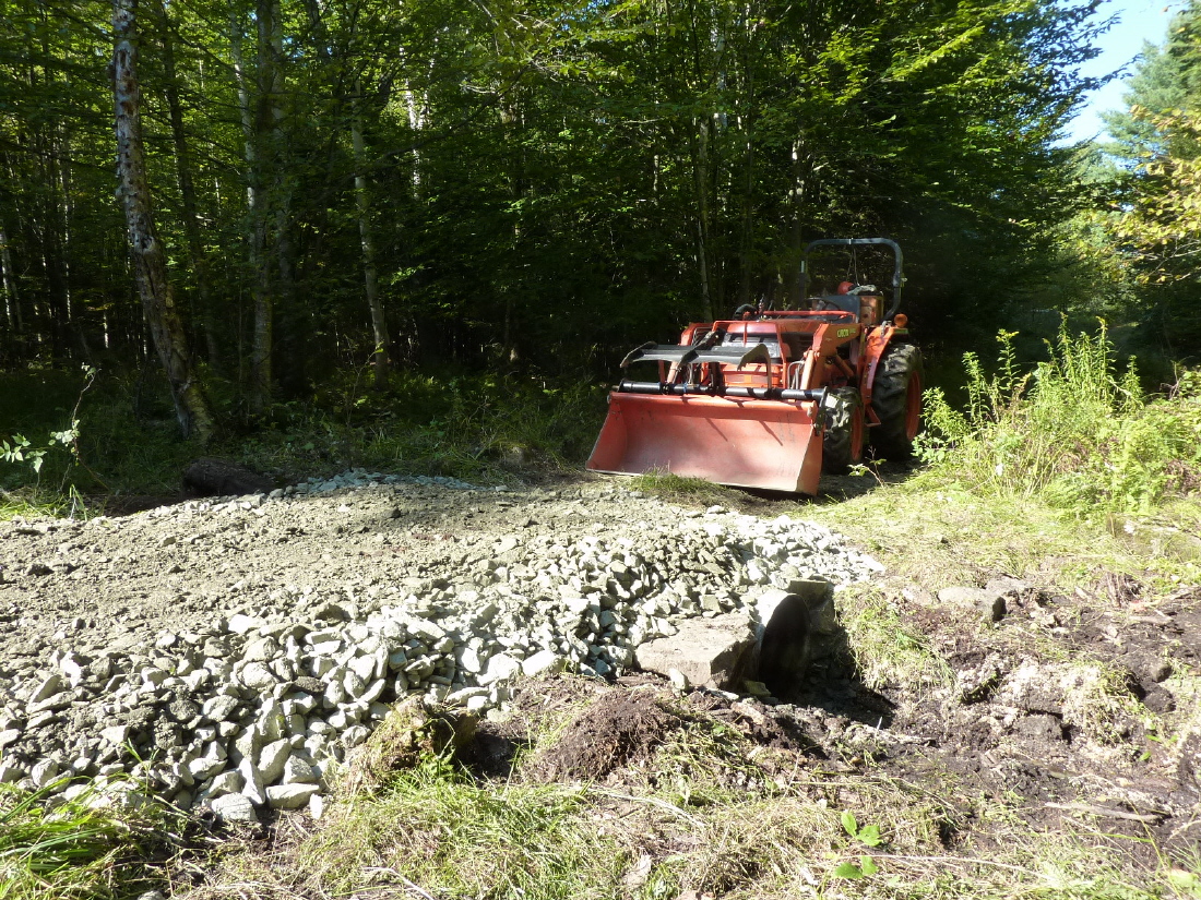

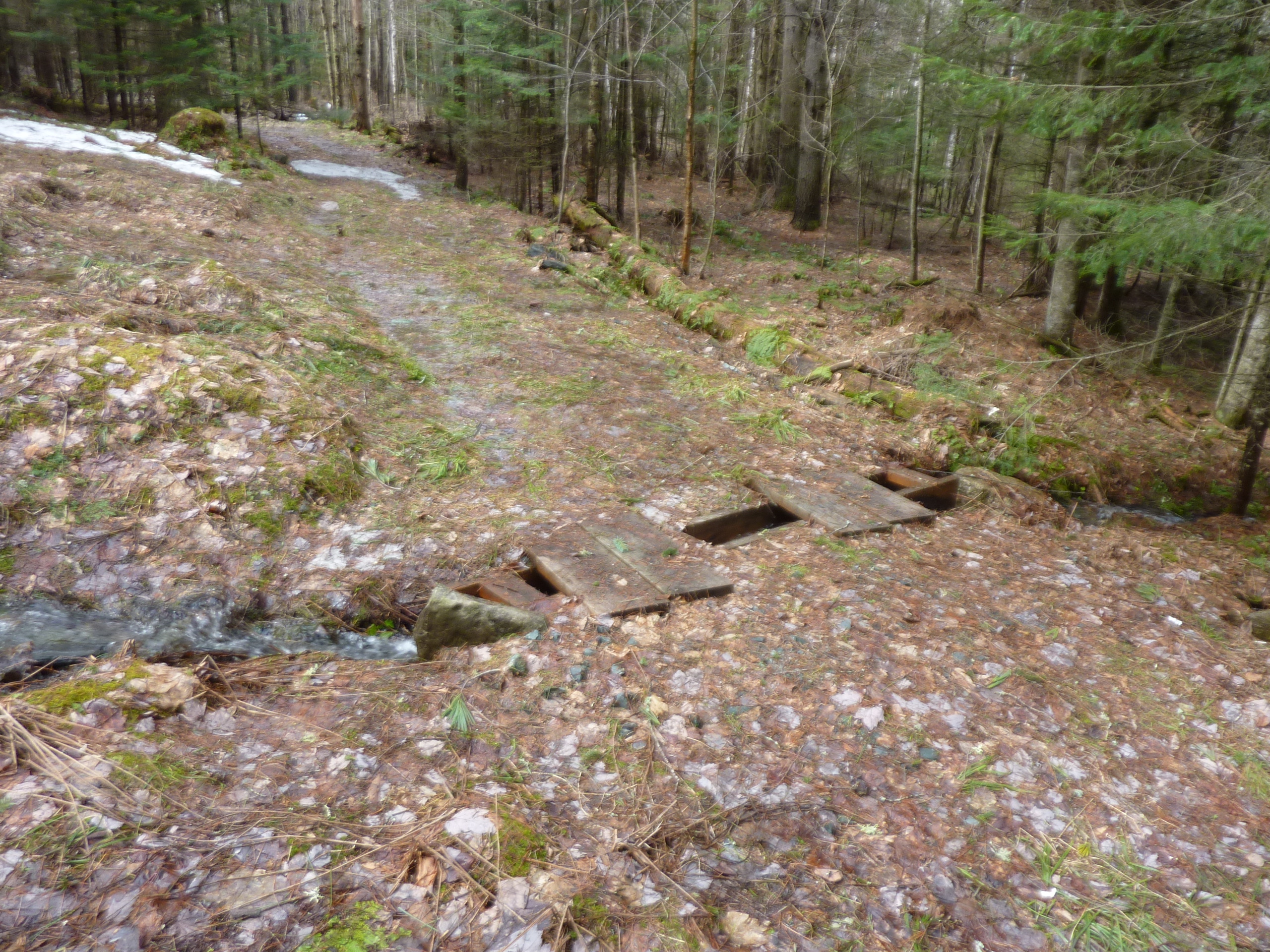

Same here - any water is protected. There is no such thing as your own brook and all water is controlled by state rules. Which are not vague at all. I do stuff like this on my tractor roads to meet approvals for crossing small running water. Bigger water needs a bridge or culvert.
