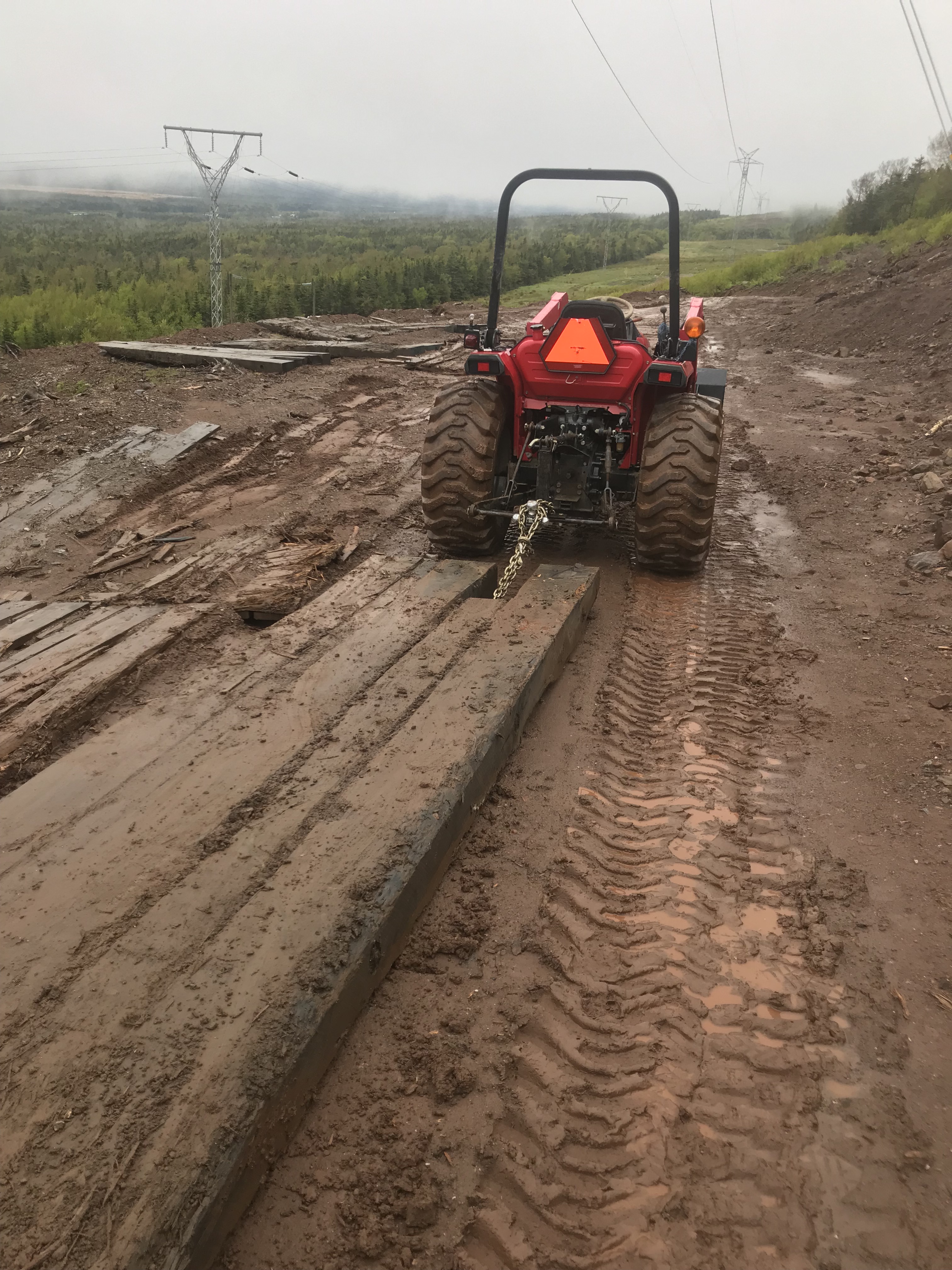

This is a rig matt they would lay on the ground or over soft land when doing the hydro transmission line across the province recently. Extremely heavy dense wood. Not sure what kind. Its bolted together similar to OP's. But one section on each end that surrounds the ready rod is removed so they can hook a chain and lift them around if they need to.

They use those matts down my way to they are for soft ground and drive trans-verse on them, think they are hemlock and creosoted.
