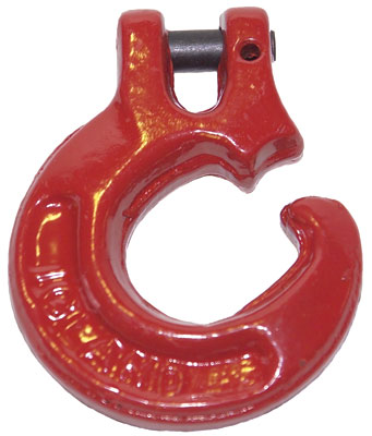

Seemed like he just pulled the release on the brake only before he wanted to pull out some cable by hand. Otherwise the brake snaps back on when pulling the winch rope. It confused me earlier as why would the brake be on when your trying to winch in. I never sized it up much I was rushed to just set it up. The pto issue was bothering me too. I did winch a small birch top and it worked good. The other thing I forgot was to Oder few choker chains! I’m gonna have to make some up with an eyelet at the ends I guess. Can’t find those red open hooks on them around here as people don’t really use them here.

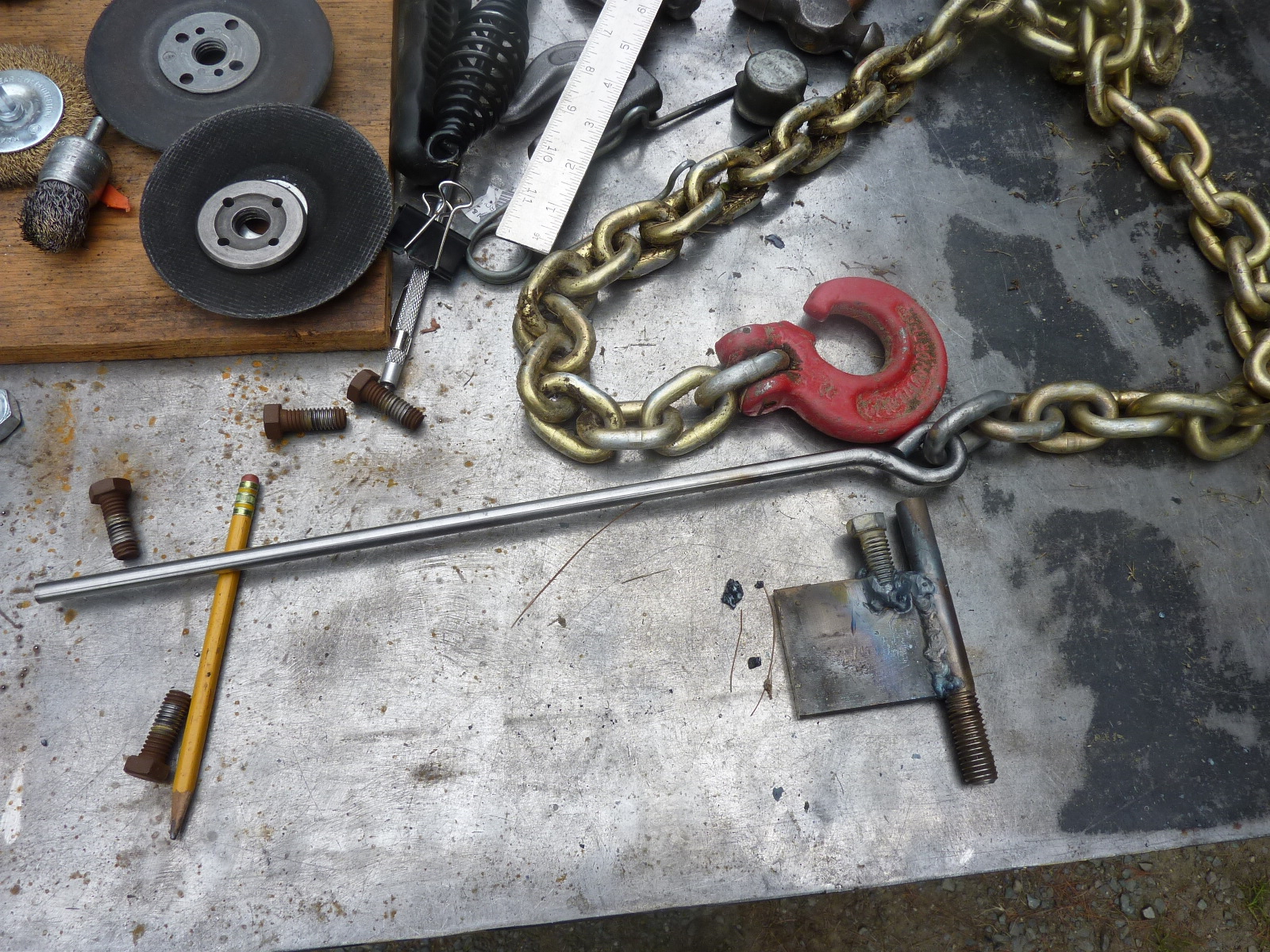

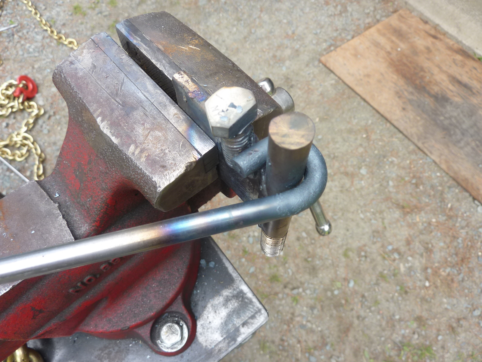

I make mine. I use 5/16" Grade 70 chain and 5/16" choker hooks. I can get them at a local store or on line at Labonville.
I also put a rod on the other end for sticking it under the log when it is tight to the ground.

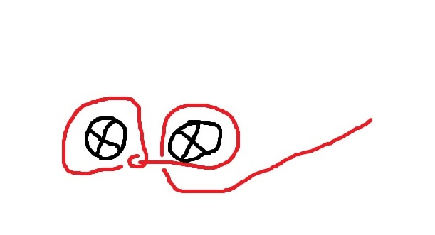

I use 6'8" of chain and have a couple with 8' of chain. One of my 6'8" chokers has a grab hook rather than a piece of rod on the end, that way I can make it as long as I want by hooking it to another choker or piece of chain. For small trees I put two or even three in one choker using figure 8 wraps like this. That way I don't need so many sliders to pull a lot of small trees.
