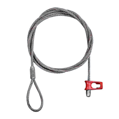

Have you guys ever thought about trying cable chokers they’re a lot easier to deal with, plus you can push them through stuff. This is a cat style choker my personal favorite since it separates the main line from the chokers.
