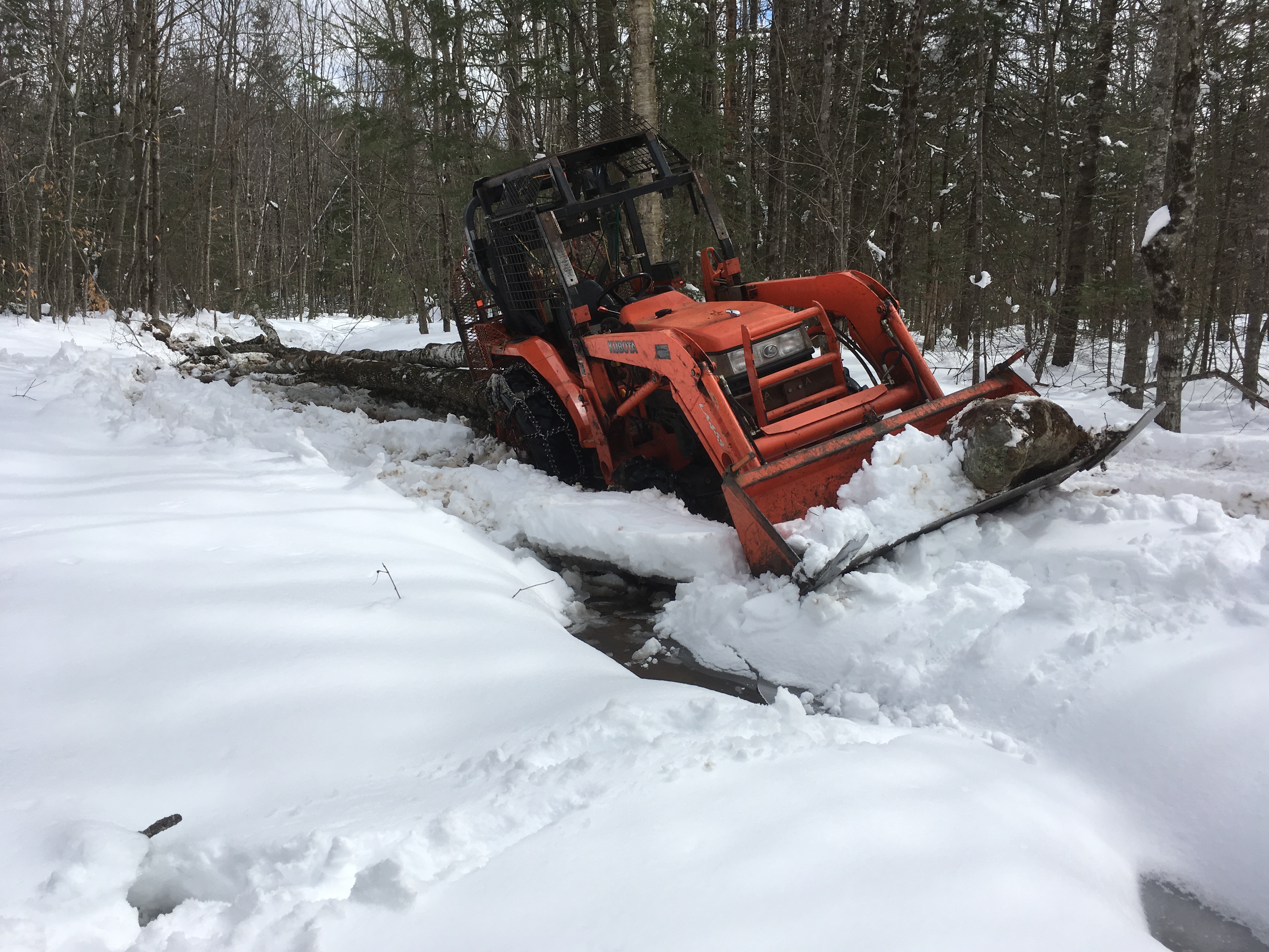

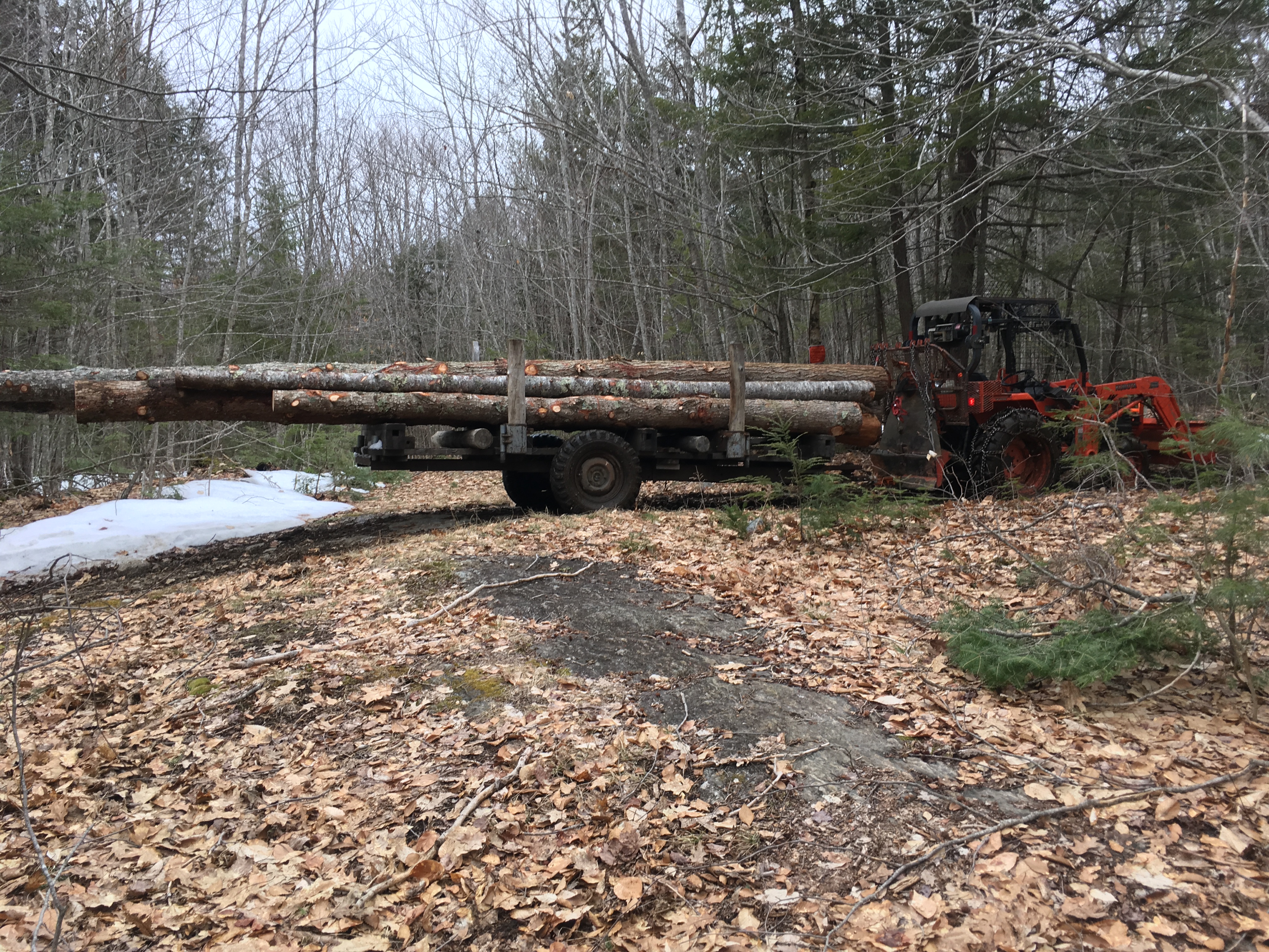

Time for a commercial break, the chainsaw episode will continue after this brief message............. Loaded>>>>View attachment 549135 View attachment 549136
Trailer logging - YouTube <<<<<<This is what this same place looked like 5 weeks ago>>>View attachment 549134
Nice load on that trailer OldP. How do you load it in your tight woods and with one tractor. I am trying to figure out how to use a trailer more but I have to many narrow dead end trails.
Love your tongue weight adjuster or holder downer. Or did you just fall in love with that rock and feel a need to bring it out :laughing: Or maybe you have a draw bar under the winch and not using a ball on the winch. Hard to see on my screen.

When I load the 24' logs, it goes something like this, keep them low as possible, find the flattest ground I can and clear the least amount of trees that I can get away with. Sure another tractor would be better or trailer with loader, but either way a trailer will keep my logs cleaner and hauls a lot easier, instead of dragging one tree, with a trailer I can haul three>>>> Logging - YouTube
"Love your tongue weight adjuster or holder downer" :thumbsup:<<<<Yes isn't that some Yankee ingenuity, didn't think anyone would notice that, after I loaded the trailer, the tractor had a feeling of light on the rear, then as I was going threw a run-off brook heading out, almost out, the trailer came unhooked and the tongue was over 2' in the air, first time that's happened with three but cuts on front, but I started thinking since two of these trees was cut down last summer, one was blown over last Oct, with the tops not cut off, the tops must of sucked out most of water from the buts cause the tops still had some green on them.
Sooooooo before I could hook the trailer back on, had to get the tongue down without speaking in tongues, I see this rock right next to trailer, loaded it on the trailer and down it comes, imagine that finding a rock in the woods, how rare is that, your right rocks are everywhere in New England...........

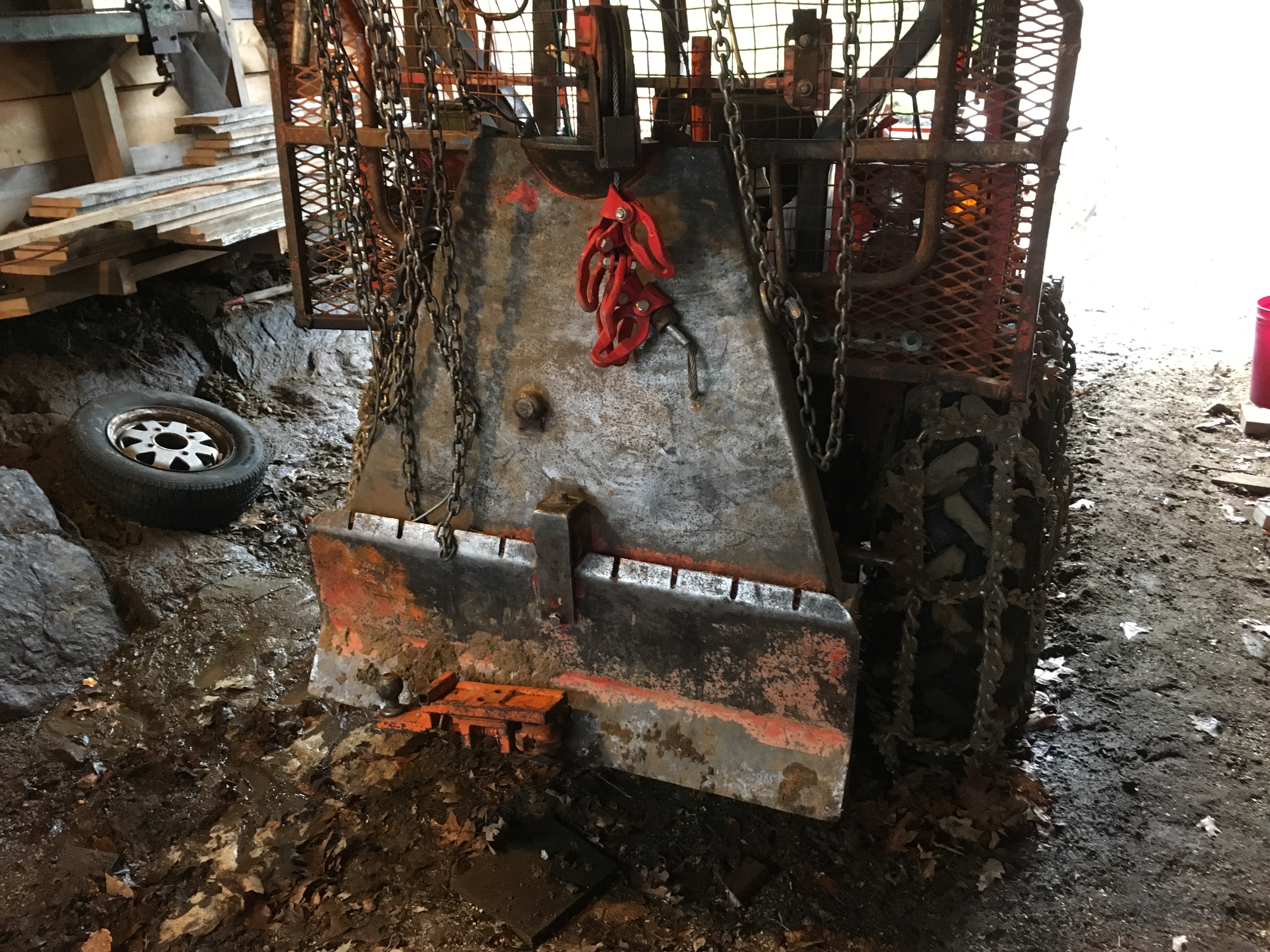

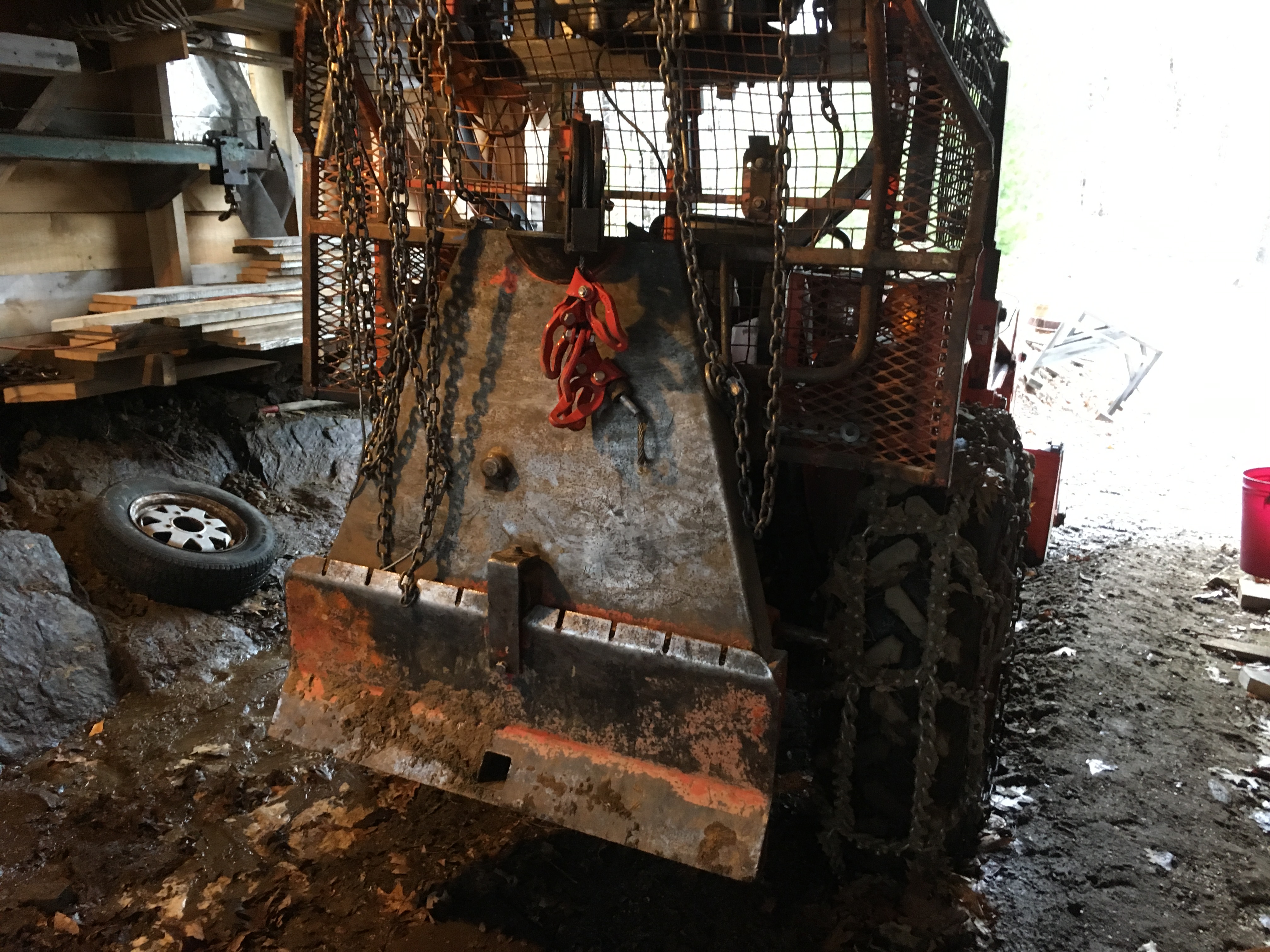

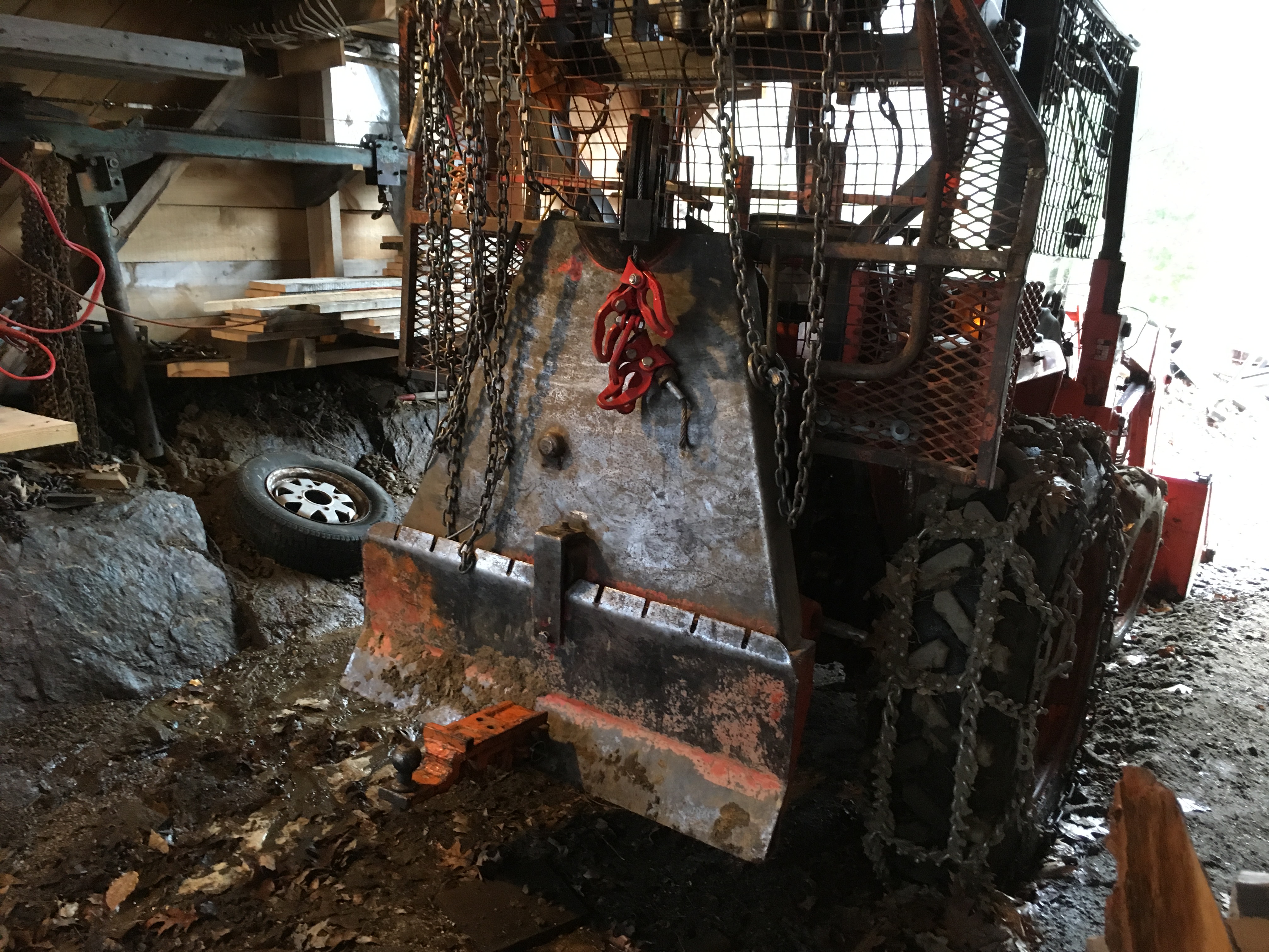

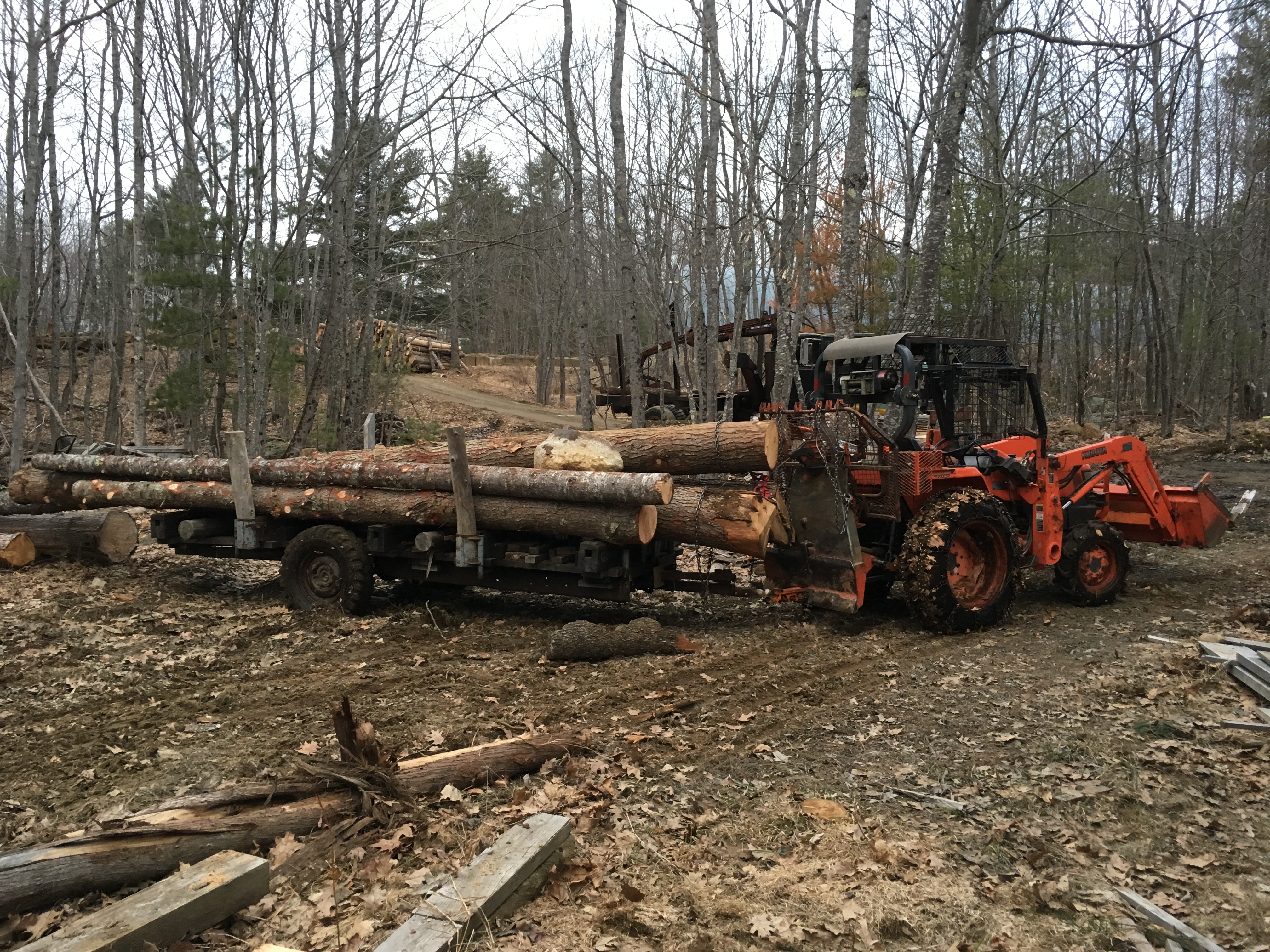

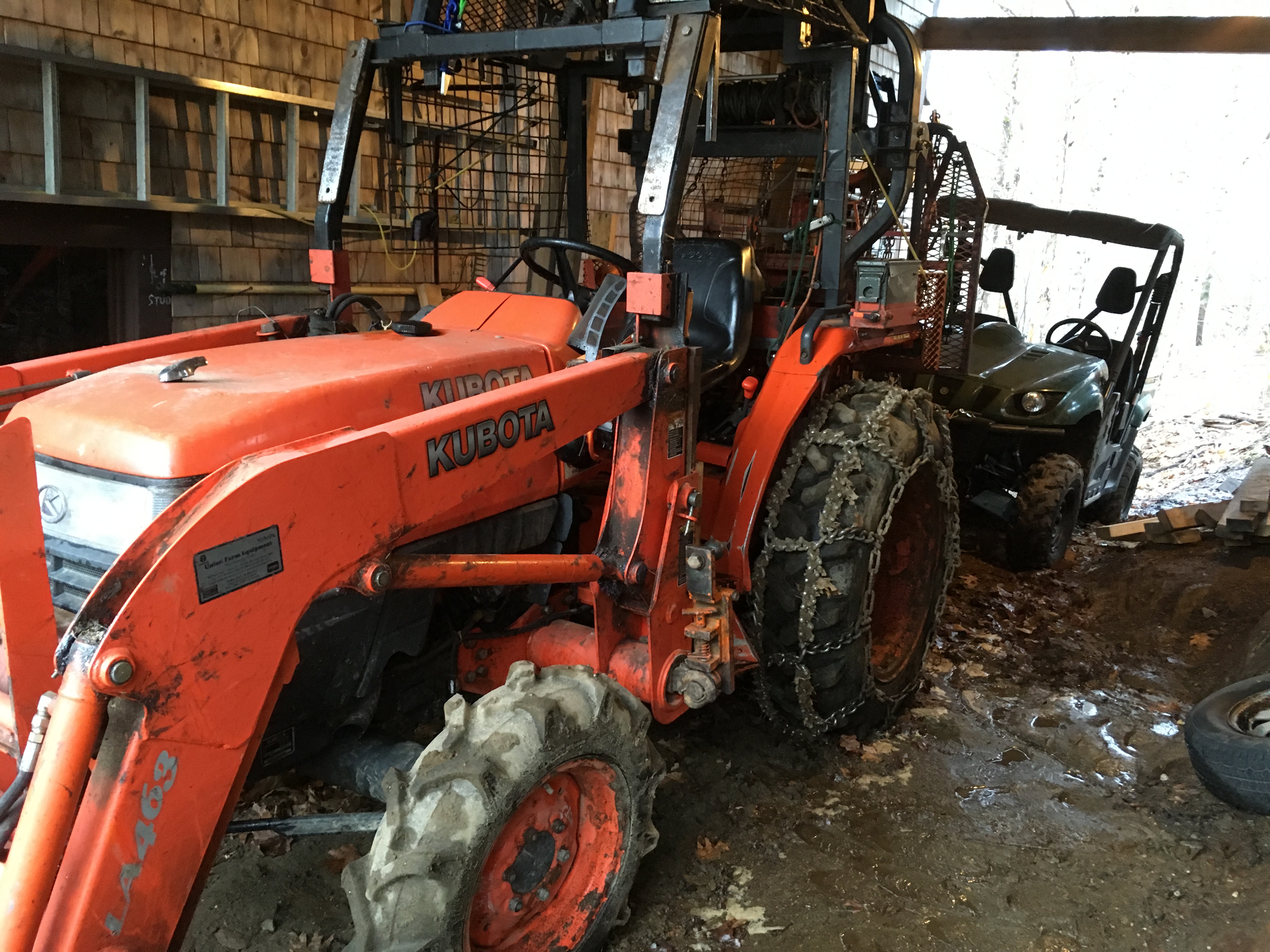

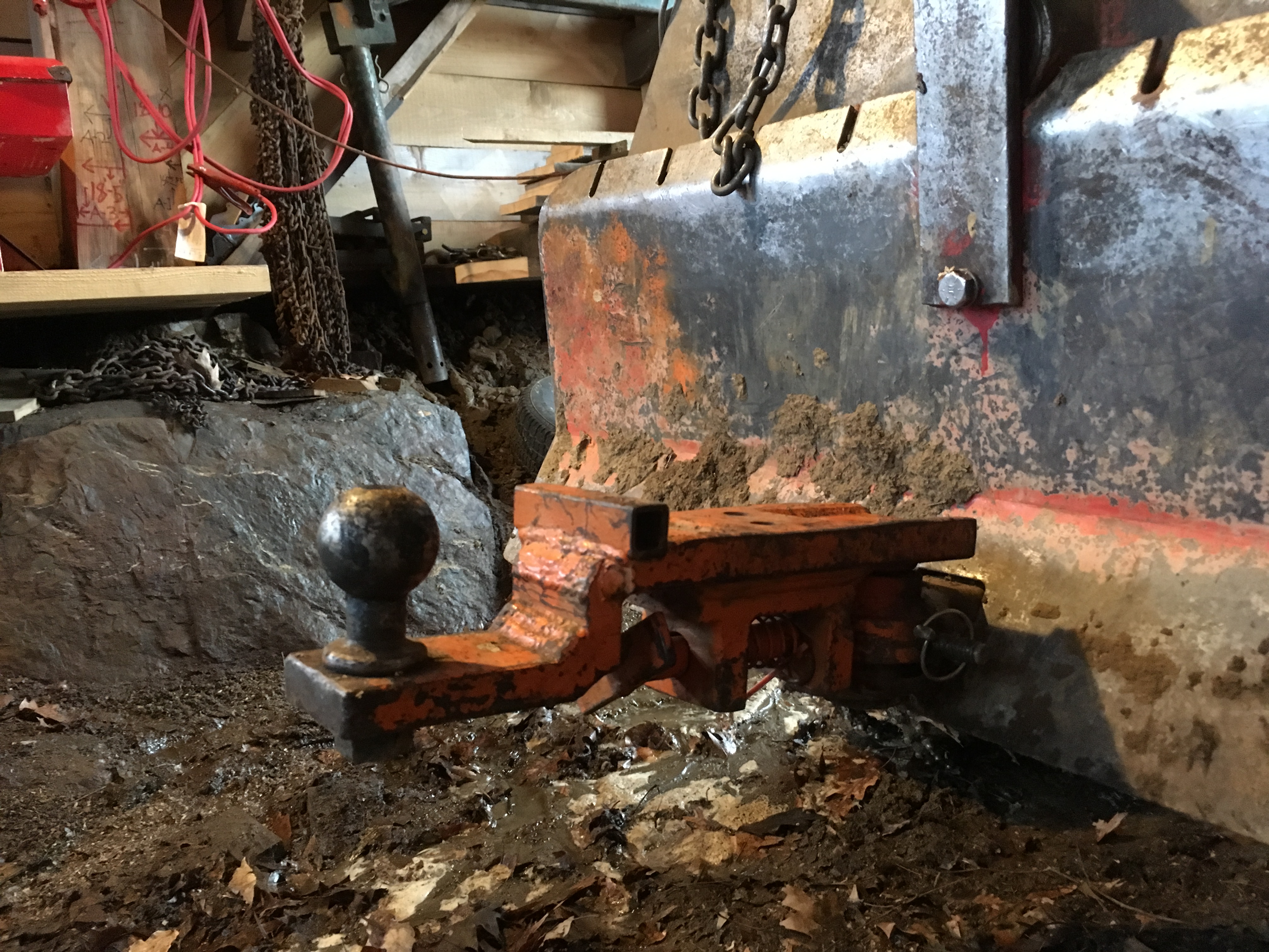

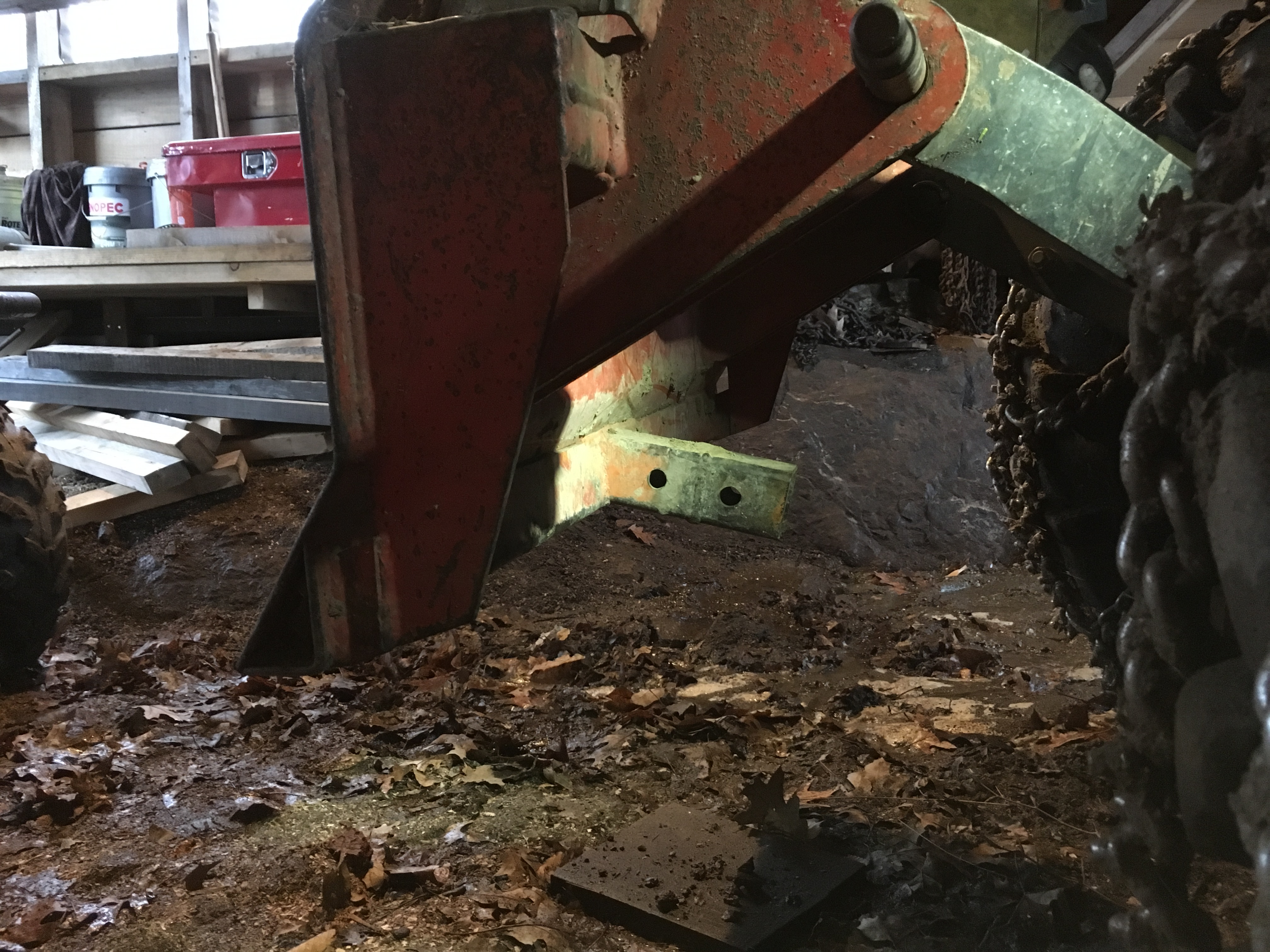

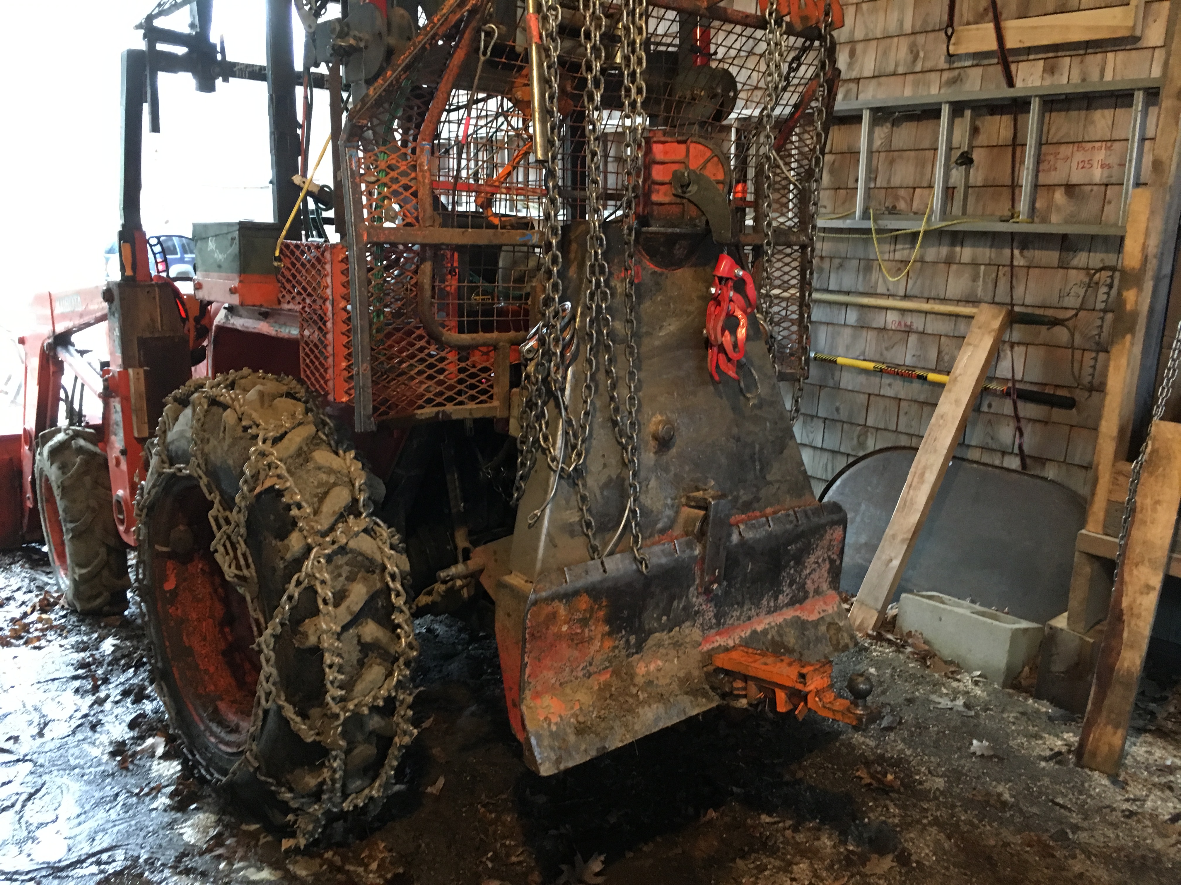

"or are you loading from a pile that you previously skidded to a landing or bunching area"1> Yes from a bunched area in the woods. 2>> yes trailer is unhooked from tractor, I'll try another video link of loading logs>>>> Logging - YouTube 3>>trailer hitch is on the winch when in use, picture time>>>>>>>>>>
IMG-0431.JPG IMG-0433.JPG IMG-0434.JPG IMG-0435.JPG IMG-0436.JPG IMG-0437.JPG IMG-0438.JPG
Pic 1>>>temp use, 2,3,4>>trailer hitch ready for hook up use with extra 1/2" case harden bolt to keep the hitch from swinging, 5>>>hitch not in use and stowed behind front tire on loader mount, 6&7>>>2" receiver welded in the winch.
