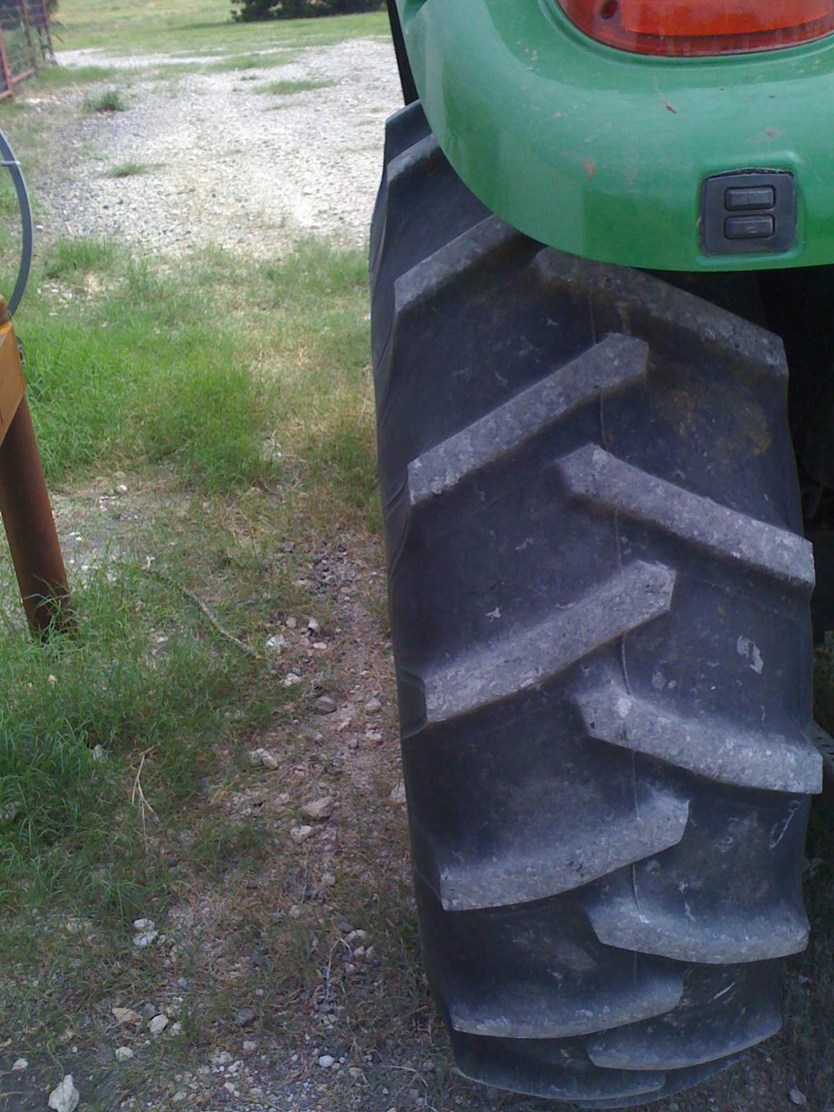

If you put two weights per side then definately go with R1 tires. R4s' and a fel wont get much traction. Much of my work is in customers yards so I have R4s' on both of my tractors but agree that for field work the R1s' are better. For your information I measured the weights on my 4520 and they stick out 4 3/8 " each wheel.
Steve

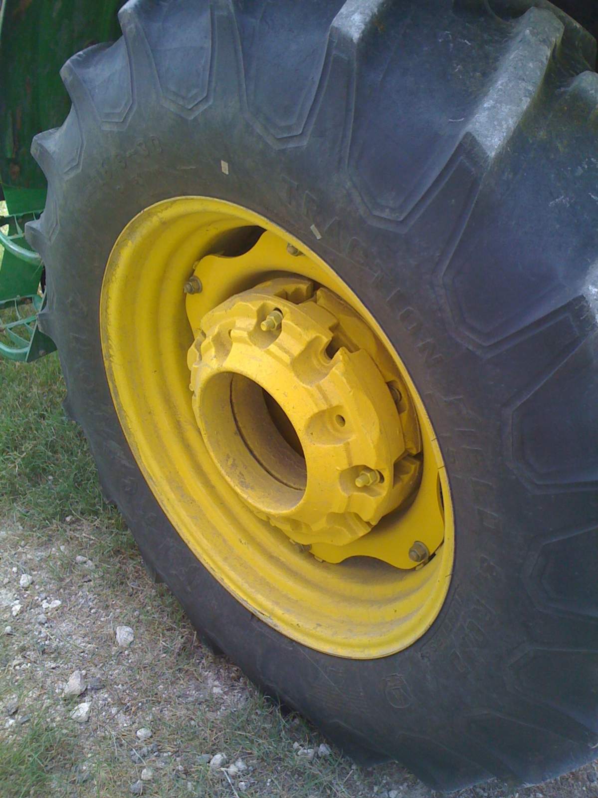

Here are pics of 2 weights per wheel on my 5525.
D.

Thanks for the pics. I did order a cabbed 4520. I decided to go with 2 weights per wheel. 3 seems excessive and stick out too far. I have attachments if needed for more counterweight. Many times I just need some counterweight and don't want to add a attachment for a breif FEL job.

That will be a nice setup and I hope the R1s' work out for you. I can tell you this much though with R4s' and 420 lbs of front weight and 660 lbs of rear weight my 4520 cab tractor can still slip easier than I like. When I tie on to my 6' field cultivator is when I have the most slippage.
Steve
I guess if you need more weight, you can always load the tires.
D.
