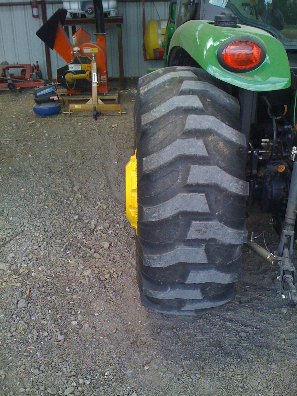

I confirmed I have 2 on each side. I would worry about catching them on things if I had 3.
Do you have anything on the 3 point hitch for ballast?
D.

Here are a couple pics.
D.
   / Trade 3720 for 4520?
#39
D.
If 2 stick out that much, I wouldn't want to go with 3 on each side. I will probably get R1 tires. Your R4 tires are wider. May even stick out farther with R1 tires. Thanks for the pic.
