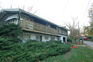

Today I tried to rip out shurbs with my 4110 Jd. rear blade for weight in back. (see photo of shurb). Broke branches but would not left the root ball with fel. Would a 3520 do the job.
Any one chim in if I am dreaming.
Thanks.
Roger.

If the root ball was broke free a 300CX could lift those root balls I would imagine. I would check the 300CX specs to be certain. I have moved a 61" bucket full of dirt and concrete with my 300X. 300CX would only be better.
