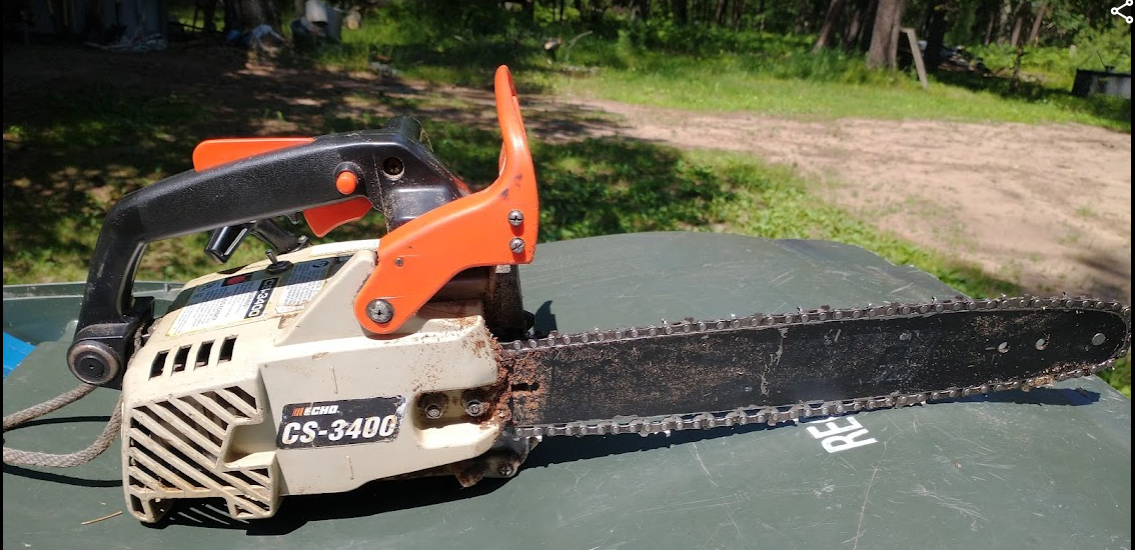

ArlyA, you do love your pole saws. I think they would be great for limbing and cutting anything over waist height. For 6"+ trees across the trail, I think I'd rather use a 50cc pro chainsaw.
That said, you probably get your pole saw in the dirt often enough. What is your sharpening method?
   / trail clearing technique and tools
#207
We do own a regular stihl saw that's there professional version but don't have the capacity to carry it along with its PPG. We are nomally walking in, or use our 6x6 to do them. Since we have limited carrying capacity, we bring tools with us we can get the most work done. Having said that, we rarely need a 18" bar.
I hand file chains in the field but bring at least 3 chains along on most days.

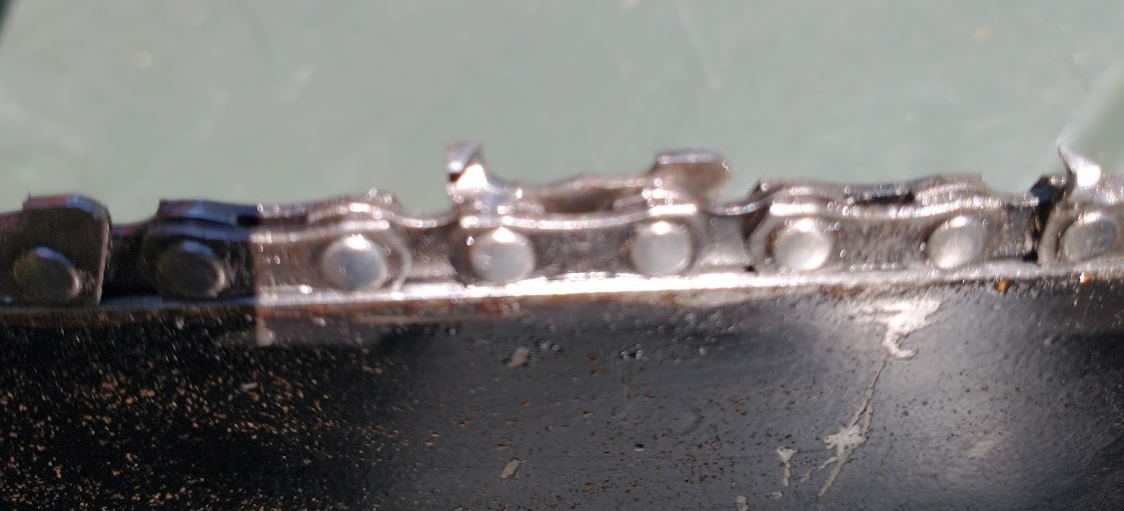

I can sharpen a chain in about 5 minutes, on the saw, in the field, and bring it back to as good as or better than new.
This stihl brand sharpening tool is awesome. I don't spend near the money on chains.
I periodically give each tooth 2 cuts to maintain it, 4 or 5 passes will resharpen a dull chain.
Here is a pro showing it on Youtube:
Amazon
   / trail clearing technique and tools #210
Can you see well enough to match the angle? Does it seem to get the rakers just about right?
