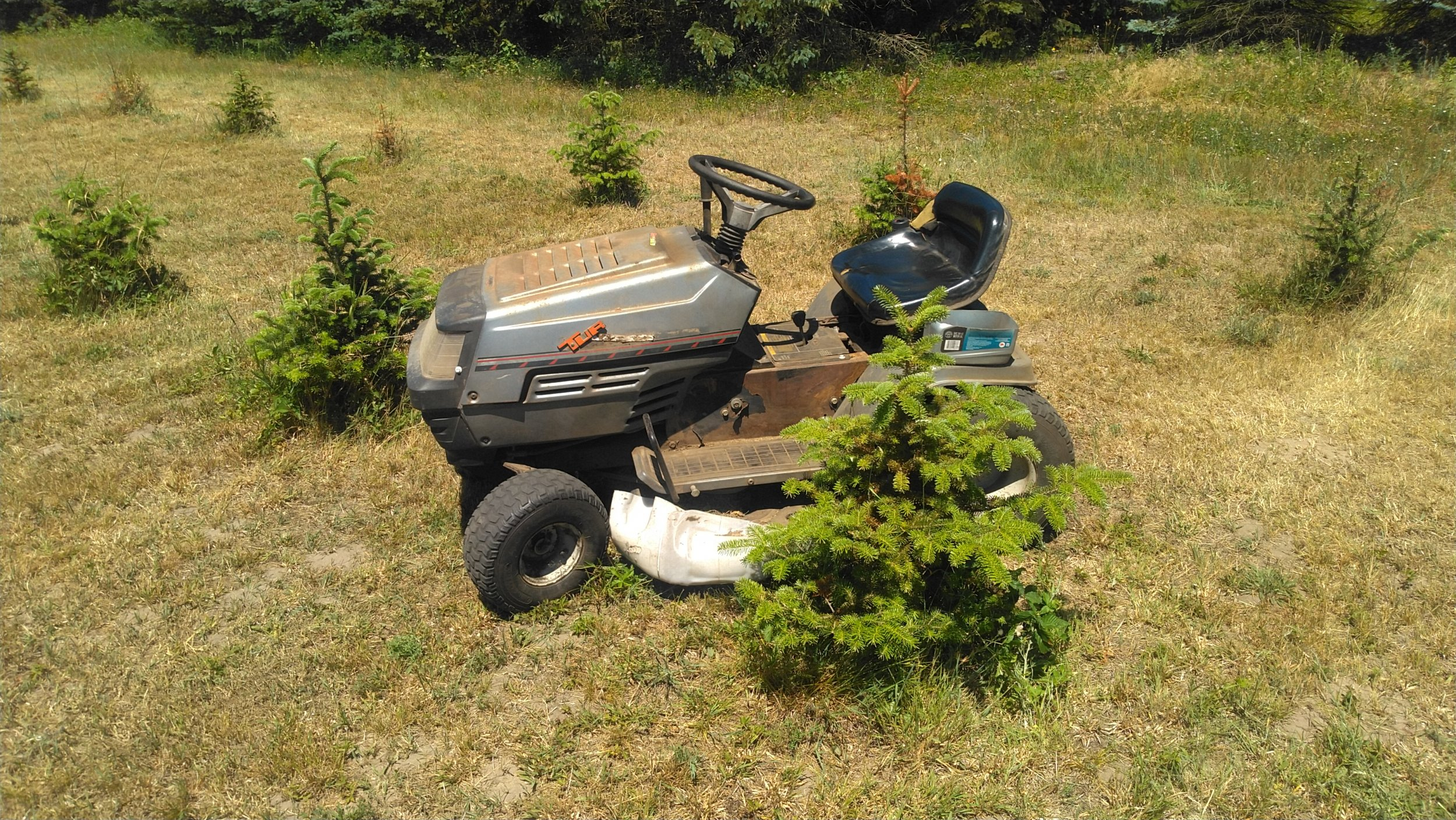

My main tool for new Xmas tree rows/ trails. Yooper engineered $100 35 yr old MTD had for 10 yrs now, no safety features or brakes anymore have to bypass the solenoid to start and ground the coil to shut off, only ever had to replace the mandrels. Plastics mounted on deck to prevent tree trunk damage, because I mow very close on new small trees. Definitely not high tech, cutting edge, or sophisticated like most but it works great for my small operation. I also use a 5' Bush hog and L4150 for the bigger trees and trails. Try and cut once a month or so on new trees few times a year on older tree trails.

I used to have a 15hp MTD much like that. My friend caught trail fever for his Gator, but didn't really know what to do about it. So we cut some trails through his woods and cut the stumps "flush" with the ground. I followed up with my MTD rider and cut all the brush. He couldn't believe how well it worked. I said, "you'd be amazed what you can do when you abuse the heck out of equipment".
I always wanted to make a Rough Cut Rider, by giving it a 3" lift. Front axel lift is easy - rear axel lift is harder. Never found one that would be easy to do.

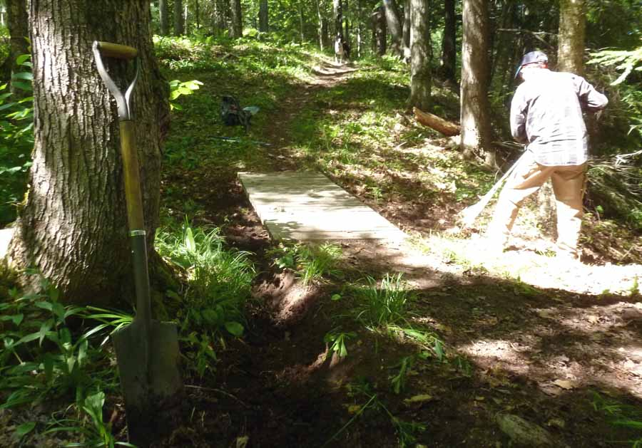

Out working on trails over the weekend raising this bridge, and adding dirt ramps. I little saw work as well.
Here is 4" raisers placed under both ends, bridge 6x6's were toe screw to them, then rocks added to keep dirt in.
Filled with creek gravel, then dirt on top.

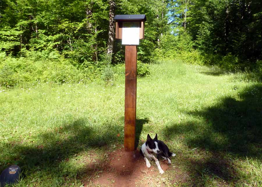

Out on our trails today and here is a snippet of what was done. New map holder was put up, bridge approaches cleared and a dead-fall removed. Will post more later.

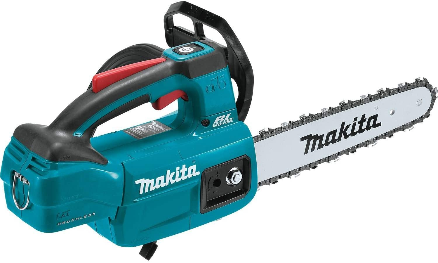

In my day job, I've been clearing out brush in the yard of a closed for a few years business and having qeif getting to all the 1 to 3" new growth. I just got a battery mini saw to assist.
Makita XCU06Z 18V LXT® Lithium-Ion Brushless Cordless 10" Top Handle Chain Saw, Tool Only

Why do they make you use that Makita?
Stihl has a battery powered top handle saw: STIHL MSA 161 T 12 Battery-Powered Top Handle Chainsaw w/ 12" Bar (Battery & Charger Not Included)
I bought it, not my employer. I wanted it small and not use a special chain sold by the manufacturer. The smallest Stihl had there special chain on it. I didn't look at MSA 161 because I didn't consider that large of bar saw.
I have a pole saw by stihl which I do love but I don't like its micro sized chain on it that only they sale and I'm working to have it switched out..
Makita XCU06Z 18V LXT® Lithium-Ion Brushless Cordless 10" Top Handle Chain Saw, Tool Only View attachment 753776
I will of course do a review of this mini-saw after i can put it through some paces. Its not suppose to show up until mid next week. My extra chains for it have arrived.

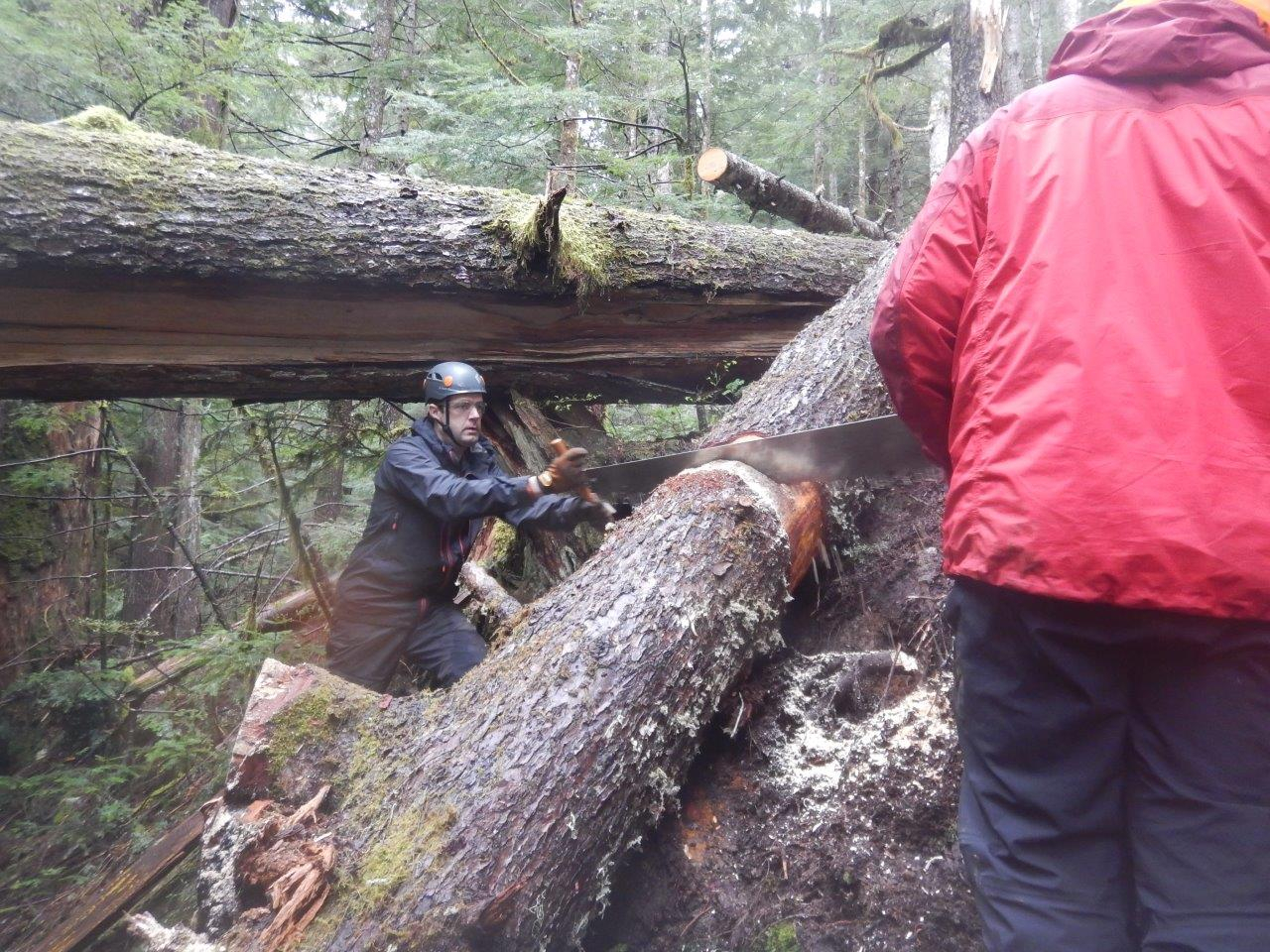

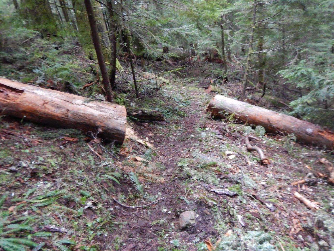

I did a trail maintenance day in the Washington Cascades a few years back. The location was in a wilderness area and you are not allowed to bring in anything with a motor, or wheels. We hiked in a few miles with misery whips, wedges and axes and cleared some large windfall. It was very interesting work. One trick they used was to wrap large logs with webbing multiple times, and then pull the webbing to roll very large logs off the trail.
One tip I learned was, to keep your saw sharp, remove the bark in the area you plan to cut. Over the years dirt and sand embed in the bark which will dull your saw very quickly. There was also a lot of time spent sitting and observing before taking action. Basically look at the lay of the land, the weight of the trees, and predict what will roll, twist or fall (and in which direction). Once these things start to move, things can go pear shaped quickly. Lots of latent energy waiting to be released!
