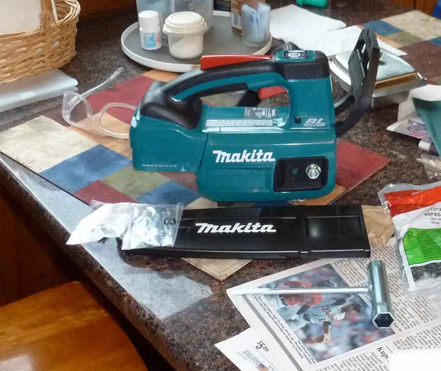

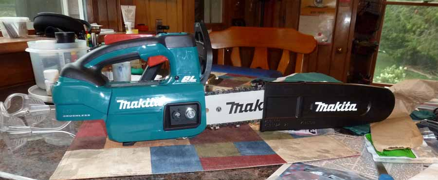

Assembled this Makita XCU06Z 18V 10" top handle saw when I got home from work and really like how this unit is set up. Its about 90% same as a regular saw, just lighter and smaller. Has stainless shields under the cover to protect it from the chain and steel teeth to grab into wood. Oil tank has a sight glass (really plastic) and cap like most saws do. Chain tension again, like most saws do with a flat screw through the cover.
   / trail clearing technique and tools #422
It looks like the design and balance are good. From watching videos, I'm wondering if it's going to be a little short on power (limited by the 18v battery?). Apparently it is supposed to be equivalent to a 22cc gas gas chainsaw. I'm hoping that there will be a next generation of cordless saws that do a better power/weight ratio.
That said, I think you will find that Makita handy for your trail work.

Assembled this Makita XCU06Z 18V 10" top handle saw when I got home from work and really like how this unit is set up. Its about 90% same as a regular saw, just lighter and smaller. Has stainless shields under the cover to protect it from the chain and steel teeth to grab into wood. Oil tank has a sight glass (really plastic) and cap like most saws do. Chain tension again, like most saws do with a flat screw through the cover. View attachment 755010View attachment 755011
The Makita only has one nut to hold down the cover for the bar. Let us know if this loosens up.

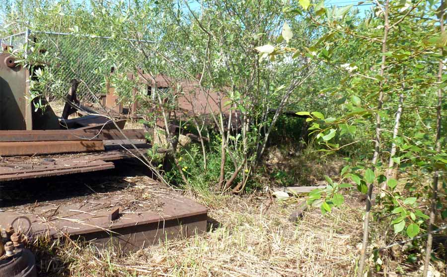

I am very impressed with with the Makita, except for its short duty cycle.
After this many cuts, the "I'm warm and shutting down" light comes on. So I got the loppers to fill my time.
Nonetheless, I found if I let its motor run fast and at low stress, it will run longer. This is the crap, I need to clear out. Steel I hit! May have touched it 4 times today and Mr file comes out.
Why do I want to use a small, low power saw here? This tree grew in a notch in some 1" plate,

What the heck is that area you are cutting? What will happen to all the heavy metal? Sounds like you need a bag full of batteries.

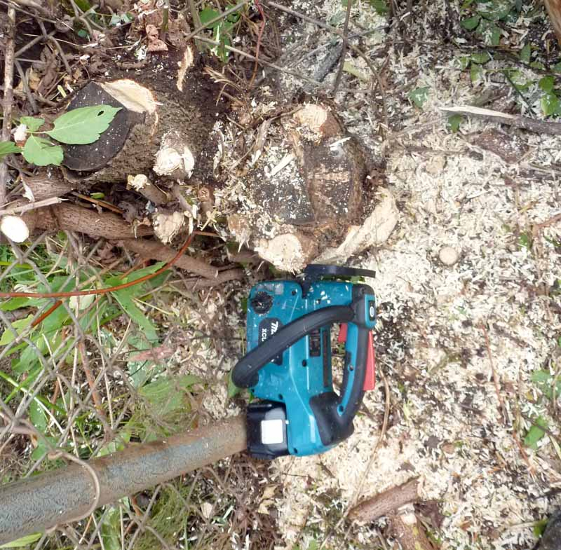

I'm really liking this silly little saw. Here is the conditions I'm working in. The stump is not being removed, just cut off.

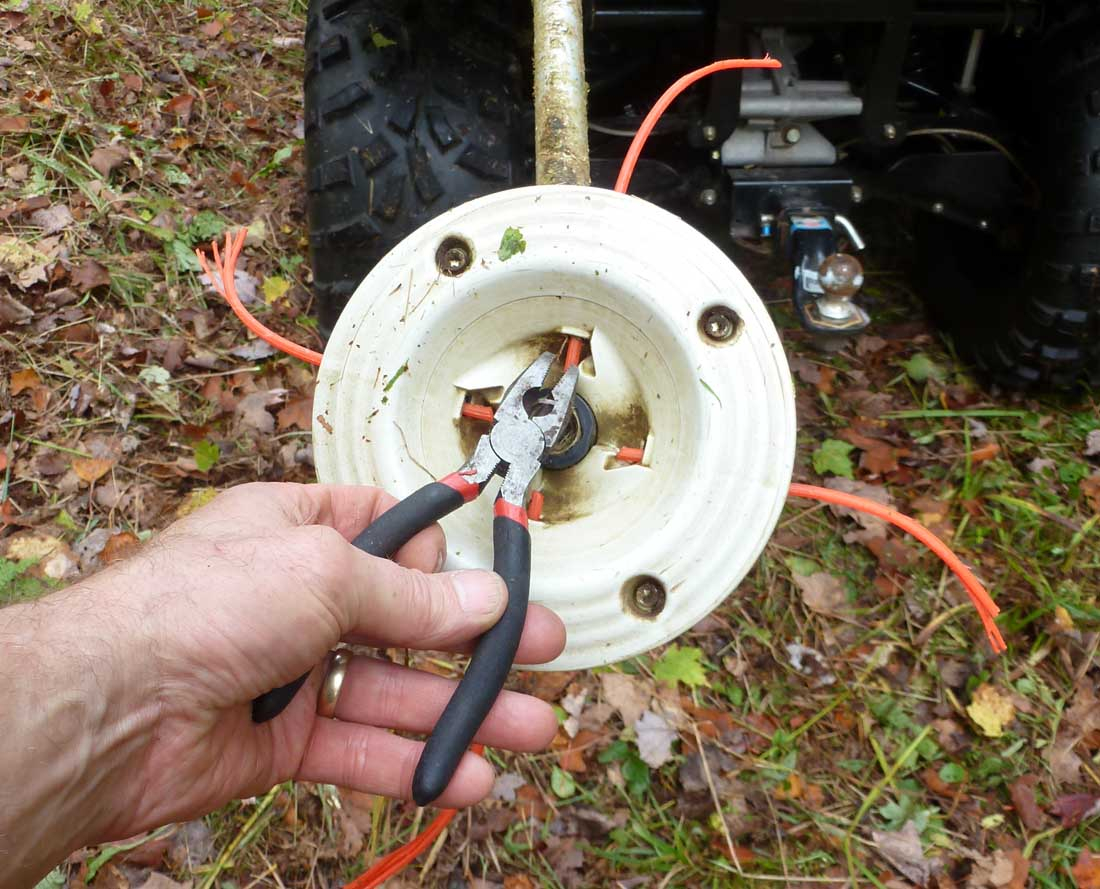

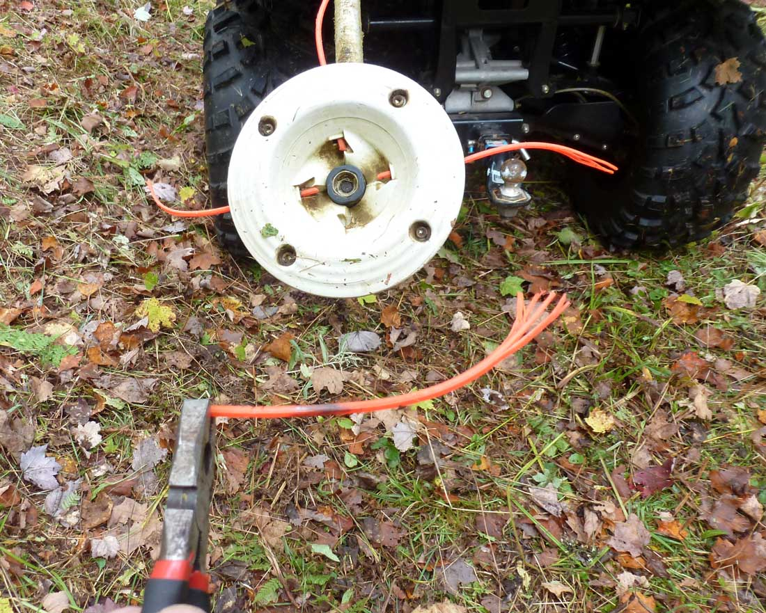

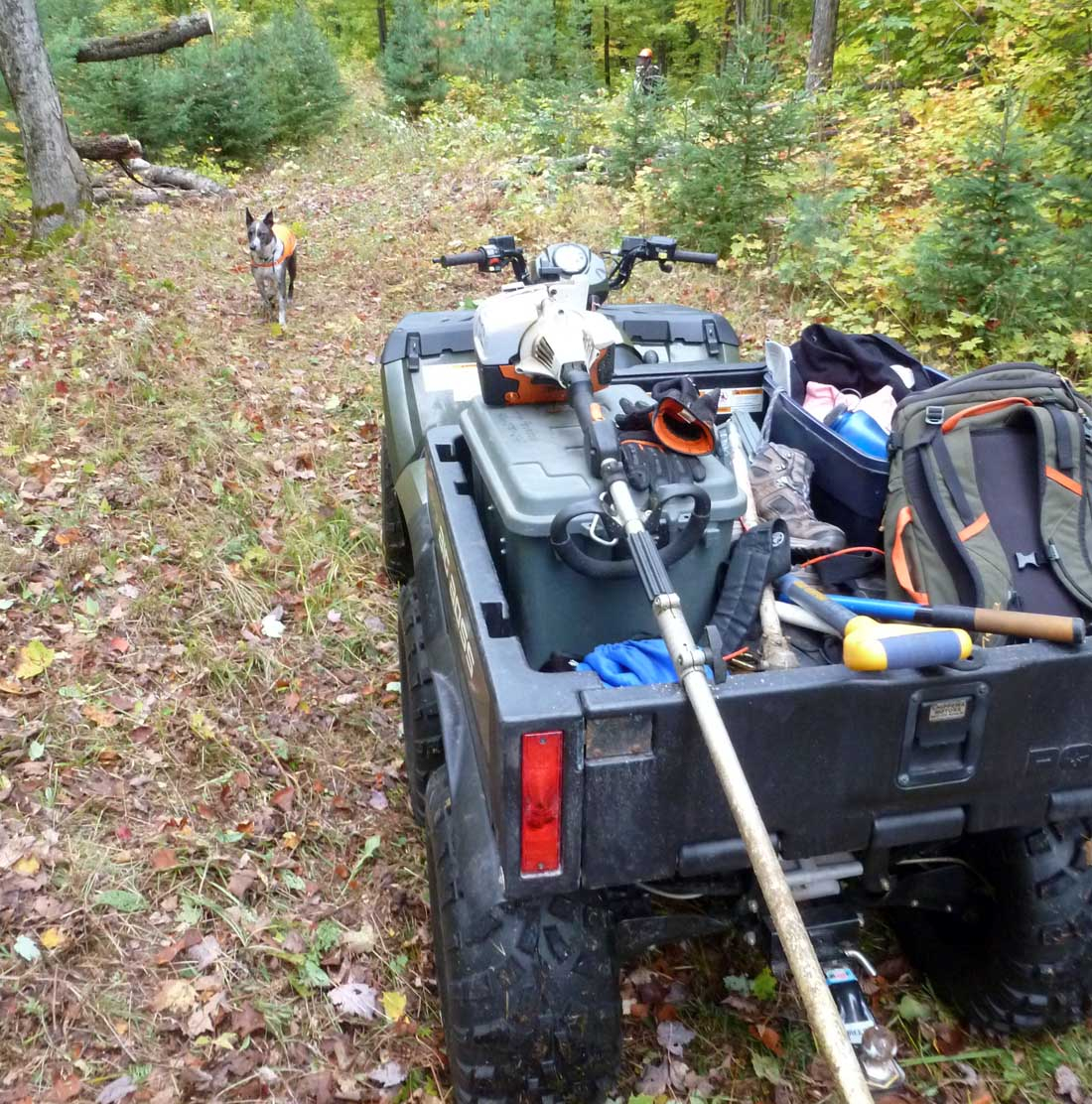

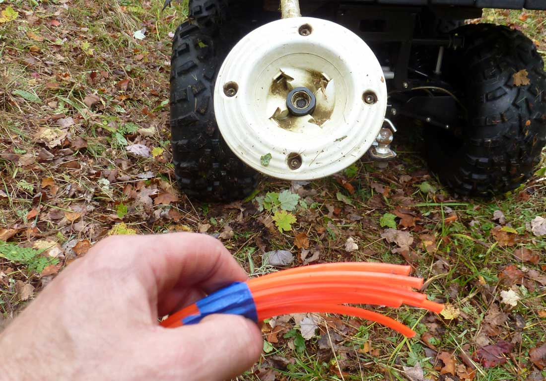

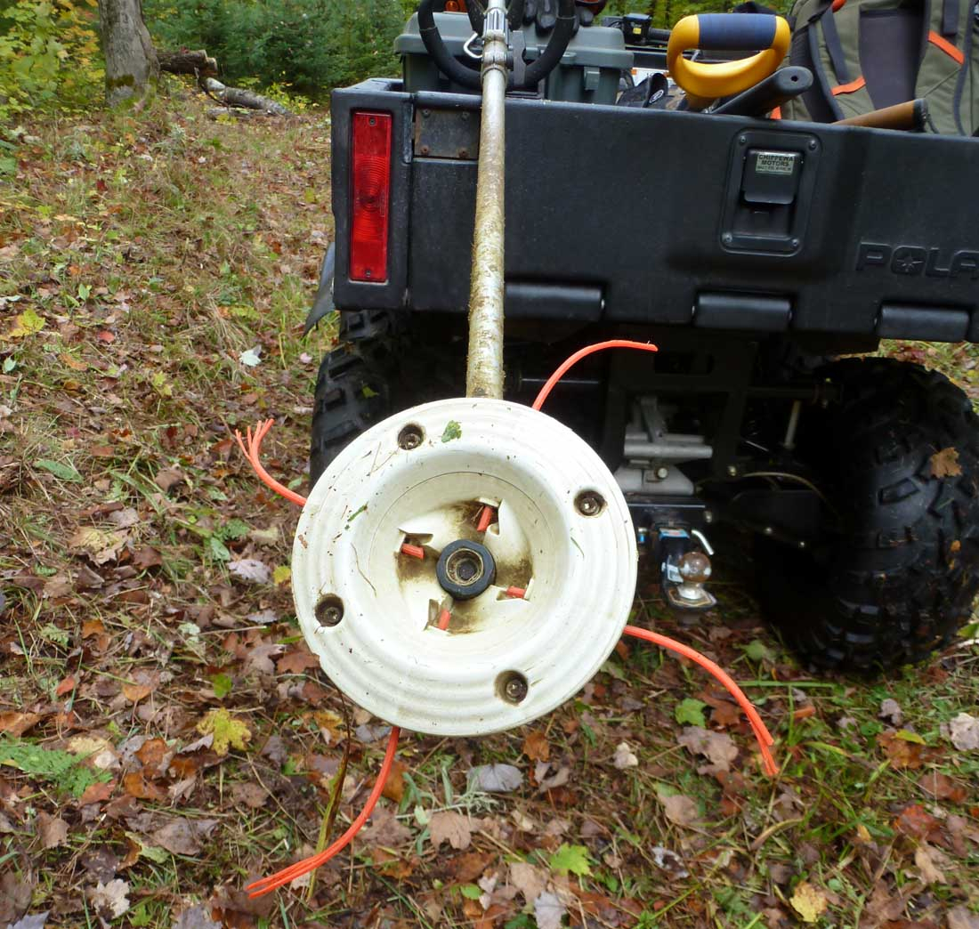

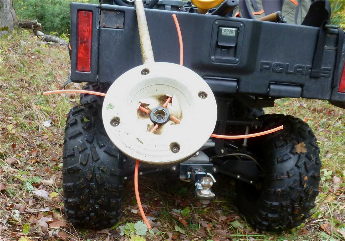

Was running my spool of .155 string out so I picked up another and this time got some Oregon made or sold stuff.
Had some old orange string left over so i could test them side by side. Not much difference but the new green stuff does look longer, in fact after using various strings for 20 some years, just not much difference in it.
This is how the back of a truck looks when clearing brush.. 😁 Big lineman pliers is for cutting string. Ya, we buy it in bulk!
