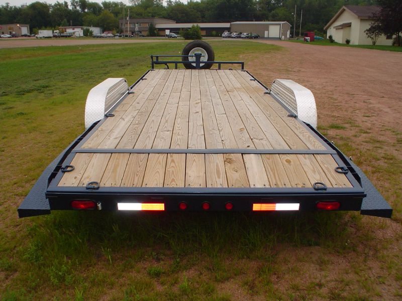

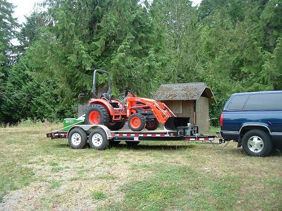

I purchased an 18', dovetail, 10k, bumperpull trailer from PJ Trailers. They have a website and I found this trailer to be perfect for my needs and dang sharp looking. The trailer weighs 2500#s empty and I pull it just fine with my 1/2 ton chevy and its 6500 lb tow rating. My load is about equivalent to what you describe with 4000 lbs of tractor plus one 600 lb implement. You bet, I'm into the 7000+ range but everything works great and is within ratings on each axle and tire, the DOT requirement in WA.
Highly recommend PJ Trailers. I paid 3100$. They make tilt too.
