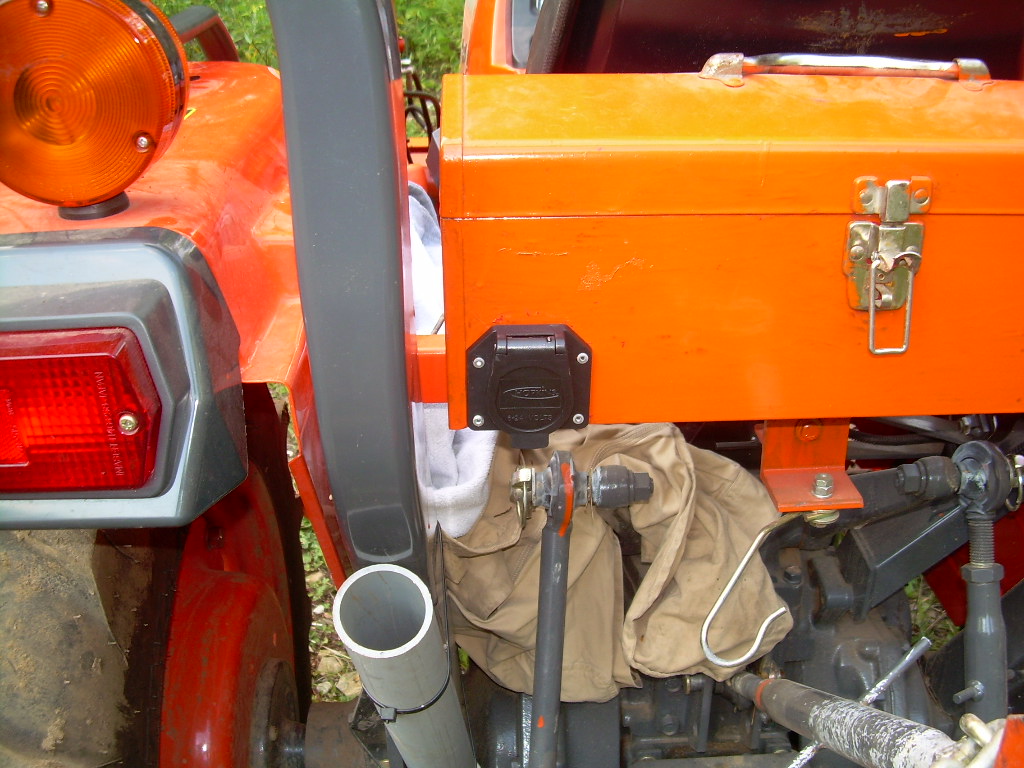

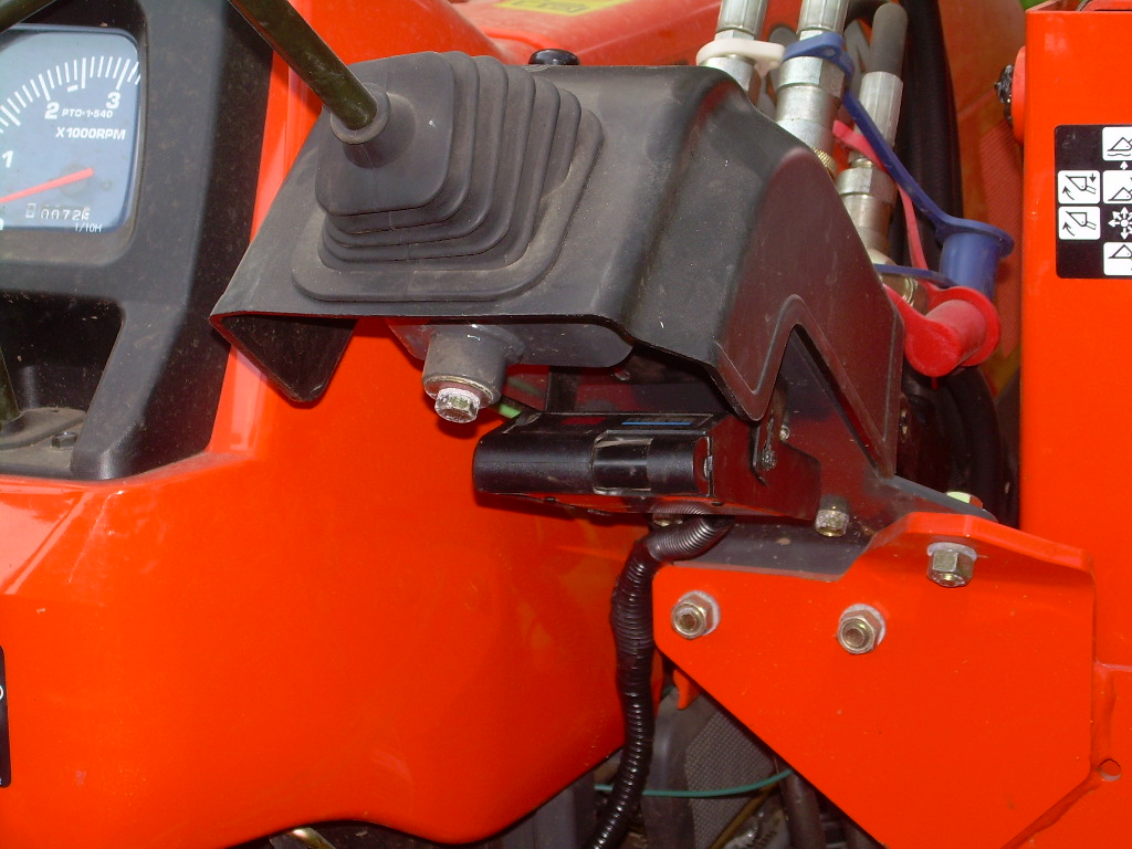

I put brakes on My L3400 in the fall of 2008. Coming down a steep mountain road with a trailer full of wood was not cool. On a couple of occasions, all it would take is a rock under one of the rear wheels for the trailer to push the tractor into a skid, or try to jacknife it.

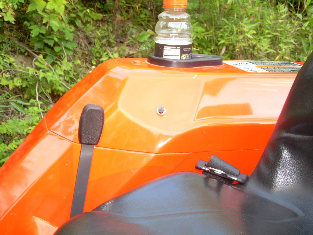

   / Trailer brake controller on a Kubota BX #16
The last picture is a momentary push button that I use to activate the controller. I thought about using a switch activated by the brake pedals, but I didn't want it left on when I use the parking brake.
