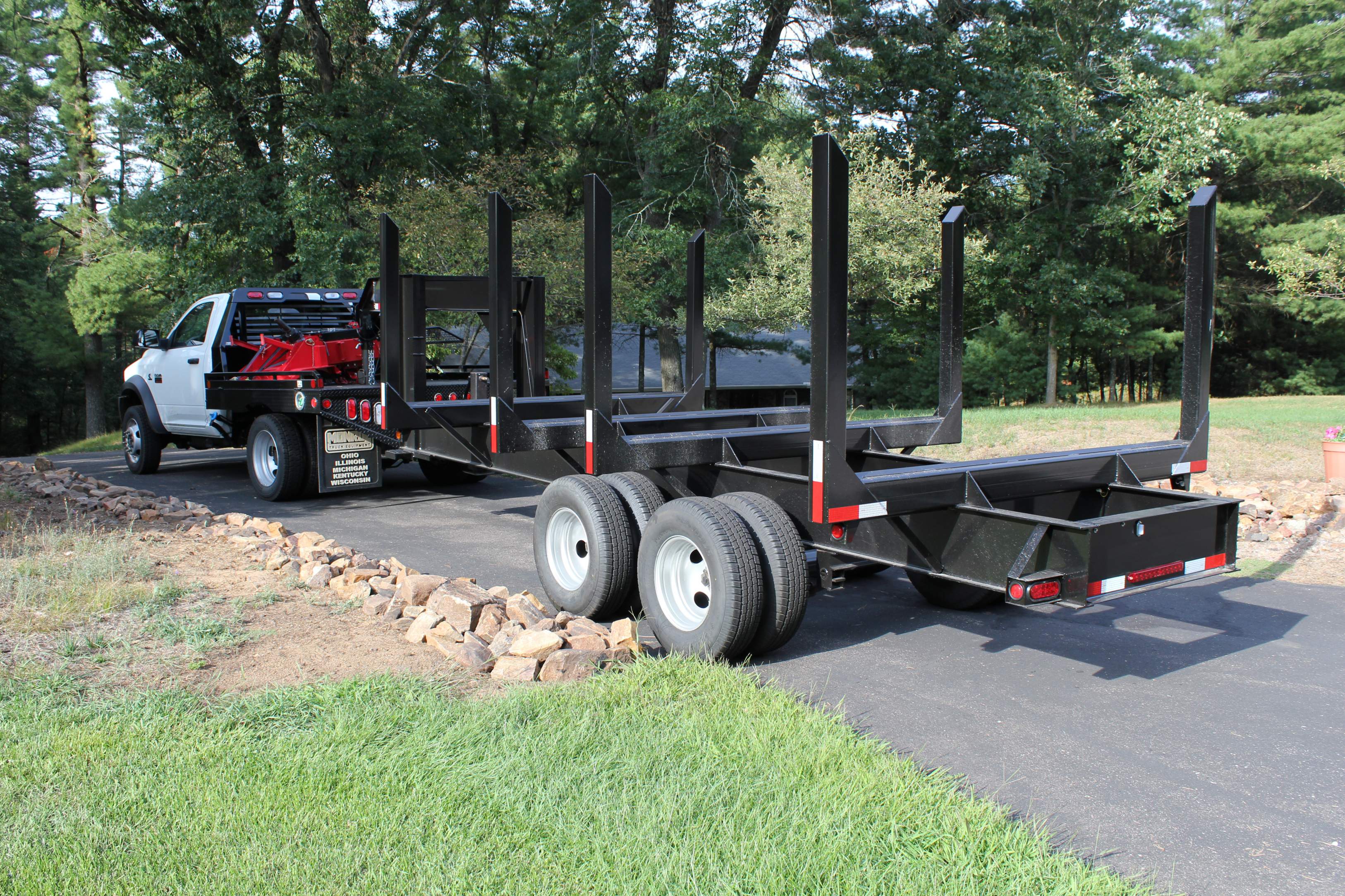

Finally was able to get my new custom log trailer and 4 X 4 Ram Truck (see attachment). Now will add the log loader and I should be set for awhile. Was able to sell my F650 truck and other equipment to move up to this new setup.

In my case, I went back and forth between a 3500 Dodge & Ford F350 as well as the pickup or cab & chassis options. Eventually I landed on getting a Dodge 4500 cab & chassis which has the 4.88 axle, larger rotors & pads, exhaust brake, hydraulic over electric brakes, solid Aisin transmission, larger GVWR payload with 19.5 tires, flatbed, and still have the same 30,000 GCWR. For me the reduction in HP was not an issue as the most important consideration was braking and pulling capacity. When you are pulling consistently over 20,000 lbs in hilly terrain stopping for me those heavy loads is more important than saving a few miles per gallon. So far as been very impressed with the 4500 RAM and this is coming from someone who had been driving a larger F650 for many years.
   / Trailer capacity on F450,F550,F650 #30
Nothing wrong with the Dodge, but the F-450 and 550 chassis cabs also have the 19.5 wheels and larger brakes and rotors. Not sure what you mean by hydraulic/electric brakes unless you're talking about the trailer. The brake controller on the Fords can handle the electric or electric/hydraulic trailer brakes. You do have a nice looking rig, should serve you well.
