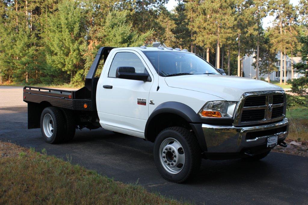

Finally was able to get my new custom log trailer and 4 X 4 Ram Truck (see attachment).
Good choice, think you're going to be happy with it. Fine looking bed you picked for it too. Are the side rails hinged to fold down?

Attached is a better picture of the truck. The flatbed only weighs 1300 lbs so overall I believe I am under 9,500 lbs but will have to put it on the scales shortly to see what it weighs. For brakes the truck has hydraulic over electric brakes for added boost. Not 100% sure how that works but so far I have been impressed with the braking and especially the Jake Brake. I even wonder how I survived with my older F650 for so long without having an exhaust brake. I know Ford has this option as well and almost bought the F450 but for the capabilities of this truck along with the price I selected the 4500 Dodge. It is the first Dodge truck I have owned as prior to this every truck I bought was a Ford and my daily truck is still an F250.
As far as the log trailer I still need to mount my log loader/grapple to the front,but the big test will be how it will handle 20,000 lbs of payload downhill?. The logs bunks are fixed and cannot be removed.
Nice truck!
Our F550 had little trouble going down with 24K pushing it. Rockies, Northern Ontario, Northern Quebec... no problem. The underpinnings on your Dodge would be very similar.
