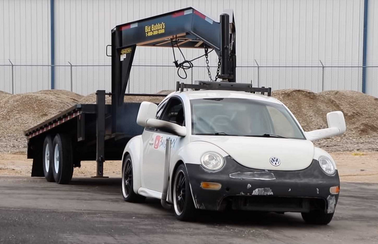

/ Trailer capacity #50
Even if the wheels shine like that? That should count for something. :thumbsup:
Well, all my trucks and trailers have steel wheels. I’m sure the shiny ones boost fuel efficiency and hauling capacity.
