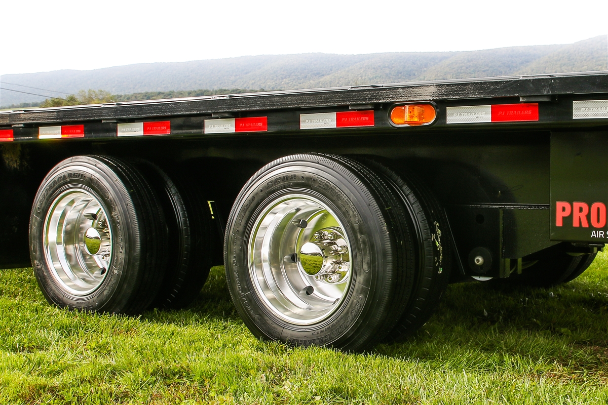

My last trailer was rated over 18,000 payload by the manufacturer. Should it be limited to hauling 14.5k? If I load 17,000 on the trailer and drive across a scale with each axel carrying 9500 and the truck is rated for the 3500 pounds it’s carrying is anything over loaded? The trailer weighs 5500 with double 10k axels and the 4 tires on the axel are rated for more than 10k in duel configuration.

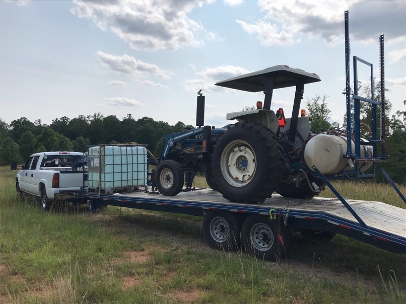

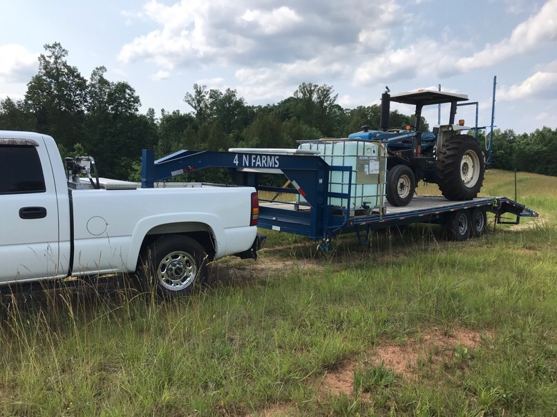

I was probably a tad heavy on tongue weight the other day with 275 gallons of water sitting there. But the 100 gallons on the back countered some of it, didn’t it? :laughing:
/ Trailer capacity #37
A tad heavy is better than not enough. Aside from swaying just moving hitch light trailers off road runs short on traction.

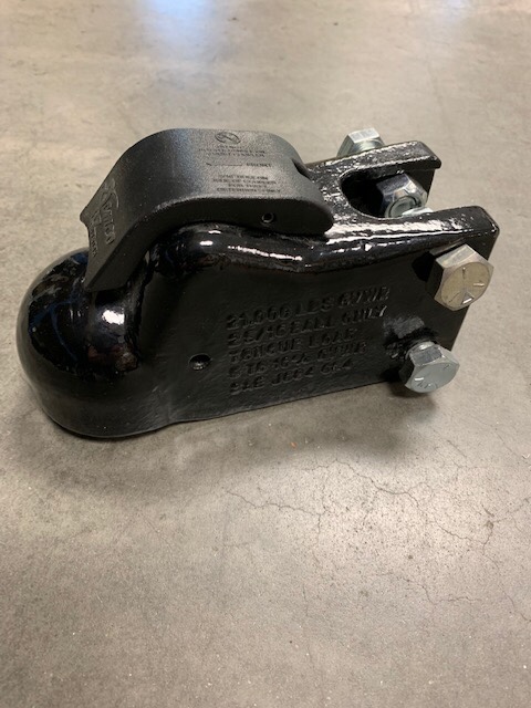

Case in point is I just purchased a new PJ F8 deckover with 14k rating. BUT since the vehicle carries some of the load the trailer is actually can actually be rated at just over 16k. I had to go with a HD coupler to get the higher rating but now I’m legal to carry that much weight on the trailer. I won’t ever have that much of a load but good to know I have extra capacity. My max weight will be right at 14k.
/ Trailer capacity #40
Converse of that was the 2004 Load Trail 7K Car hauler style trailer that I bought brand spanking new with a 5K coupler on it. I never got quite mad enough to cut it off but I was not impressed.
