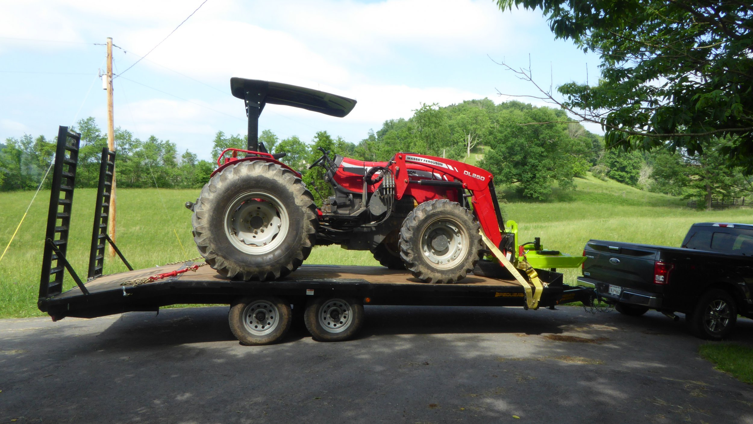

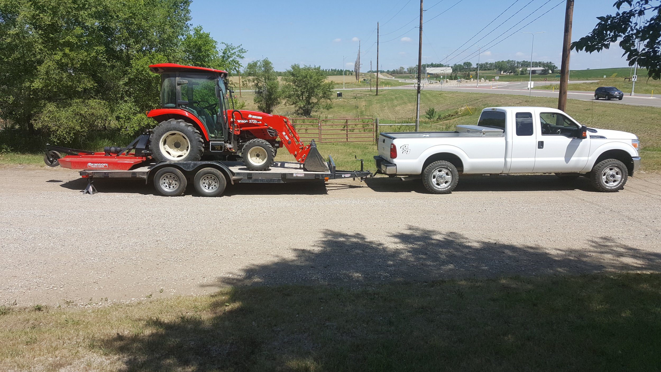

I have a 2012 super duty 6.2 gas with 3.73 gears. I purchased this truck to move my tractor which is a new Holland work master 70 with FEL. It looks like all I can pull is 12,500 with my truck. I can’t find anything that says I can pull more with a gooseneck than bumper pull. A gooseneck is going run a good 1,000 lbs more than a bumper pull.
if I purchase a 20’ deck over bumper pull trailer most of my weight will be up on front of trailer when I load my tractor and bush hog up. The bush hog actually will hang off trailer by three feet. So tractor has to go on first.
If I purchase a gooseneck than I more than likely will exceed my towing capacity of truck. Most 20’ goosenecks are 4800 lbs. looks like I either need to get a bigger truck or smaller tractor. No way I can afford an aluminum gooseneck.
My tractor weighs 5050lbs, the fel weighs 1600 lbs and bushhog weighs 1556. That’s 8206lbs and leaves me roughly 4300 for a trailer. Hard to find a gooseneck 20’ at 4300lbs.
Am I missing something here.
The answer is always "it depends." How often will you be towing? How far? Are you towing in mountains or a lot of hilly situations? Is your F-250 a 4WD ? All those matter.
But let me pass on my own experience and then comment on where I think you are with this:
My MF2660 is roughly 1000lb heavier than your NH workmaster 70. I have loaded tires. I would guess the loaders are very much the same weight or close enough. My bucket is a very heavy 4-in-1 which weighs 1000lbs. I use a 7 ft Bush Hog brand hog which weighs 1460 lbs. I towed this 80 some miles each way in some serious mountains in WV (missing only the bucket) using my 2000 F-250 V-10 and Pequea 1018 trailer. The trailer weighs a hair under 3000lbs. No problems whatsoever. I have also towed the MF2660 and loader & bucket (without the hog) 330 miles on interstates including some long steep pulls but using a heavier trailer (approx. 1000lb heavier than the Pequea.) No problems. Your 6.5L V8 has enough torque and HP (not much different than my V-10.) The truth is the 3.5L turbocharged V6 has a few more HP than my V-10 had and equal torque figures... which is strange but true.
I have also towed the MF2660 minus the bucket and minus the hog (for 25 miles each way just to get to/from a Laneshark dealer,) on the same Pequea 1018 trailer returning with the 600lb or so Laneshark on the FEL using an F-150 3.5L Ecoboost. I do NOT recommend towing this sort of load with the F-150 other than short distances at slow speeds -- mainly due to weight of the truck being 1500 lbs lighter than my old F-250 V-10. The weight of the towing vehicle matters a LOT in terms of stability, steering and stopping. A 4WD truck will have heavier springs in back and tolerate more tongue weight better than a 2WD.

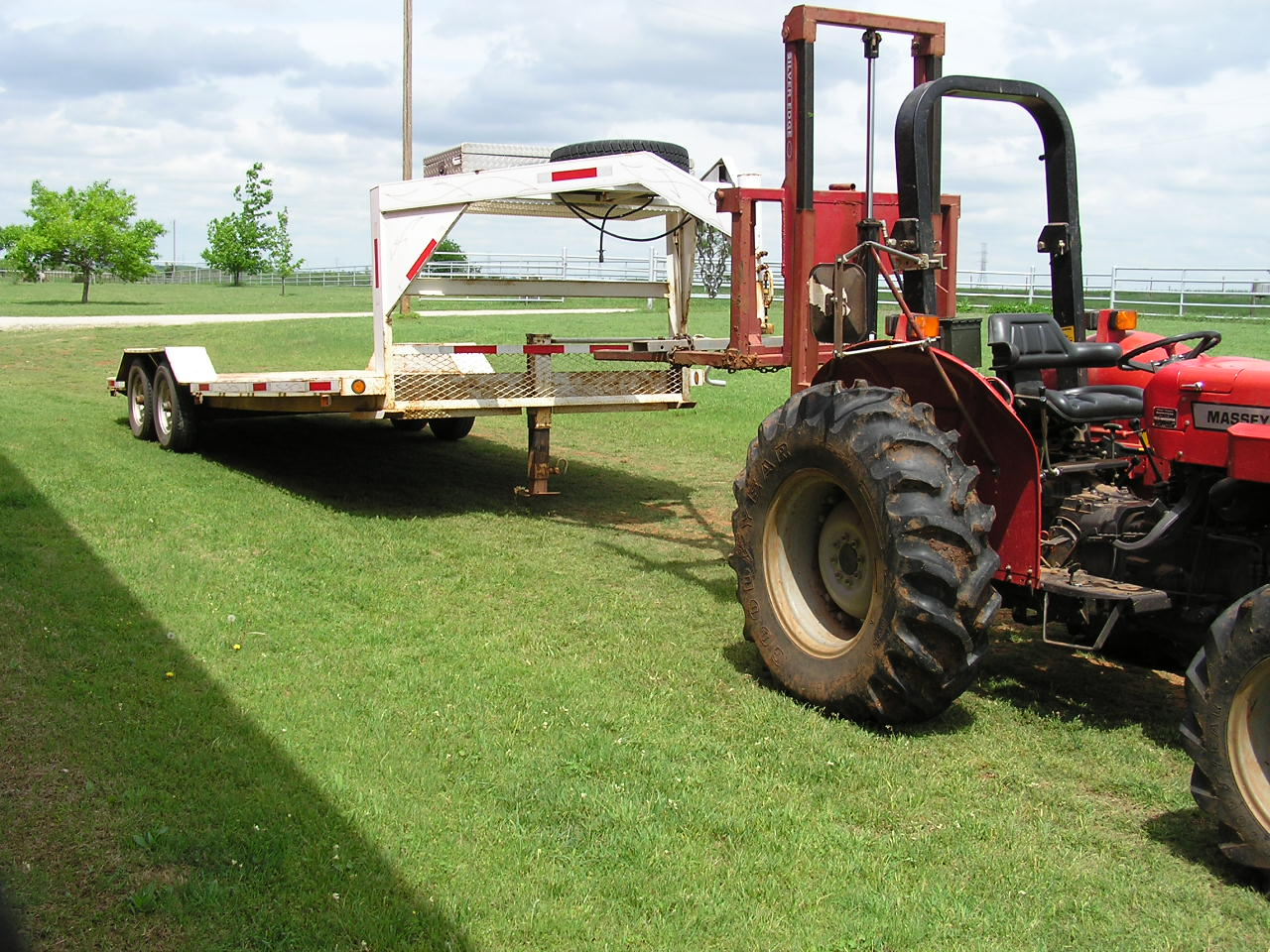

To heck with the towing capacity ratings of these various trucks. Your F-250 is plenty strong to do your towing with everything your describe. Both my old 2000 F-250 stick and my 2015 F-150 automatic towed the loads mentioned easily/well power-wise. Power is NOT the issue. Weight of the truck is an issue (you have good and plenty.) The heavier the truck the more stable towing.
I don't think the tractor necessarily has to go on first. Best is to cut and try and see what fits best for you. I do not think you can beat the Pequea trailers for quality and strength at a reasonable price. Mine is a 1018 deck-over. Pequea sells a longer 20ft deck-over which I recommend highly. There are many good brands of course.
There is nothing wrong with you using a "bumper pull" (really receiver hitch pull) trailer but there is no question that a 5th wheel design trailer is FAR better in avoiding fishtailing and sway as well as distributing the load better amongst your truck's 4 wheels. If you plan to do a LOT of towing with this entire load (and can give up normal bed space in the truck) then go to the 5th wheel trailer and don't worry over the weight. Otherwise, just use a good solid deckover with about a 20ft deck on it.
